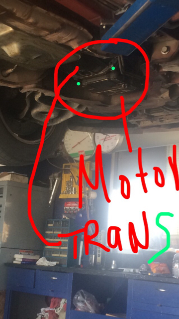

How can I fix this ? It's leaking motor oil between the trans and motor
It could be the rear main seal, the valve covers (gaskets), or from the heads. If that is the rear main seal then you have to drop the trans and replace the seal with a new one. If it is a valve cover or the valve cover gasket then that is an easy fix...just get new gaskets and/or valve covers depending on which is the problem. Hopefully it isn't the head gasket )I doubt it would be). But try to determine where exactly the oil is coming from. Get a mirror and try to see behind the engine from the top...look for oil. And if you can get your hand back there from the top, then try to feel for oil. Hopefully it is something as simple as the valve cover gasket. But if it is the rear mains seal, you should be able to get it replaced within a few hours if you have a lift, trans jack, and power tools...and know how and skill.

On the picture as you can see the two green dots there you can see the transmission connected close to the motor oil pan well ... that's where it's dripping motor oil on the bottom of my engine
