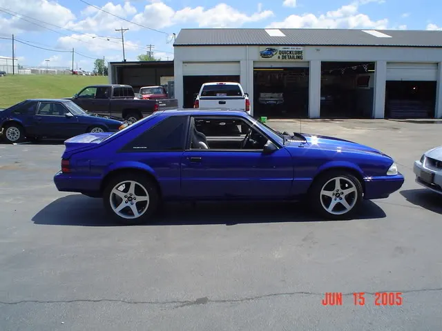

Completed the 5 lug switch!!

I just did a ranger axle/lincoln rotor swap on my 90LX. i paid $80 for axles and $30 for brand new drums. I paid $70 for brand new rotors. The rear end took me about 45 minutes. the front, about an hour. I had to use 5/16" spacers up front for my 03 Cobra wheels to fit.
BERT306 wow that is a beautiful looking ride :hail2:
