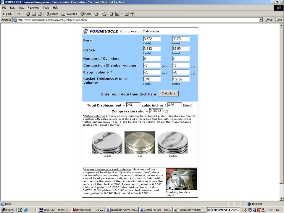

I don't understand why people keep telling me that this set up will net me 8.5:1 compression when this calculator is telling me otherwise. I have stock ported heads from an 02 GT with 43cc combustion chambers, -20cc dished pistons, and am trying to get my compression to 9.1:1-9.3:1. The block is 20 over.
Compressed head gasket thickness is .036in and deck volume is .012. I am using ford OEM MLS gaskets.

Ok, so did I mis-type something into the compression calculator above? Because it is not aggreeing with you. Also, from what I've read PI heads have between 42-44cc chambers that also seems to be unconfirmed. And I have stage 3 heads on my car that still have 42cc combustion chambers, so porting doesnt necessarily mean bigger chambers.

i don't really care if the calc agrees with me or not - look at gear ratios calcs, use three different ones and you'll come out with three different answers.
Use common sense, a stock 99/00 mustang came with 18.10CC piston dishes making around 8.84+:1 compression according to ford's stats. That's with PI heads. Take off .1CC of dish and add .20 of bore and you have just about 9:1 compression. Also every modular engine builder saying manley 18cc's put you at 8.9-9:1 helps too.
