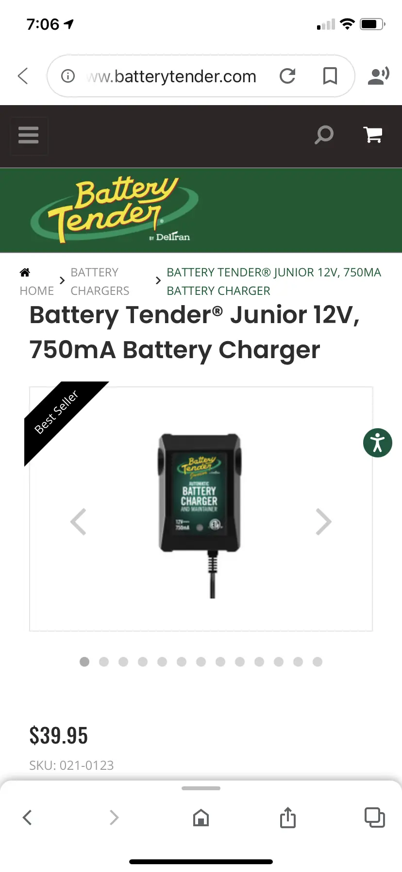

I always use “battery tender” brand. The Junior models. They are great and have safety features built in to avoid over charging, overheating, etc.

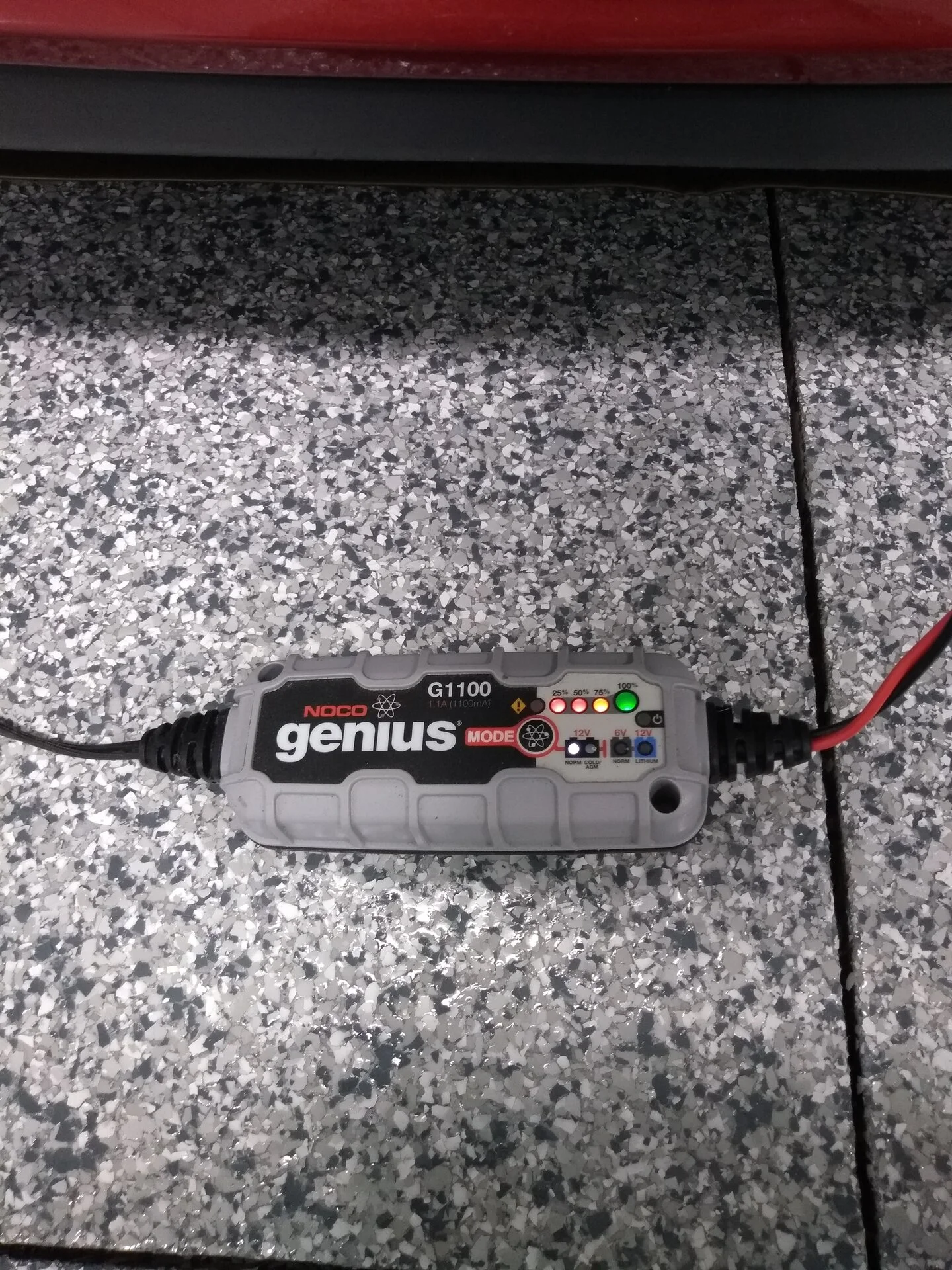

This battery tender I've had for many years for the cobra. I just bought a newer version for the other car.
