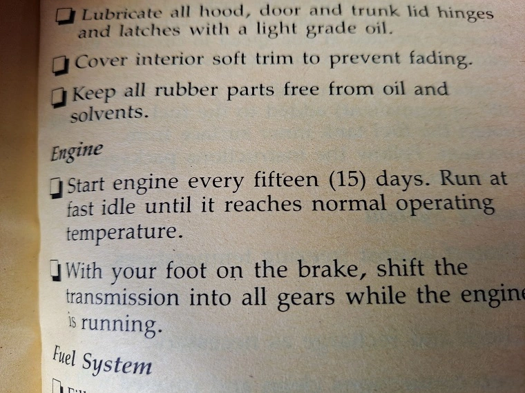

I knew I had read it in the Owners Manual before so l dug it out today and listed under "Storage", it says every 15 days but I just usually do it once a month or so.
I still don't do it. It should be dependent on location. Even getting the car up to operating temperature in a Minnesota winter will NOT remove condensation in the exhaust.

Right everyone does it differently, it can get plenty cold in Ohio for winter too but even the coldest winters still have days that get to the 40s or and occasional 50s so that will be the days l choose to start and run the car for 30 or 40 minutes. I sent an oil sample to Blackstone a couple years ago and they said my car had some of the best numbers of all the 5.0's they have on record and to just keep doing whatever I have been over the past 20+ years with it.
