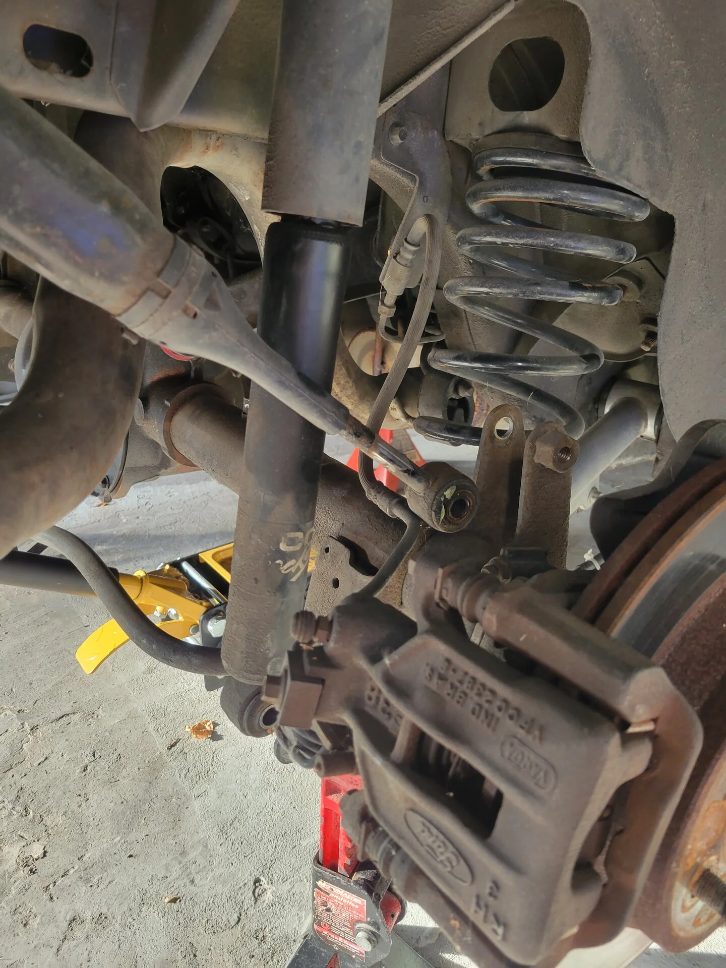

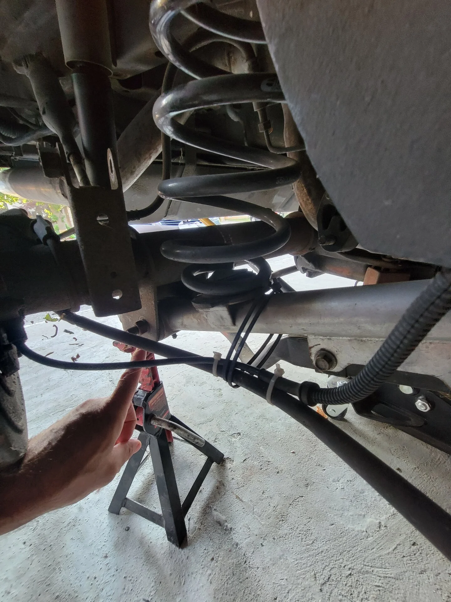

Hi, i've got the car supported on jack stands at the sub frame.
On both Driver and Passenger side, i removed the lower shock bolt, removed the quad shock bolt but the spring doesn't fall out even if i push down on the rotor a bit.
What do you recommend next? The jack and jack stand aren't touching anything in the pic.
I'm guessing the LCA bolt has to be removed, if so any advice before i begin? only the back of the car is jacked up

When this has come up on Fox bodies, (pretty much the same suspension), raising the other wheel has allowed more cross articulation. It’s worth a try before pulling control arm bolts.

I have always supported the car on jack stands on the subframe (like you have) then let the axle hang. I do pull the tires (more access if needed). I undo the shock on the side I am working on (I don't have my quad shock anymore) with jack under the mount. I lower the jack and let droop. Usually a stock spring does not fall out so I use a pry bar to pop the bottom of the spring (not much spring pressure anymore at full droop). Once bottom is out the spring basically falls out.
I do the reverse with the spring going in. Install the upper end of spring in its pocket and use a pry bar or two to pop spring in its lower control seat.
SAFETY NOTE: Remember you are now inducing some stored energy into the spring. Be aware of your "line of fire" with your pry bars. If something slips there could be some kick back. It is not a problem if you are aware and thinking about it. It can just get a little frustrating.

Thanks for the reply, did you remove the sway bar? If not I'm thinking the LCA bushings are holding it up in which case loosening the LCA bolts might help me.
If I remember right I didn't, but it would give some more flex. You would only need to undo one side.
If you loosen the LCA bolts, remember not to fully torque them until the car is back on the ground with the weight on it. Otherwise you can induce a bind that can effect the suspension and how it performs.
