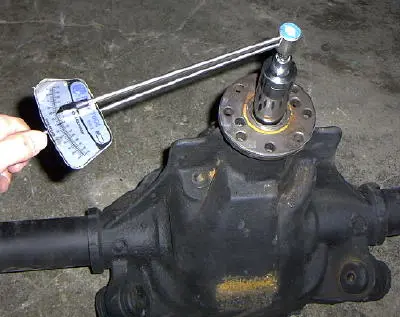

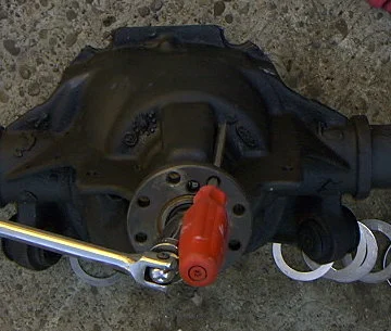

Well, now I am enlightened. I was browsing through stangnet, and I found a link to this write-up on a full rebuild of a 8.8 rear end. Here is a link to the write up.
http://www.angelfire.com/theforce/5ohcpa/cpa5ohtech021.htm
You brace the pinion gear with a screwdriver ran through the pinion yoke. Then turn the pinion nut until the play is removed from the pinion. The crush collar should begin to crush soon.
You then remove the screwdriver, and put the inch-pound torque wrench on the pinion nut, and turn the pinion nut to get a reading. The 15-29 inch-pound rating on the pinion nut is to see how much torque is needed to turn the entire pinion while able to freely spin. Here is the picture.
You then use the breaker bar, brace the pinion w/ the screwdriver, turn the nut 1/8 of a turn. Then, remove the screwdriver, put the tq wrench on the nut, and check the preload. Then keep repeating the process until you reach 16-29 inch-pounds of torque.
So simple! I was so confused. I just didn't know you weren't bracing the yoke when using the torque wrench. That is where I was confused.
Just thought I would share my revelation with everyone.
Scott
