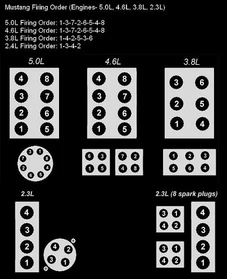

Check that the plug wires are connected to the dizzy cap and to the plugs in the correct order. Remember that the rotor turns counterclockwise and the firing order is 13726548. The cylinders are numbered 1-4 on the passenger side and 5-8 on the driver's side. You might find this picture helpful:
