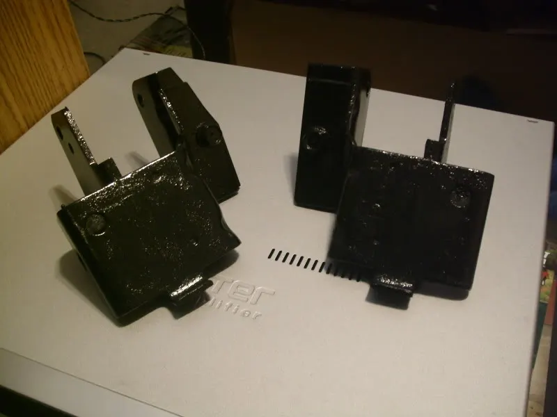

The second piece of the puzzle is metal and it connects the rubber mount to the 3 bolts that you found on the shock tower. They are harder to find original , but they are reproduced.. They do turn up often on ebay and most Mustang type recycling places will know what you need. Here are the factory original parts for a 66':
Reproductions found a CJ pony parts:
You are not limited to using just the 66' motor mounts parts. They use similar mounts that will work through at least 72'. There is something weird about the 67' mounts though so you might want to avoid original ones for that year.

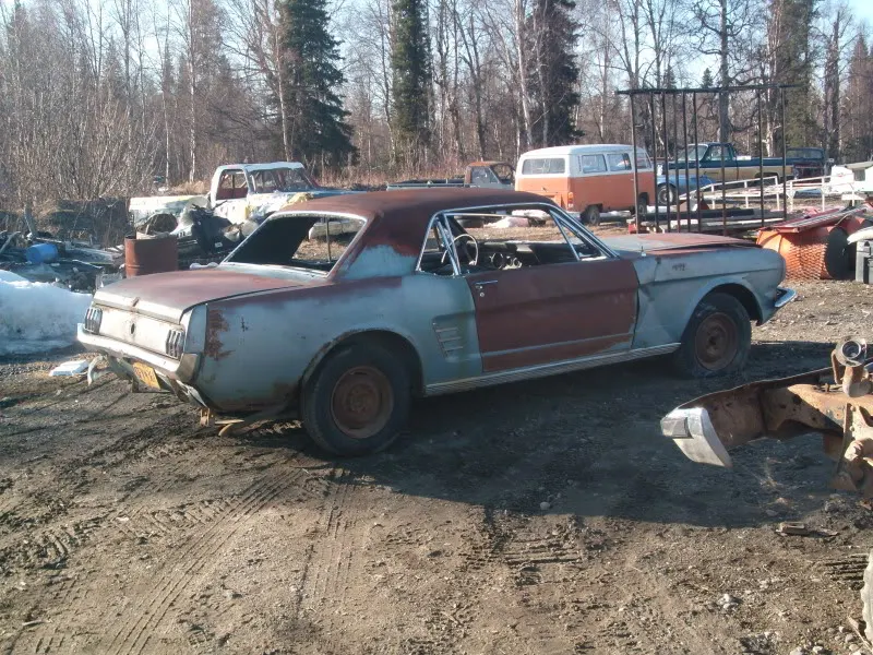

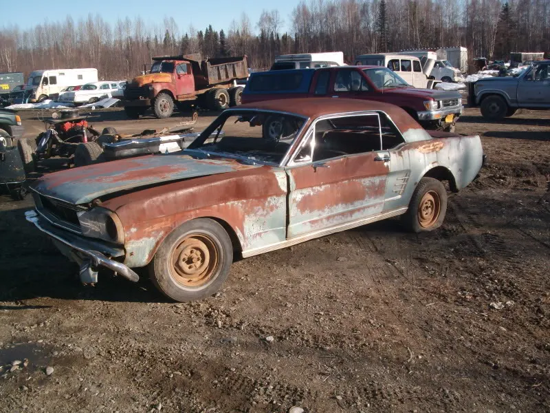

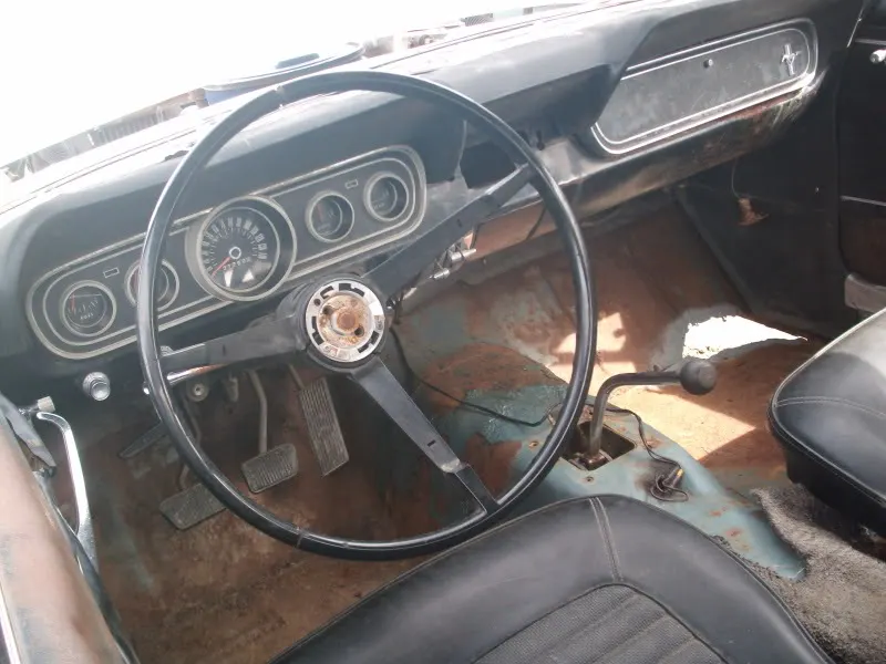

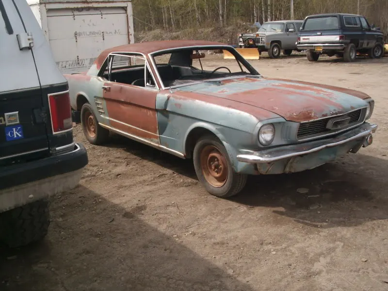

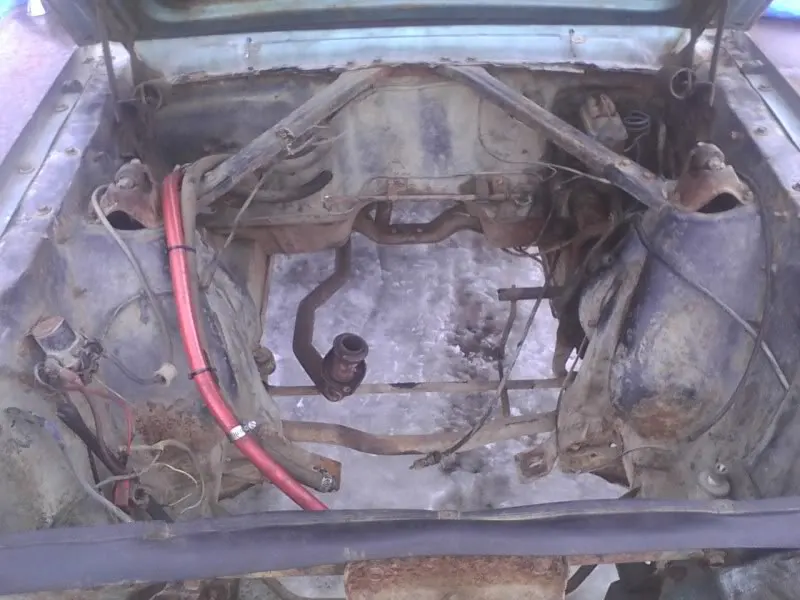

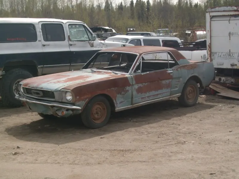

Here's all the pics I have of it, I posted the story behind it in the Welcome Forum. Basicly the plan is to get the chassis in good shape, get everything working, throw some glass in it and drive it!
When I first got it:
After cleaning it up a bit:

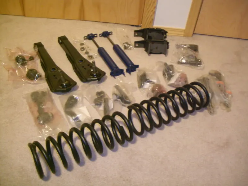

Well, I just got back from Napa ordering all new chassis parts. My wallet sure feels lighter now!
I ordered L+R inner tie rods, L+R outer tie rods, new tie rod adjusters, idler arm, pitman arm, rubber motor mounts, L+R front shocks, new front coil springs, upper ball joints, and new lower control arms with ball joints, all for a '66 Mustang with a 289.
Everything should be in late this week or early next week hopefully. Still need to find a center link, and figure out if the rear shocks are the same on the Mustang and Maverick rear ends.

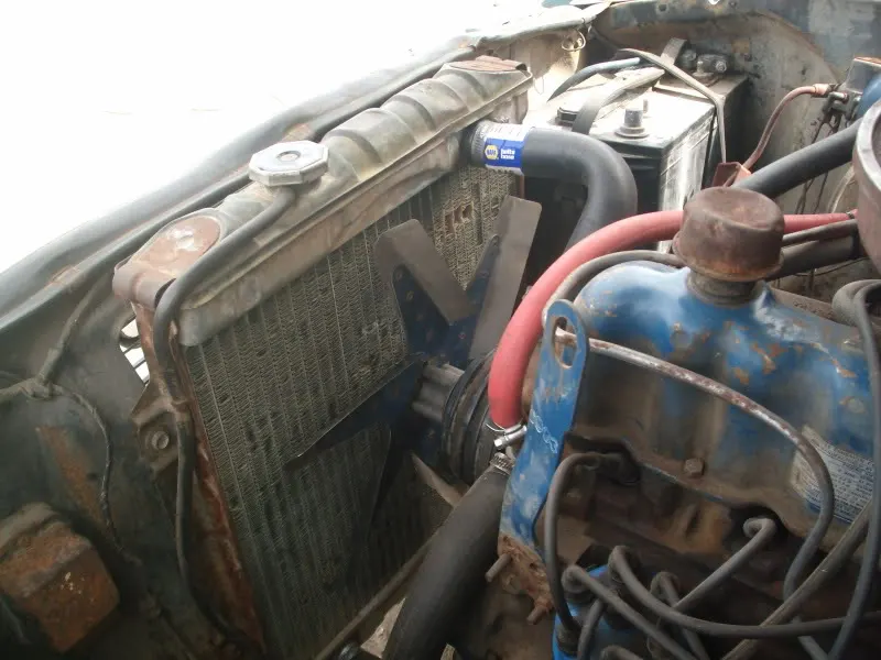

I know sooner or later I'm going to need a radiator for the 302. I've looked around for the conversion radiators with the lower outlet on the driver's side, and the best I've found so far is one from Mustangs Plus for about 200$, here:
Mustang Parts from Mustangs Plus :: Cooling - Radiators & Fans :: 302-351W Conversion
Has anyone used these radiators before, are they good quality? I'm just going to run a stock 5.0 with a clutch fan so I think this will cool it just fine.
