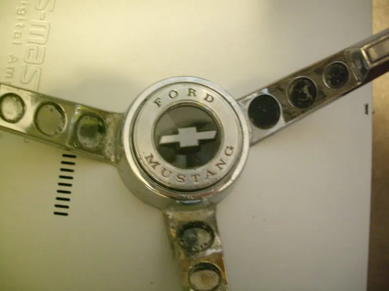

It didnt take long. Why would someone do that? I wouldnt do it even If I had an old hotrod with a cheby engine. Its just wrong.
The glass emblem was broken out and with all the chrome pitting and corrosion, it was junk anyway. Maybe I ought to ditch the 5.0 and drop in a 350/350 combo to match. :nice:

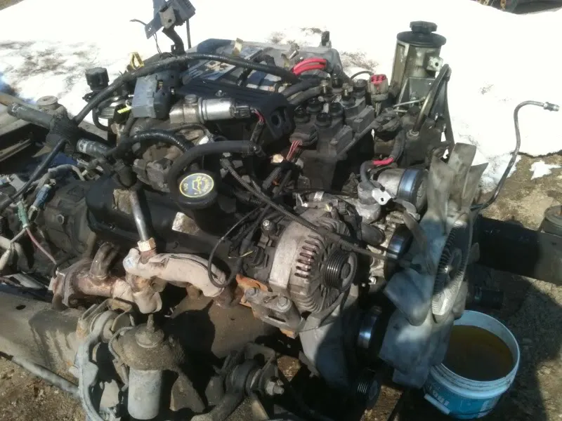

I got the body pulled off my Explorer today, so the engine is ready to pull out. I think I will wait until I get a front brake kit and get all the front end parts put on.
Sure will look a lot cleaner once all that fuel injection crap is gone! :D
