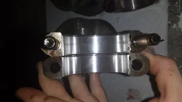

Sorry i tried to search this but wasnt sure how to word it. So a buddy helped me out tearing my 351w down awhile back so i didn't get to see how the connecting rod caps go on.. Do the notches for the bearing line up like or like . If you cant see the difference just need to know if the bearing notches are suppose to be next to each other or opposite. Also he didn't label which cap went with which rod. Is this a big deal on a motor i'll be stroking in the near future? Thanks!

Each rod and cap have a large chamfer and small chamfer. Just look at the radius were the rod and cap meet. You will see the difference. The large chamfer will also face the crank. While the small chamfer on the rods will face each other.

If you have even one rod cap backwards you will lock the motor up trying to turn it over. I always match caps and rods and never mix them up. Are you checking bearing clearance? Like said above, the large chamfer will go towards the radius facing the crankshaft and the small chamfers will meet rod to rod
