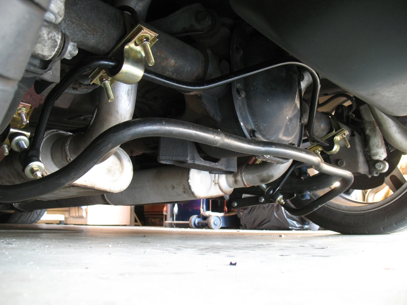

SRT Handz
I tripped & fell down and cut myself & got blood
Oct 10, 2004
941
23
La Mirada, CA
Feb 19, 2008
  • Feb 19, 2008
MM Adjustable LCAs
Eibach Sportlines
Tokico 5-ways
OEM Cobra Sway bar
Steeda Adjustable Sway bar
Double Sway bars FTW

Dude that looks hoss ass. Where did you get that othere sway bar? This probably sounds dumb but how much better did that make it handle?

so some run no sway bar at all, and some run two? any big differences with two bars?:SNSign:

SRT Handz, how much of a difference did that cobra swaybar make?
