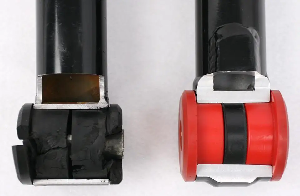

On that subject, here is an interesting comparison.......

SteedaGus, Thats a great selling point by any means...But on the other hand whats the thinkness of our original stock ford ones??? Its probably even thinner and more flimsy then the cheapest chinese brand.
Interesting in what sense? Posting up a cut away picture of an obviously thrashed high mileage, highly abused brand "X" control arm beside a cut away of a brand new, zero mile, polished and primmed Steeda arm and calling it an unbiased comparison?
No offence Gus, but your comparison might be a little more convincing if you posted up a picture of the cutaway of a Steeda arm, that's gone through the same amount of abuse that this other one has.
You are missing the whole point. You can't see the difference in wall thickness and material between the 2 pieces? Extra reinforcement in a high stress area on ours, 3 piece bushings design? Its all there if you look. It is all about construction and design.
I find your response quite interesting, since every one else who we've shown this picture to has spotted the obvious differences quite easily.
What that picture doesnt show is how thin the axle side bracket is on the competitors arm. I can literally squeeze the bracket and budge it with my hands. Some people might not care about that, but I would not want a flimsy piece like that on my car. And that is what you can expect with many of the lower quality pieces out there.
Gus, I can appreciate the build quality of your arms, and for Danny drag race, and Rodney road course they more than make sense. Your comparison still doesn't justify how an arm of that obvious build quality will benefit the average street car.
Your comparison was equivalent to putting a stock block next to a dart. While obviously way better built and highly durable, there are way more cars out there running the former as opposed to the latter for the very same reasons.

And I still have to say that there is no way any of that flimsy junk will ever find its way underneath my car. That picture that Gus posted really hits it home, IMO. This is really why there is no sense in the "but it looks the same on the outside" reasoning. Thinner tube wall thickness, less weld bead, less weld penetration, inferior bushings, and Lord knows they are probably using inferior steel is some of these cheaper knock offs. I'd use stock control arms before I ever ran crap like that.
Gus, are you at liberty to say what brand those control arms are? Maybe you can send it to me in a PM...? :D
