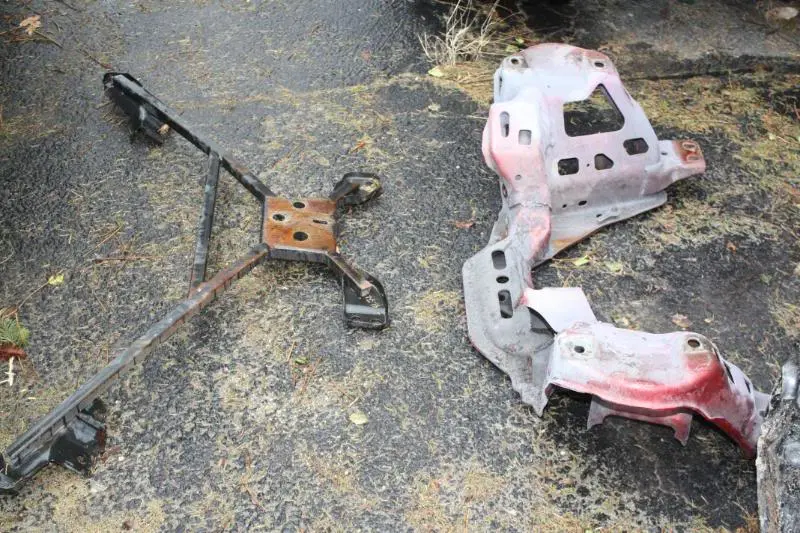

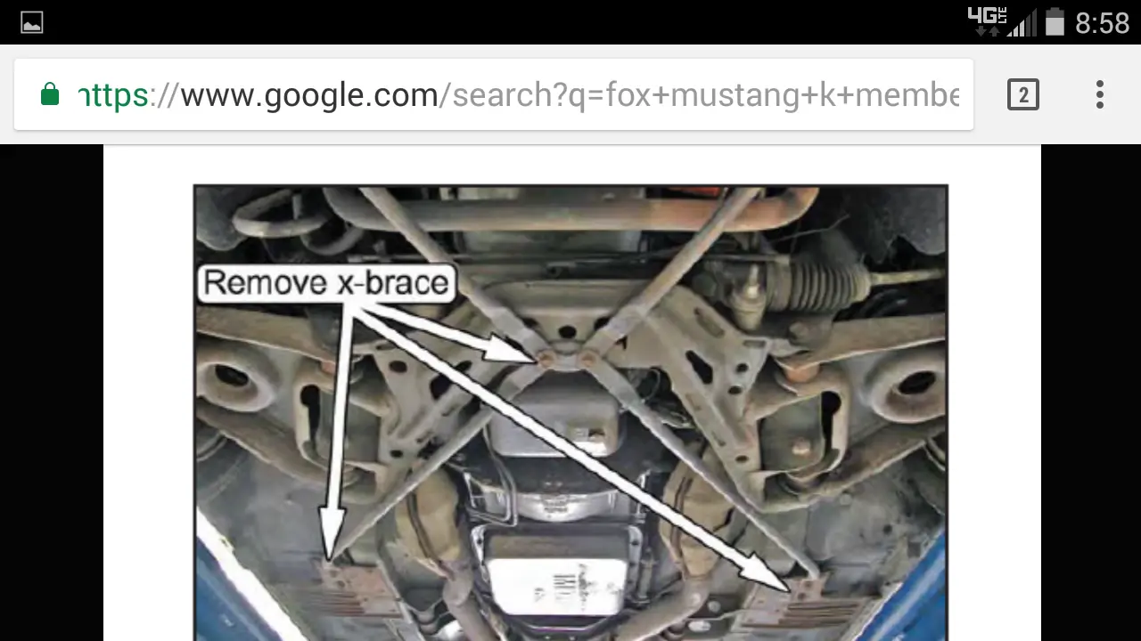

Can someone please post a picture of the factory k member brace(s) for a 93 convertible? I want to see what it looks like so I can be sure to get the right one.
Is this it?
On my 89 gt convertible they looked just like these. One " V " went up to the corners of the lower core support....the other one went to the reinforcement plates below the floor.
A friend of mine had a 92 and I remember us looking at his car and it was the same.
Reactions: JD1964
Thats what my 92 looked like too
That one looks too heavy duty for ford stock stuff.
