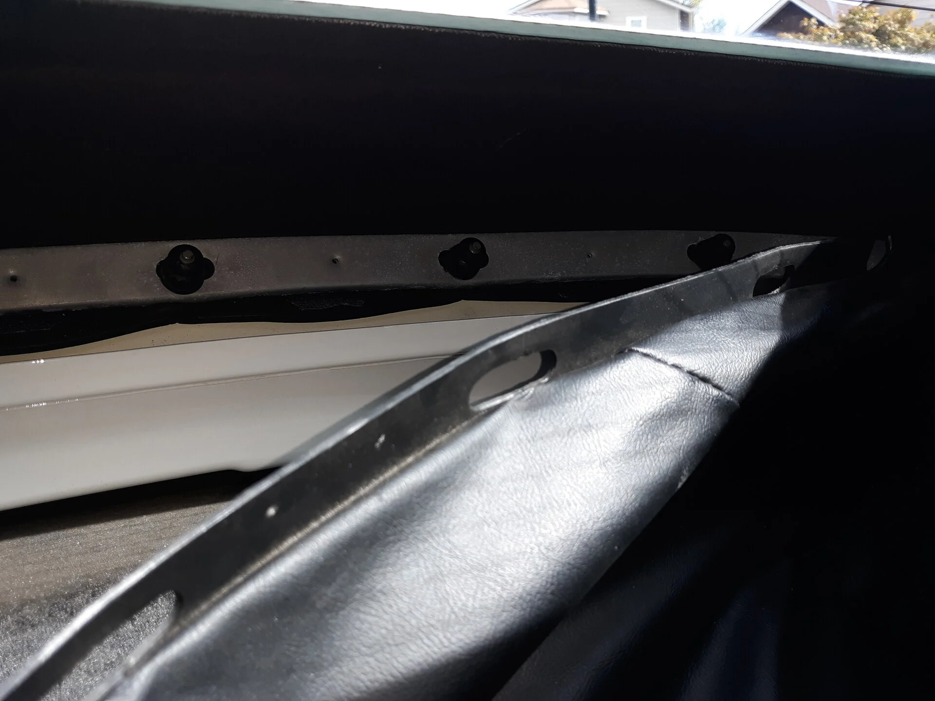

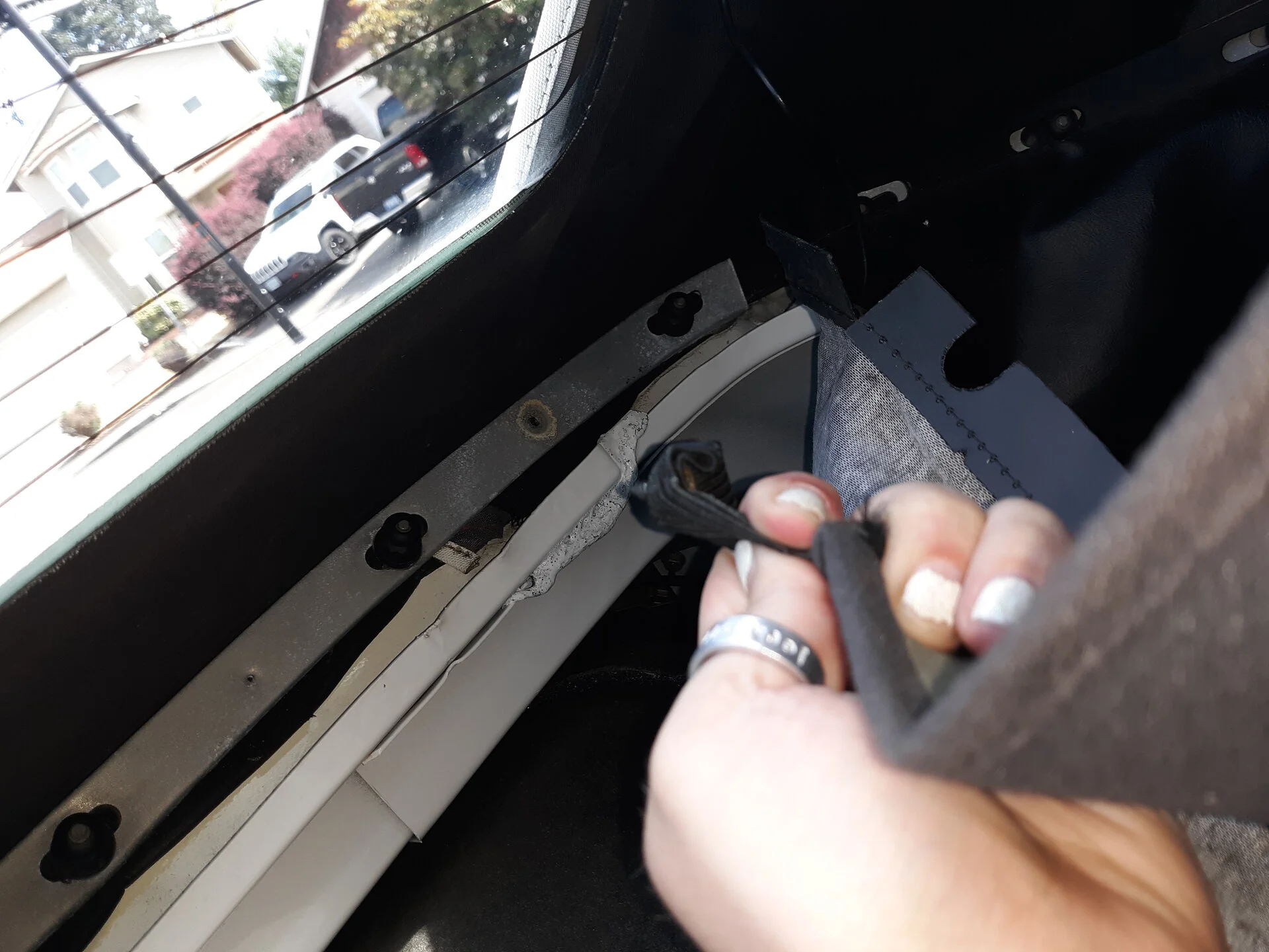

I had the same problem. You can pop the beauty pouch off of the inside and remove the 2 screws. After that, take some water and pour until you find the leak. I use e6000. It allows you to see the inside of the leak rather than trying to find it from the outside.
