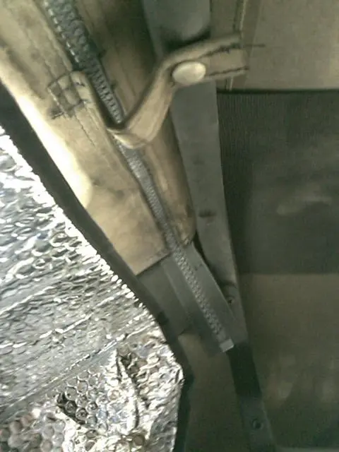

Here is a pic of the area I'm referring towards. I want to know how the rear window attachment on the top side of the zipper is attached to that metal brace. Not the snap, but tthe material that is tucked under the metal bar. The zipper doesnt come fully undone.. the rest is still attached at the very end.

Yes, to remove the whole rear piece you have to remove the back half of the main top. If the color matches I would just remove the zippered part. There's some nuts on the bottem edge and it should just be a direct swap.

Thanks, thats all I needed to know. I have a feeling the color isn't going to match because the material has faded a lot. I wanted to get a new top, but that's allmost $400. So I'll just put up with this for now. It's enough to stop water from making a mess in the back.
