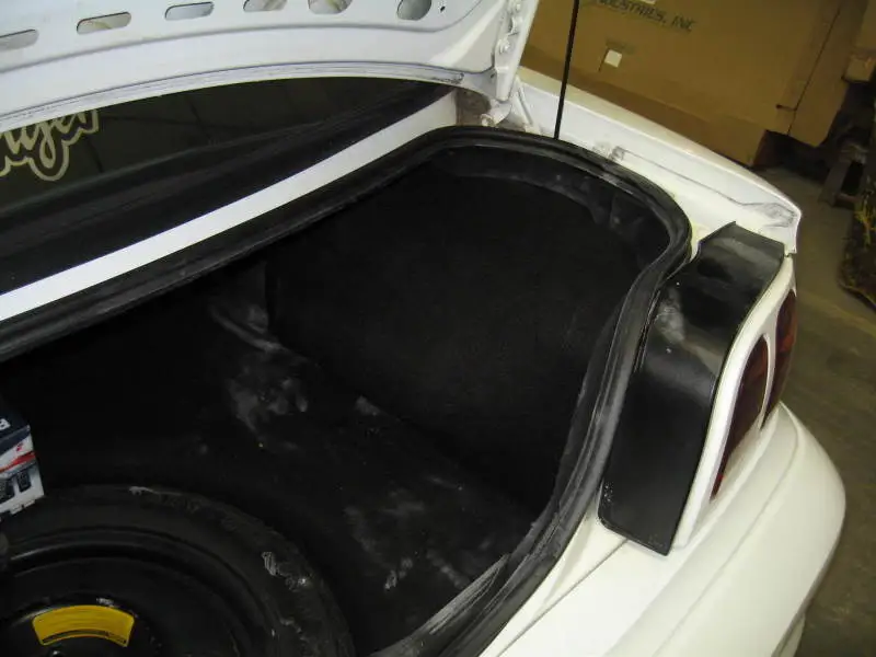

It will take at least 3 times the sub you expect to get any sound out of that trunk.. then your decklid will just rattle and you still won't here any bass..
You need to maximize your mid bass in the passenger compartment..

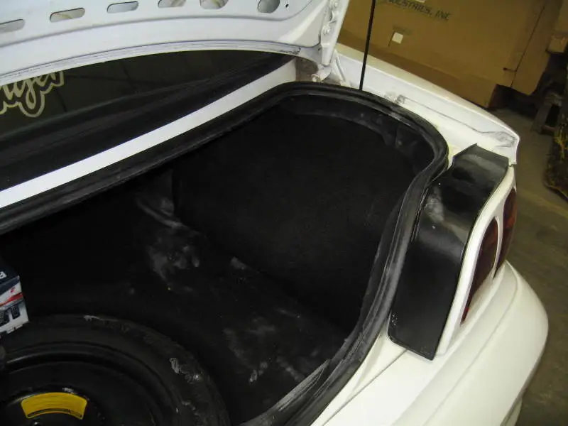

Personally, I would run memphis car audio 8" Multi Syncs in the front doors, and 6" multi syncs in the rear corners...Push as much power as possible to these mids...I recommend the Memphis belle 5 channel.... 75x4 + 1100x1 RMS! JL does make a stealthbox for the trunk, but it still won't be very loud..
Stealthbox

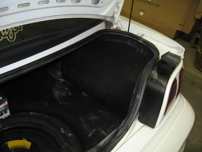

Stealthbox
What kind of crossover would you run on those 6/8 drivers?
Is there a solid howto on cramming 8s in the doors?

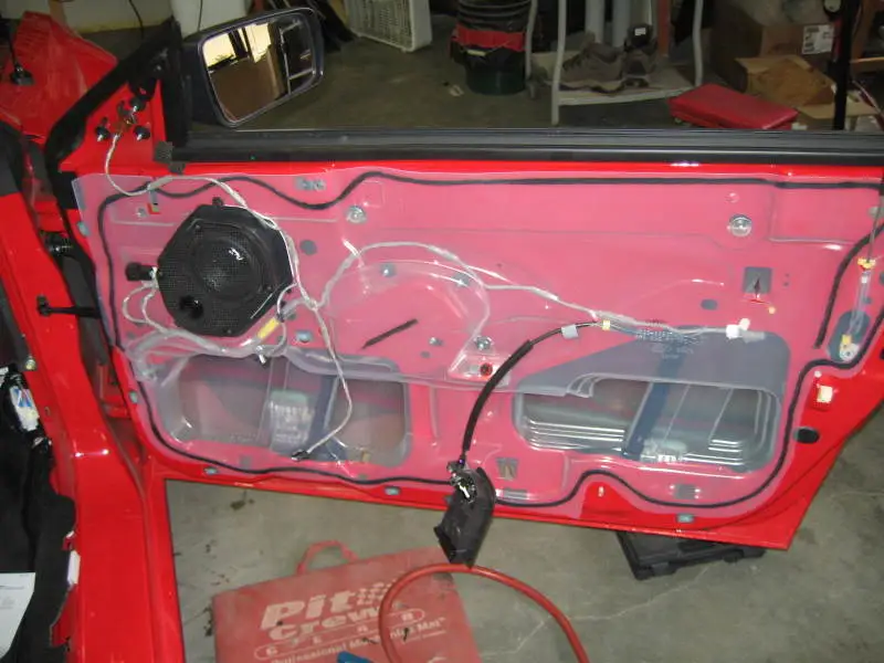

It will take some work (cutting with body saw, etc) to get them to fit.. but, the DO fit in the doors.. I made them work, had excellent pics, but lost all of them when the work computer crashed...
Like I said before, most importantly you will need more base in the cabin area because the sound doesn't leave the trunk... I did a mustang vert and even built ports from the trunk into teh cabin and still very little base.

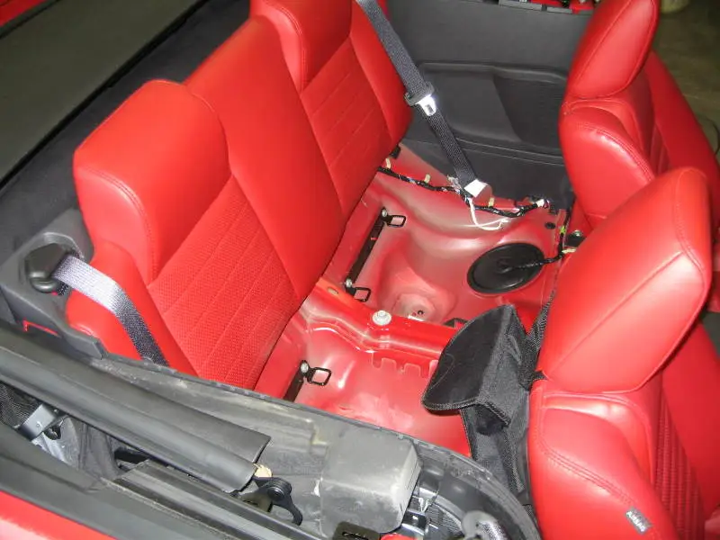

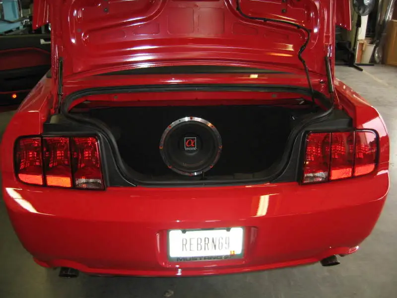

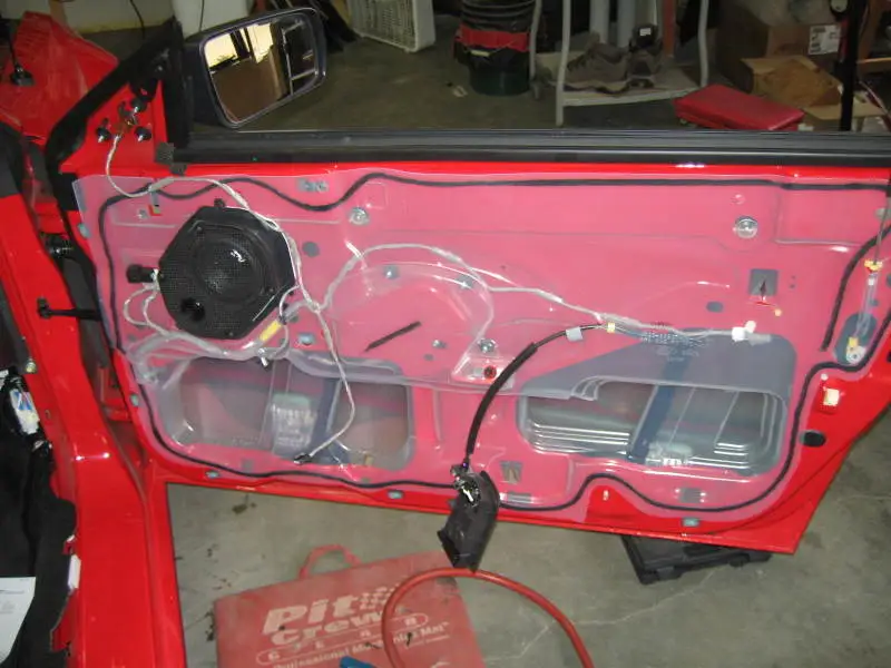

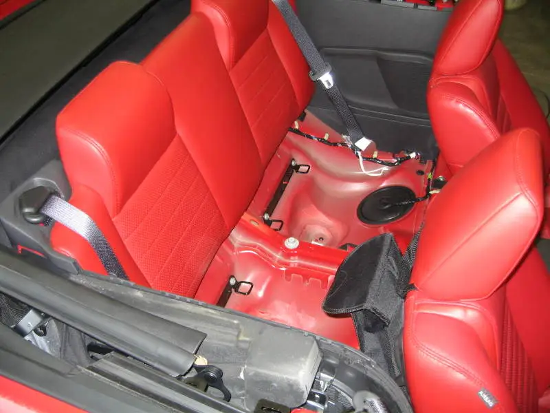

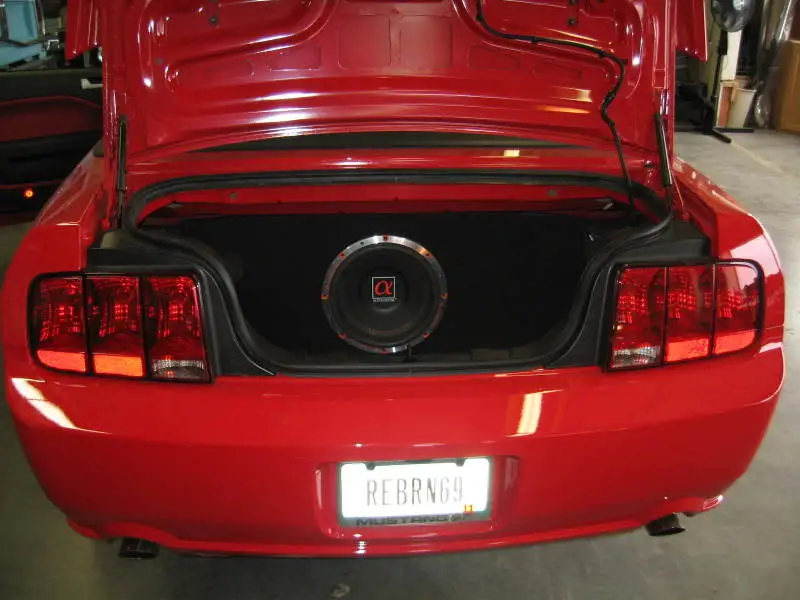

it's an 05 Vert ASS
Where's your bull**** flag now???
There is a large opening underneath the back seat..We used an aeroport into the quarterpanel area.. It was added after these pics because the customer came back because there was not enough "base"...
