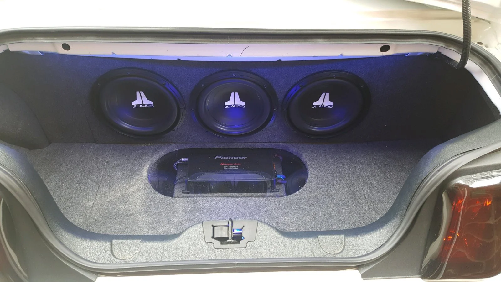

Just saw this thread and thought I would chime in. I have a 2012 vert with Infinity 6x8's in the rear factory locations, a set of Infinity separates in the front doors. The 6.5 mid uses the factory location and the tweeter is near the door handle. Each of these gets about 100 watts each. Also in each front door is a 8" shallow mount Pioneer sub in the factory location, each getting about 125 watts (low power subs), then in the trunk are currently 3 10" JL audio each getting 300 Watts for a total system wattage of 1550 watts. Everything sounds great and bass hits hard even with the top down. In fact I think the bass sounds better with the top down than with it up. And there is no problem having great sound even at highway speeds and the top down. I am, however, in the process of redoing the trunk and the 3 10"s will be replaced with 2 12's each getting 600 watts, so I will be approaching 2000 watts total RMS.

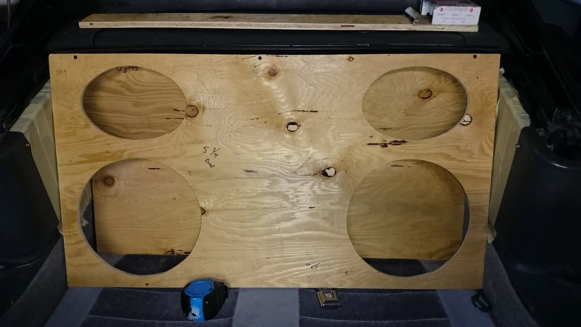

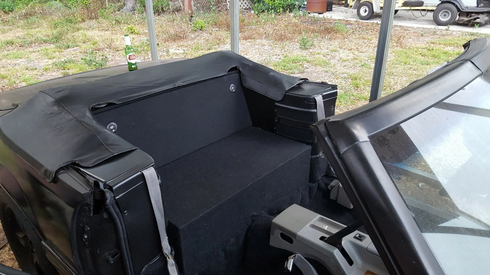

What i did in my gf's fox body convertable. These subs are not very deep. Pan cake woofers would be best.
The enclosure is 4 seperate compartments two 12" subs, two 6x9" speakers. I also utilized speakers under arm rests next to rear seat and under the dash at factory locations. 6 speakers and 2 subs, total

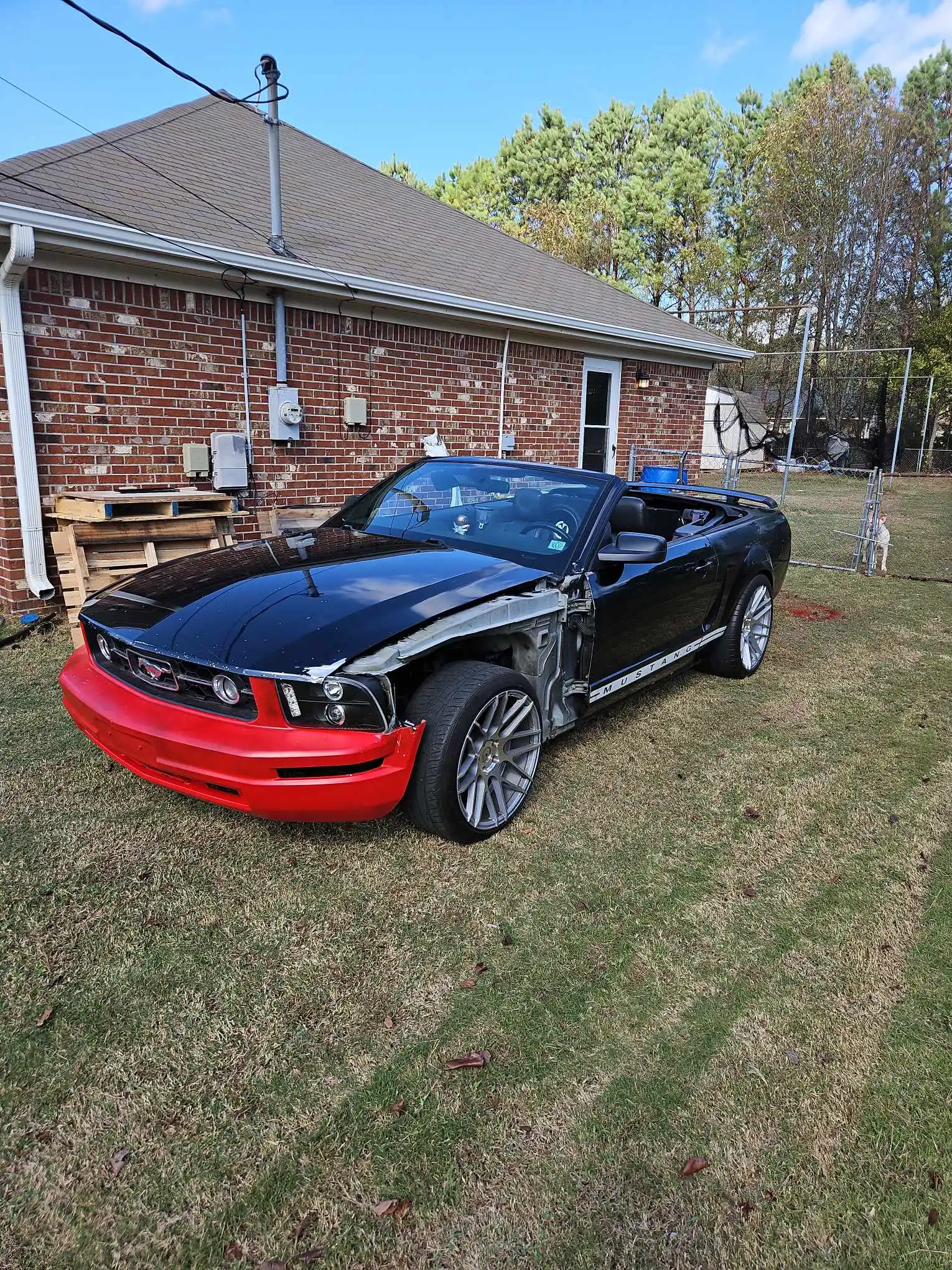

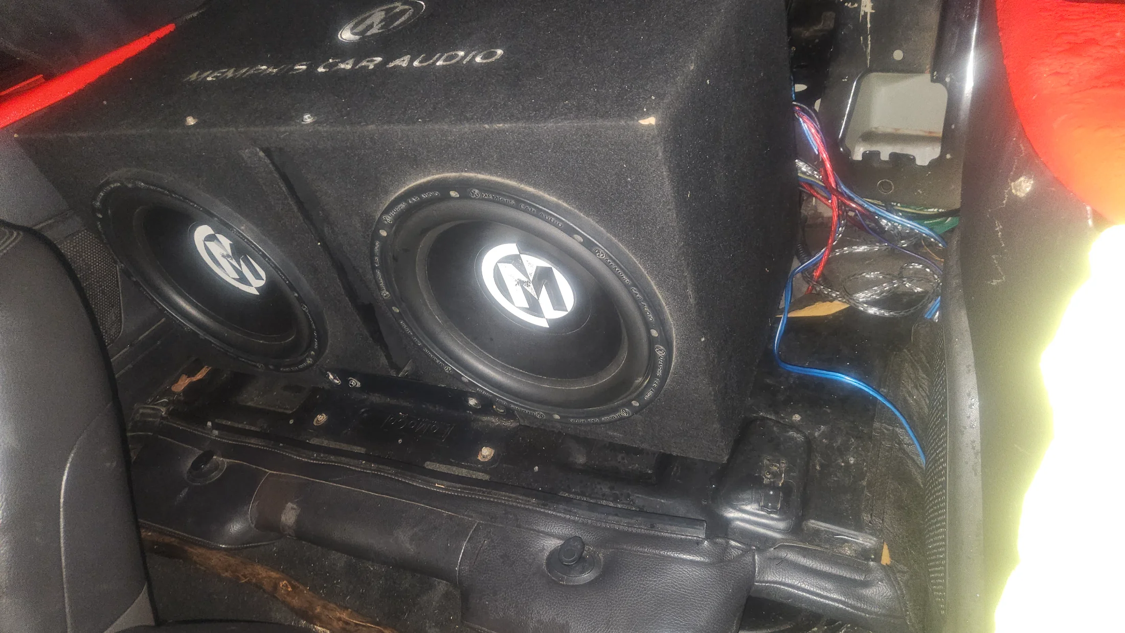

I have a 2005 Mustang 4.0 convertible
Ok I know this is an older thread but it caught my attention due to the fact that I'm wanting to do a rear seat delete.
Also wanting to have the optional shelby cobra style hard top.

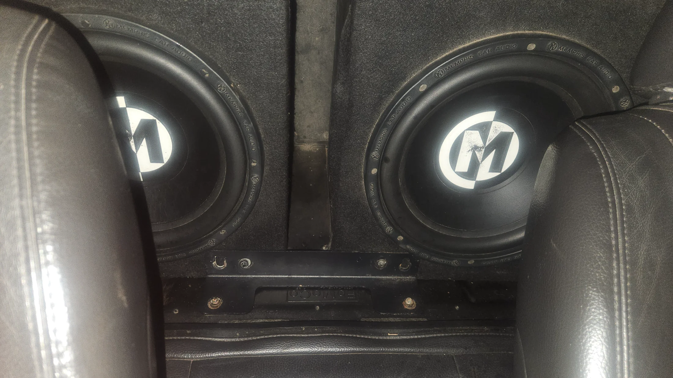

What i have is a cheap deck sanptent and a jensen 1200 watt mono amp pushing 2 memphis audio 12's.
I remover the lower portion of the rear seat and laid down the back. Placed my sub box on top of the back rest. And I must say with with the angle of the speakers and the space between them and the front seats it sounds the same with my top up or down. And i have a straight pipe exhaust.
It's a hard thumper set up

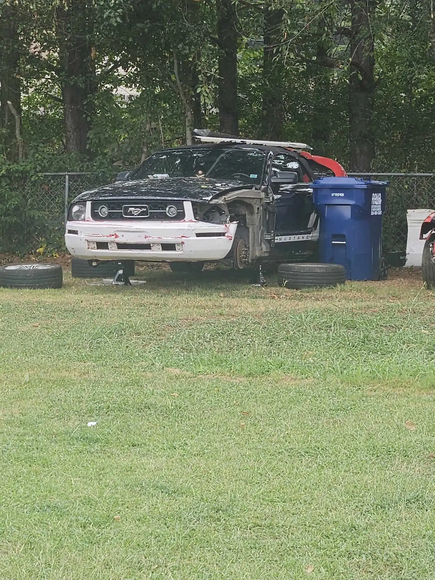

The picture with the white bumper was what it looked like when it was given to me.
Complete suspension rebuild, new 19x10.50 rims with
285/35R19 rears
245/40R19 fronts
Replaced fuel system and misc components throughout.
Recently bought donor car for $400 to complete this one
