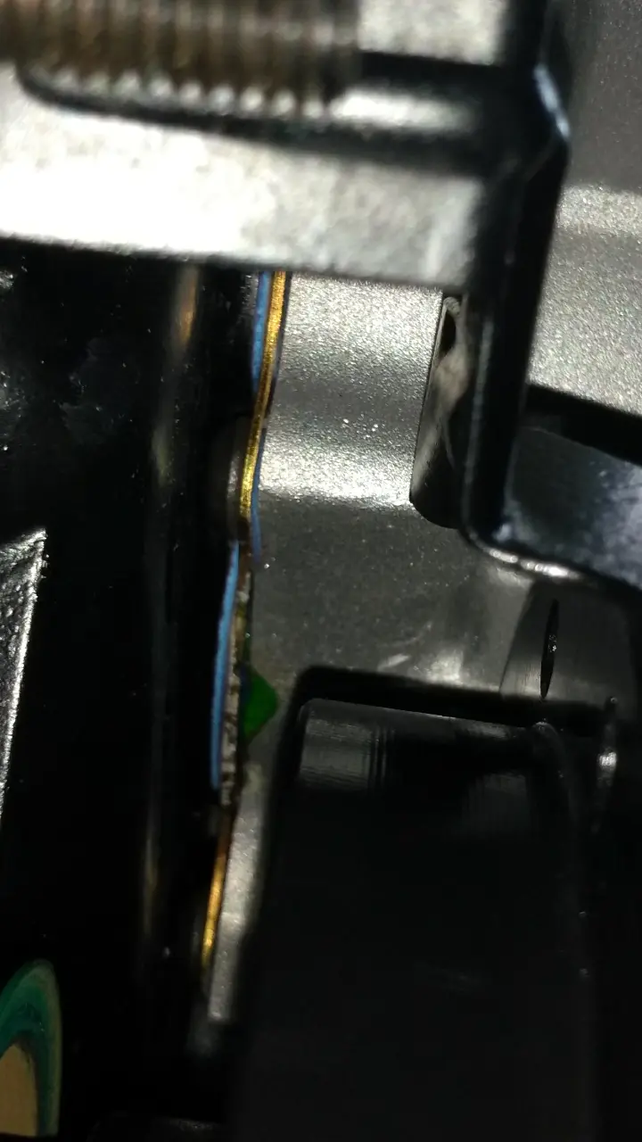

Hey guys,
I haven't driven my 90 coupe much this year after replacing the timing cover gasket and water pump. Mainly because of what you'll see in the picture.
This picture was after a short drive out of town and in town. But this is as bad as it's been getting. No evidence of it dripping anywhere. It's almost like it's just "sweating" a bit if that makes sense?
Where did I go wrong? I re-tightened everything after a couple heat cycles. Used Permatex thread sealant on the bolt threads. I used Permatex high tack sealant on the gaskets to keep the in place. I put loc-tite on the two bolts on the water pump back plate.
I noticed there was a little slit or groove at the bottom of the timing cover. Was I suppose to put rtv there?
I'll probably keep driving it and checking it so often. It's been sitting for months in my shop with zero coolant leak.
Thanks!

The slot at the bottom of the water pump gasket surface looks to me like a drain slot (for what I don't know) and never had the guts to ask, so if anybody knows then spill it.
Yeah, that little leak will be annoying, it may stop over time but I doubt it.
Yeah that little leak is annoying. As of now none of it is actually hitting the ground. I would have never known if I hadn't looked under the water pump.
For your next gasket change-
Actually is that a spray that's red? If so, I used that on the water pump gaskets.
The Permatex high tack sealant I used on the cork corner pieces for the oil pan to timing cover.

Look for rust stains after letting this go on for a little while longer. That's a clue as to where to look next
I couldn't get the heater hose connections to stop leaking. I emery clothed the heater tubing coming out of the water pump to clean up it's pitting and roughness and then coated it with blue silicone sealer.

That's a good idea. Unfortunately, mine have allen heads. And I tightened them down good and applied loc tire
Button heads right,not socket head cap srews?
I'm sure socket heads were not what was used but must say the height of the heads may cause an interference issue keeping the pump from seating properly.
After all that,if that was the case I'm sure the leak would be more than what your seeing currently.

"...Water pump seems to be sitting flush..."
I cant tell from the pic. Did U follow all the recommended proceedures when doing the job? It's not just R&R but rather precise. Inc running the cover on a straight edge to ck for straightness, etc, etc. If U did the FULL job were there any anomalies? How did U solve them?
