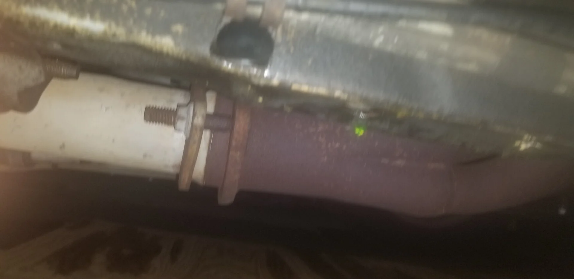

After my 1991 foxbody sitting in my garage for winter I have the same problem cant figure where its coming from look at the pic ? What is it?
