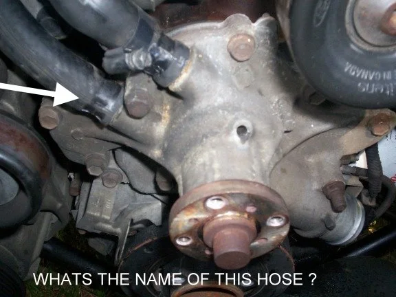

Anyone Can tell me the name of this Hose ??
I need to replace it and I don't know the name !!!:doh:
That's the one that attaches to the steel line that is above the lower intake, right? It's the heater return hose. The one to the right of it goes to the thermostat housing and is the bypass hose.

I was able to get both the smaller pump hoses at the parts store, but they did require some light trimming. Having midget hands helps with the R/R.
I often dont bother with the names of the hoses because they still give me the wrong one. I just have them pull up all the hoses and bring me one of each (of the likely ones - in this case there are two).
