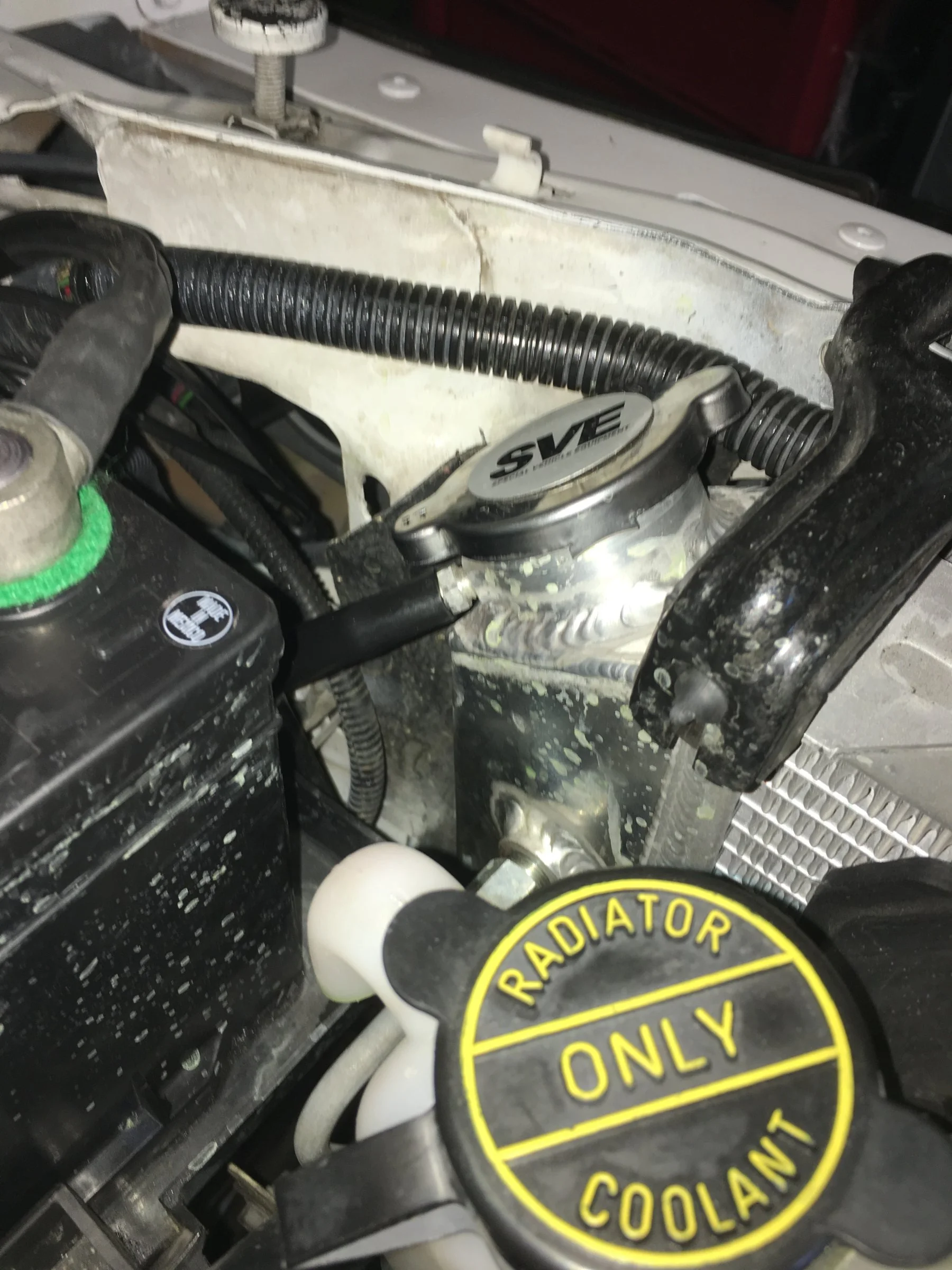

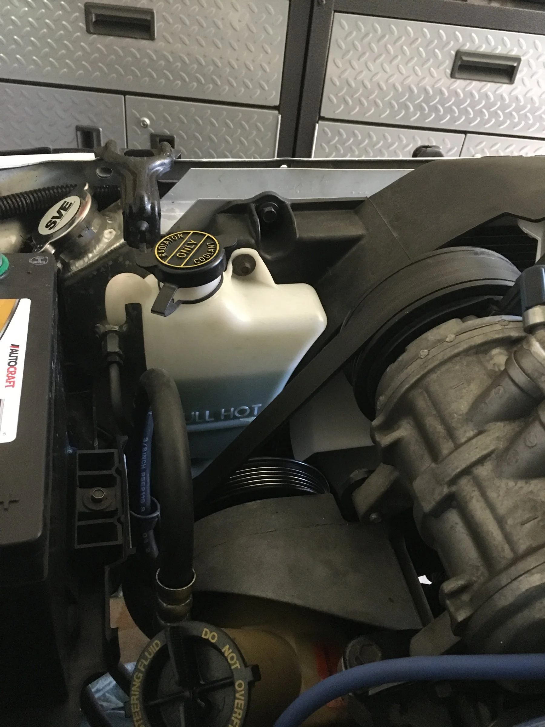

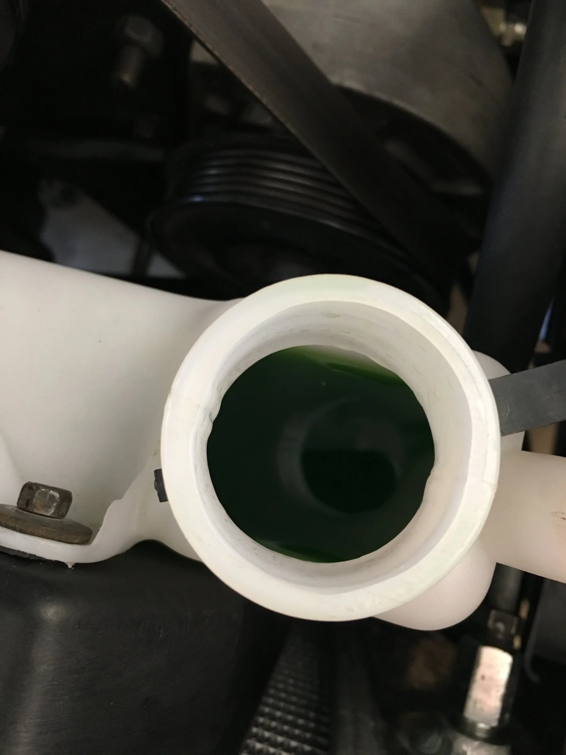

Hello Gents,
Just had the transmission completely rebuilt and car is coming along pretty well. When I got home from my 10 mile journey and parked, I smelled coolant. Upon inspection, noticed the coolant level really high and what appears to be leaking around the radiator cap at some point. The car is cool now, about 3 hours and the coolant has not retreated back........ The reading has always been somewhat off: COLD reading at COLD temp and COLD reading at HOT temp. Anyone else have these symptoms before? Any advice helps.
Thanks!
