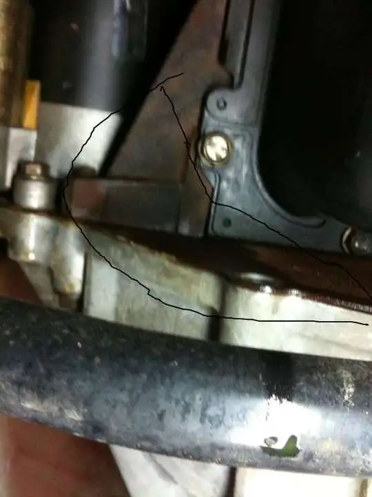

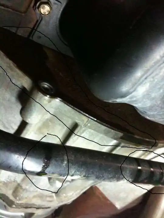

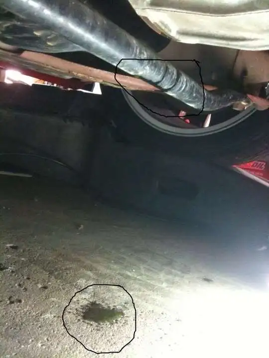

ok, got a chance to go out and look a little further over the weekend. Was going to change the thermostat for cheap insurance. I pulled my car onto some ramps and crawled underneath and what do you know....it does have a leak. Its coming from the front of the tranny and dripping down on the sway bar.
You can see in the pics. The last pic is looking straight up at the starter.
I was not able to see anywhere else where it was actually coming from, just in these spots. Also, when I started my car, there was some white smoke, not sure if this is because of a blown headgasket or since the car was sitting for awhile. It did go away though. My oil still looks good though. Any thoughts?

There are some heater hoses and connections on the top end of the engine. There is also a hose that goes through the engine valley. That would be a good place to start looking.

FWIW bakos24, my KB-blown SOHC suffered what I thought was a catastrophic failure when, after getting on it hard for a moment, I was met with a large, billowing cloud of steam out behind me. When I stopped, I looked underneath and saw coolant gushing out around the same area you're seeing. I babied it back home (just a mile or two) and when I got under it, I saw that the block heater, which was installed in the rear-most core plug hole on the driver's-side of the block, had blown partially out. In my car's case, the block heater is sealed by just a rubber ring expanded by a washer when a bolt is cinched down. Over time these rubber-rings dry out and can leak or even partially blow out as I found.
Might be worthwhile checking the core plugs and especially a b-heater if you have one installed as the source of your leak.

I just re-checked your pics and notice you seem to be weeping down the passenger side whereas mine was on the driver's. Might still be worthwhile checking the plugs but you might find the heater hoses and the connection to the water tube running out of the back of the waterpump to be the real source of your leak.
