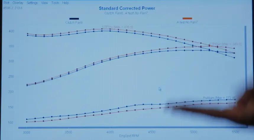

From the Engine masters cooling fan shoot out video:
Test engine: 350 chevy
Engine dyno
No fan: 349/406.9
628138
Clutch Fan: 335/400
628139
