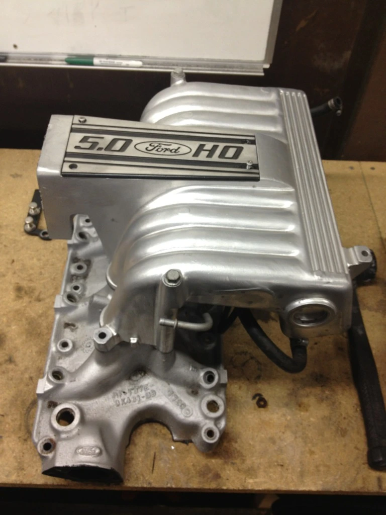

the intake manifold.. Not the intake tube..it is on top of the motor. There are 2 parts to it. Upper plenum and lower intake. If you are looking at the front of the motor it is on the right side of the lower intake. There is 1 wire attached to it.
Look at my pic there is a threaded hole exactly where I explained. That's where your sensor is.
Ah I understand. When I read intake, I assume the intake tube, not the manifolds. My mistake.

no problem, just wanted to clarify so you knew where the sensor was. off hand I am not sure what size they are. It only has 2 screws because it is an explorer intake with a mustang plate on it. The explorer one only has 2 threaded holes.
