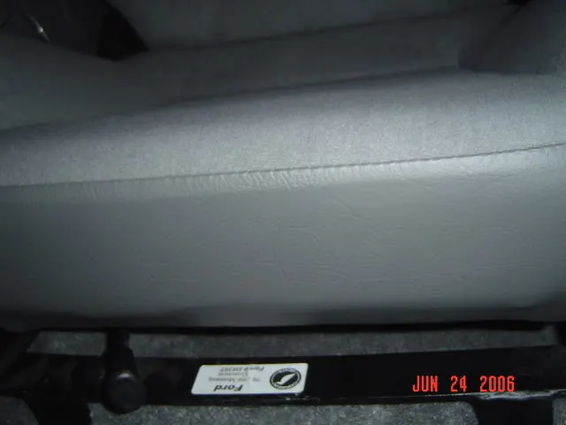

ok, here is what the bracket looks like

That bracket doesn't look like mine. My slider is all the way to the left and right edges of my brackets. I just went out and looked at mine. Mine does dig into the tranny carpet pretty good on the driver side, but its all hidden with the seat there. I'm not 100% certain that they sent you the right bracket.

You're right... I hadn't noticed that mine was different from your's. My deat does line up with the holes because I had the slider bolted onto the seat last night. The bolt holes in the slider also match the floor holes in the car.
Both brackets appear to be identical, and they both are labeled for 79-98 Mustangs.
