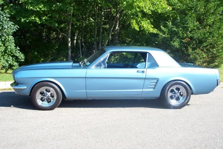

I made the mistake of installing 1" lowering springs (5 leaf)on my 1966 Mustang. Now every time I hit a bump or dip in road, the tires rub. I am runnig 225/65/15 x 7 1/2 " rims and wheels. Can someone suggest the optimum spring rate?
I need to raise the car back up 1" and I do not want to make big sacrifice handling.

The problem isn't the spring rate, it's your wheels and tires. 5 leafs are fairly stiff, and I don't think you'd be all that happy by simply making it stiffer to keep the tires from rubbing. Your car should go all the way to the bump stops without rubbing, so if it were me, I'd fix the wheels and fenders.

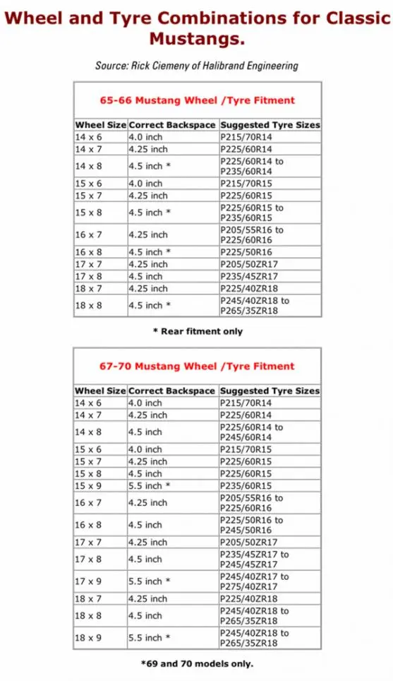

Determining the correct spring rate is important. I may need to change or enlarge the rubber stops, if that is possible. ? The wheels are 3 1/2" offset and there is probably another 1" to use up before hitting the springs.

Here's my basic theory on spring components:first of all, springs should be just stiff enough to keep from hitting the bump stops during regular driving. If you regularly do track days, your spring rates will be much stiffer than the guy who cruises on sunny days with the wife and kids. Stiffening the springs to compensate for incorrect wheels (like the ones you now have) makes no sense. You can certainly can move the bump stops closer, but that limits travel. What I'm suggesting is to get wheels with 4.375" to 4.625" of backspacing. How do I know this works? Because I once had a '65 as well, and the 15x7, 3.5" backspace wheels on my car also hit the fenders (HARD!!!) with a 225/60-15 tire and stock springs. My current '68 uses stock Shelby 10 spokes (15x7, 4.375 BS) with 245/50-15 tires on the rear and they don't touch, even at full bump. I learned this the hard way, just like you are doing now.

I used to run a set of keystones on my 67 back in the day.If they are of the uni-lug variety you need more backspacing. From the looks of your side picture (Nice looking car by the way!) your side wall looks almost as if it were past the fender lip.

Points well taken, thanks. I just got car back from Local shop that specializes in Springs. They rearched the springs and put the correct shackles on the rear, leaving the spring rate the same. Net effect was to raise the rear up a little over an ince. It looks real GOOD!. I test drove the car around town and highway last night with a full tank of gas, floor jack, foldingchairs and a cooler with 12 bottles of water (usual gear for car shows). I hit every bump and dip I could. Only one dip caused the car to very slightly rub the tires. This dip is one everyone slows down to about 20 mph, I hit it at 27 mph.
What I did discover from the specialist at the shop is that I have a 9" rear that is about 4" to wide for the car AND it is uncentered. He suggested having the rear cut back at leat two inches and centered to fit the car. I might do this next year when funds are a little better. This should help bring the 225/60/15's inside the fender well and completely eliminate any rub.

In the picture it looks like the top of the tire isn't visible like it is in the front. I would put stock ride height springs back on the rear to raise it back up the 1 inch. Most catalogs that I have seen offer a standard leaf spring and a heavy duty leaf spring for stock height. I don't know which spring is really better for handling or ride quality.
