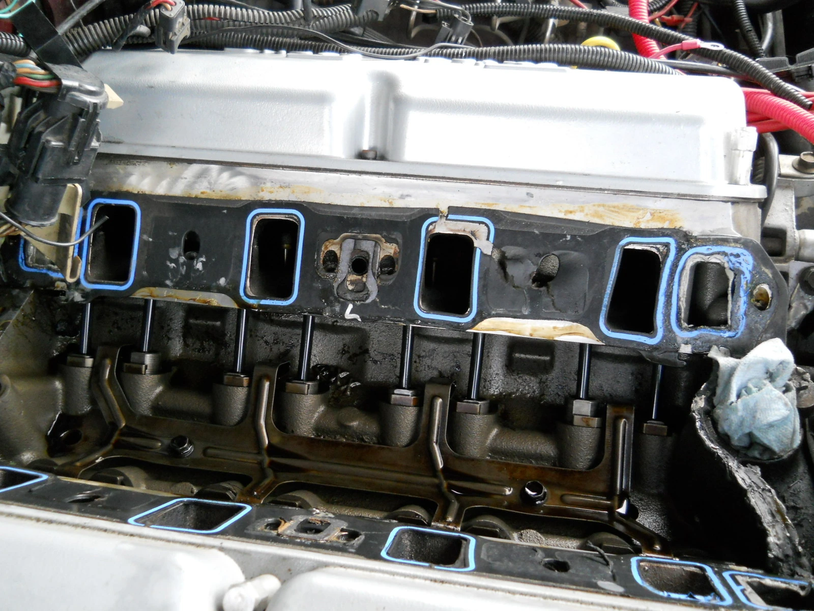

While some members here have had good results with the Fel Pro 1250, I like a few others have not. The first set installed by a professional mechanic who builds his own race motors, and the second set by myself. And both sets litteraly melted causing a huge vaccume and coolant leak. Now I am on a third set of Fel Pros but this time I went with their MS93334 steel core intake gasket for 5.0 and have had no problem.

I got the MS93334 intake manifold gaskets. Fel-Pro says they must be installed without any sealer. Trick flow says to outline water jackets with RTV black.
What should I do?
By the way, I put sealer around the water jackets on the 1250's and did not let it sit overnight.
I just took the manifold off a day later and the black had fused the gaskets to the block completely and utterly. I spent like 45 minutes cleaning everything up. The fat beads on the rails were still a tiny bit gooey in the center though.
