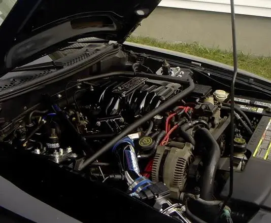

Rob, I have steeda 4 bolt aluminum CC plates that I polished, and MAN do they shine. I thought I had pics of just the plates but I can't find them right now, but here's a pic of what they looked like installed...
As for LCA's, I suggest getting some with QUALITY spherical rod ends (Qa1 ends are pretty good). If they are a cheap spherical rod end the teflon will break and they will get noisy very quickly. I'd leave the uppers along for now. Adjustable control arms are good for setting the correct pinion angle.
