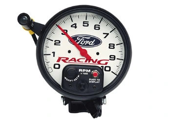

I just finished installing this Tach 10 min ago which has a shift light built into it also. it took me about 45 min to install. it's real easy, just 4 wires (red=keyed on, green=tach signal-or to tach plug on an MSD, white wire=lighting-such as too the headlight switch, black=ground.) Very simple

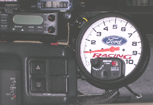

ok thanks i have a 130amp alternator that i bought from kragen stock alt for a 96 mustang. also there did you mount your tach?
If your asking me where I mounted mine?. I mounted it on the side of the dash board. They do make a tach pod that also has spots for 2 extra guages which mount on the dash board goin across the pass side, but I already have a guage cage with 2 guages in it and a dual pod A pillar mount with 2 guages there, so i didn't need it.
Heres a pic where I mounted mine.
Take Care,
Scott
