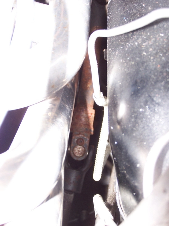

here is the pic of mine-not a great pic, but i think we all understand why....
as far as vibration goes, i dont notice anything unusual. if i remember right, my rack is out of a pinto, and the rack's shaft is about 2" longer. i didn't have the intermediate shaft, so this is why i choose this route. it really isn't too bad, the hardest part would be getting the end of the shaft turned down. only other thing i did was i had the engine out when i did it. dont know if you would necessarily have the room to measure and install with it in there.
