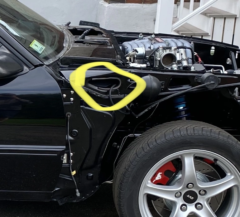

The sides of the cowl void area are wide open.
However if you follow the path, those voids draw from the inner fenders behind the plastic fender liners. That pulls air from the engine bay. Hopefully you don’t have a big exhaust leak or are burning leaking engine oil.
Edit: it’s open here on both sides
