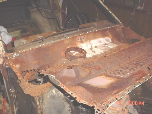

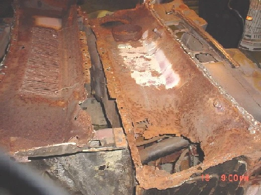

This is the cheap, cheesy, low buck way to "patch" a problem. It is not a fix. I have ripped a few of these out. If the cowl leaked, then the floor got wet. Check the toe boards, and front floorboards very carefully. If the patches were put in before the leak got bad then you may not need to replace too much sheet metal.
We did repair the cowl on a car on the rotisserie upside down. I cut the patch panel down and welded it in from the bottom, but the damage was not that bad. Still had good metal two inches out from the hat on one side and an inch on the other. You have to get a spot weld cutter bit and cut the cowl off to fix this. Here are some pictures of my current project. Be happy you are not me...

Without looking at the vehicle there is no way to know if you need to replace sheet metal at this time. The easiest test is to put a paper towel on the floor and pour about a gallon of water through the cowl. If the paper gets wet you have a problem. If dry you are ok - for now! As shown in the photos the entire cowl pan gets rusty because it was never painted by Ford!! As certain as Mustangs are cool, Mustang cowls rust out. They tend to rust around the hat first because crap piles up there and holds in the moisture. But rust will grow and eventually the cap will rust out.
