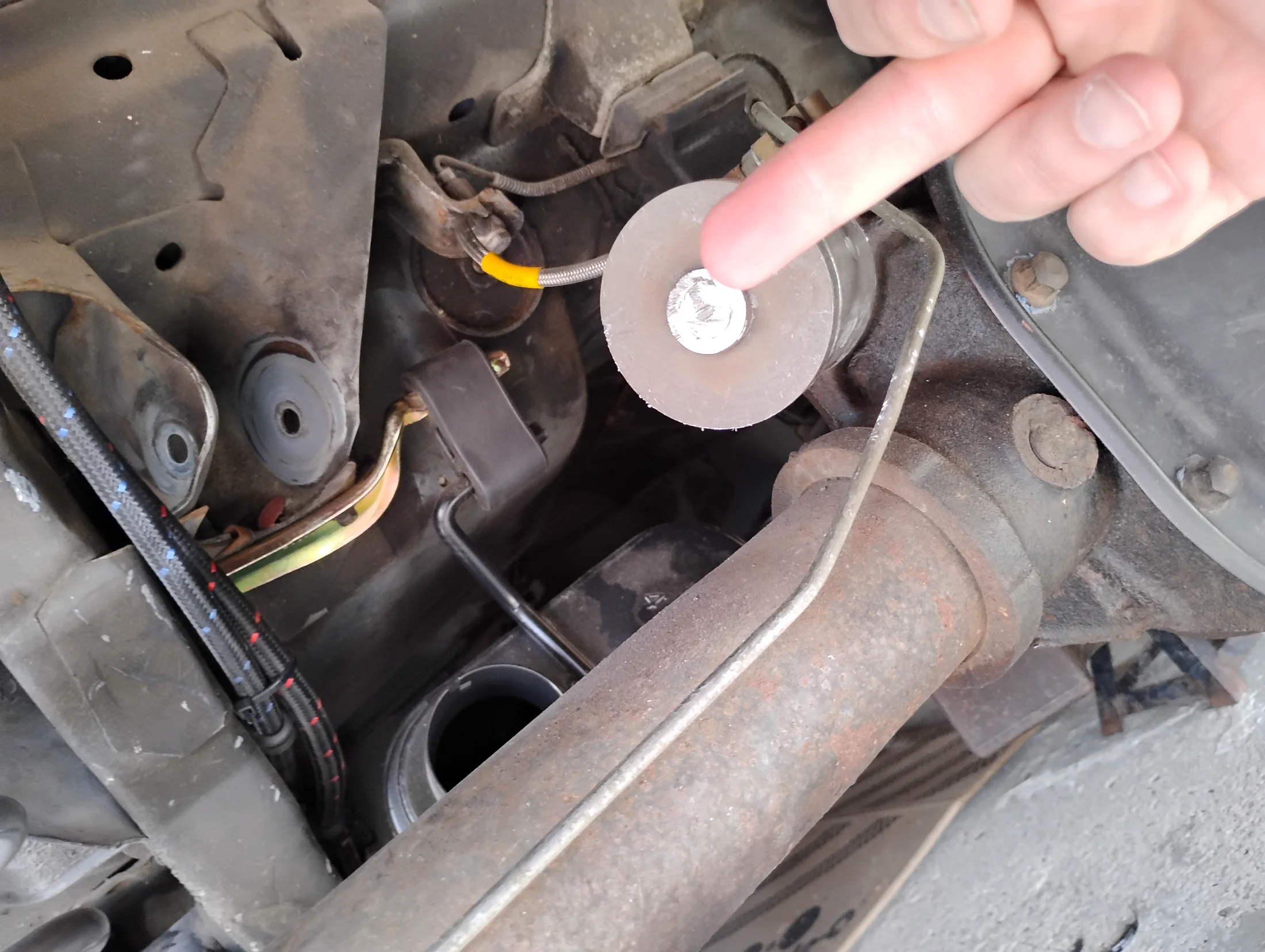

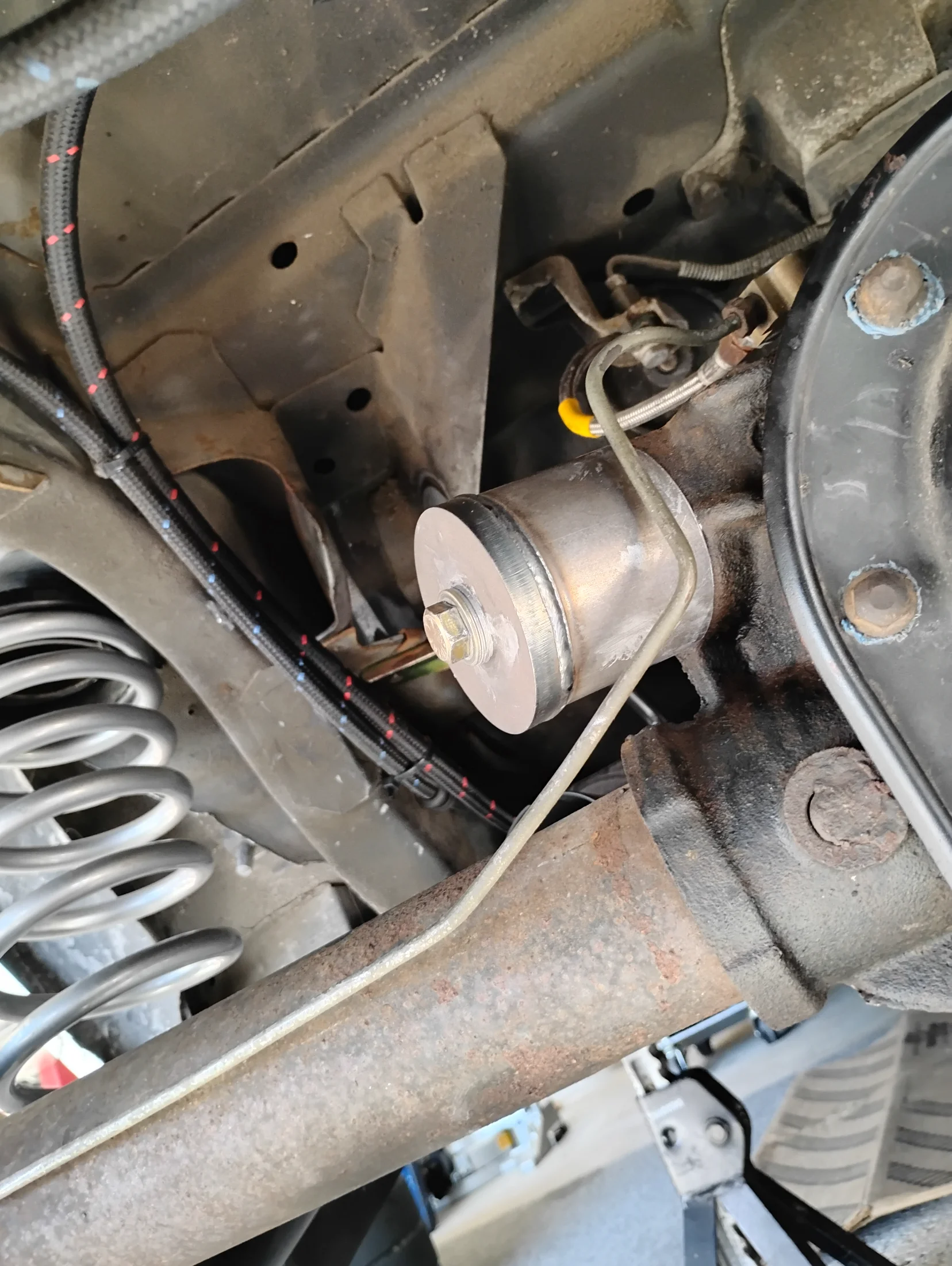

Thought I'd tackle the rear axle housing bushings and new upper control arms with the nice weather we had today. Got the uppers out,then started the process with the MM tool on the housing bushings. And here's where I'm at now,with a stripped
bolt. I'll say,MMs instructions arent real clear,even watched their video
Some good advise on how to remove them in this thread:
Two things I got from it was if you are going to use the MM tool to remove them you need to hit the flange of the bushing with a chisel so it collapses inward. I guess this gets some of the pressure off. It seems that the better way is to just use an air chisel and BFH to remove and the MM tool to install. I like the idea of freezing the entire bushing over night and using some light oil to help them install.
Back to your issue though. The only think I can think of is a sawzall with a good blade to cut that Grade 8 bolt.

Got the bolt cut out,had to cut it twice because not enough room to remove after the head was cut off. So,MMs instructions are IMO. They don't tell you several things,which I figured out after this debacle. Mainly,the bolt WILL run out of threads,hence the reason I stripped it. I watched a few Youtube vide that gave WAY more info than MMs vid
