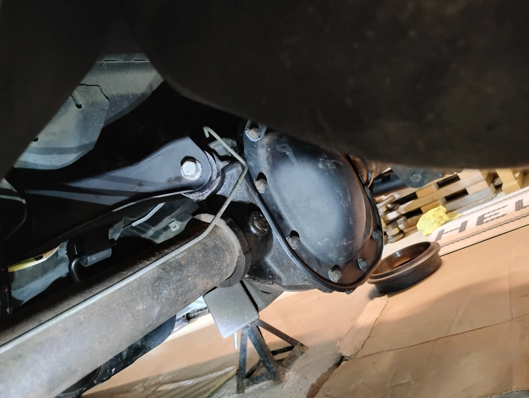

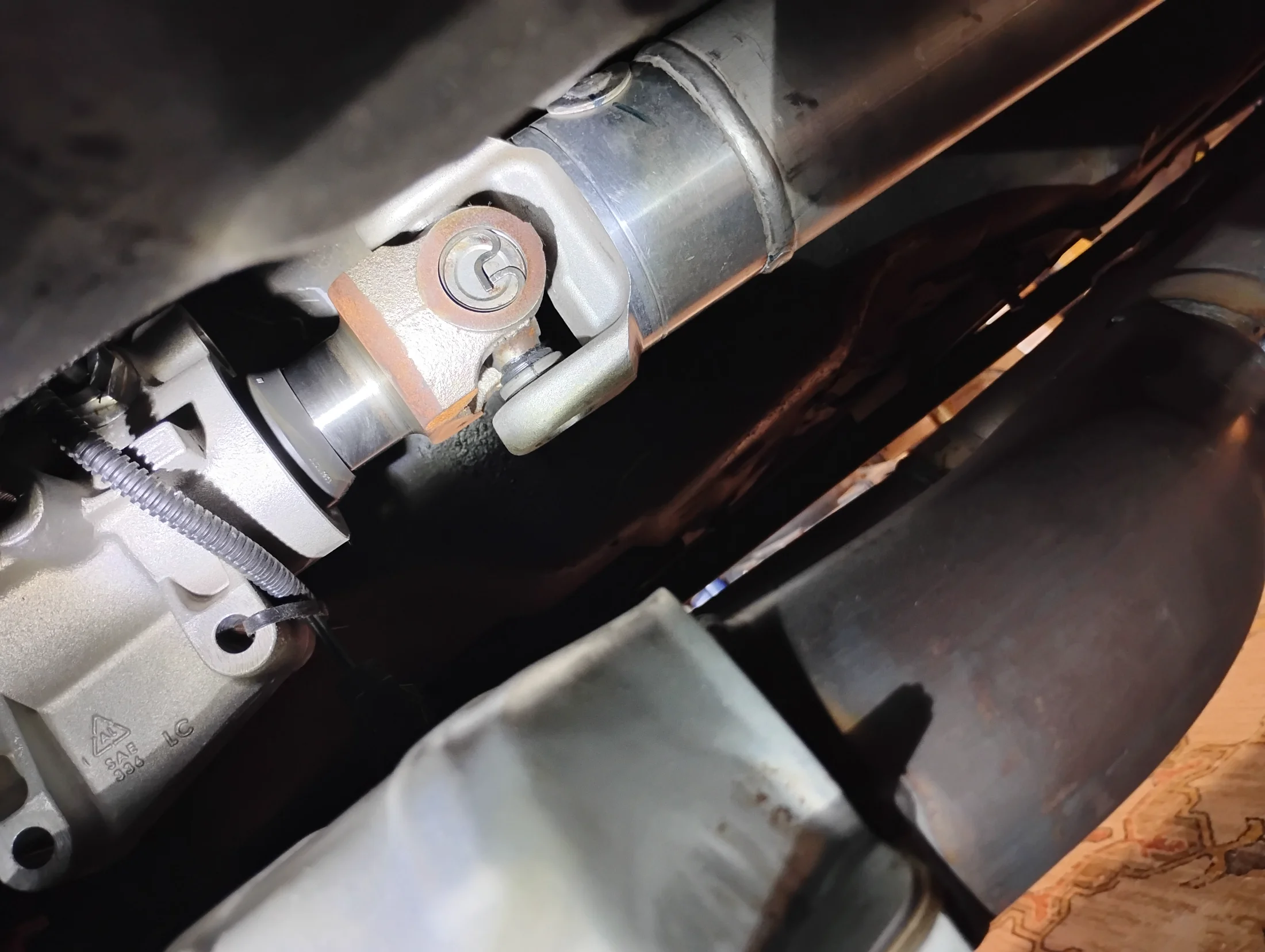

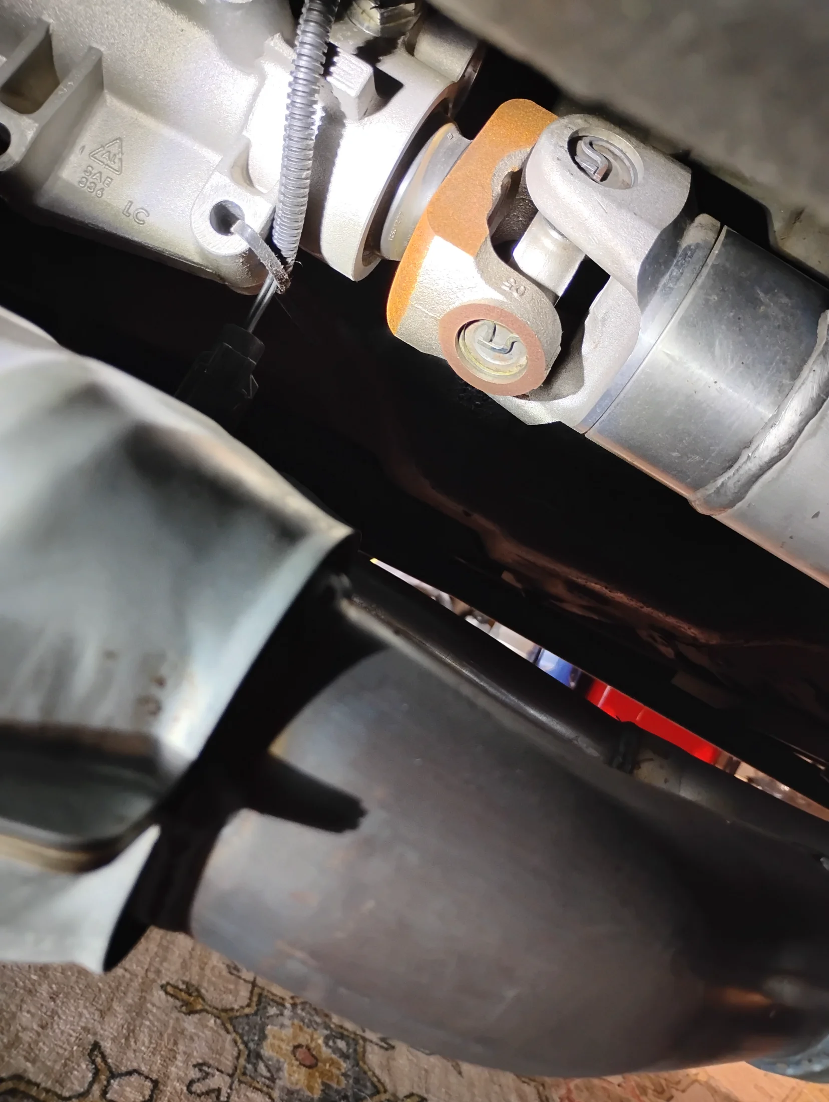

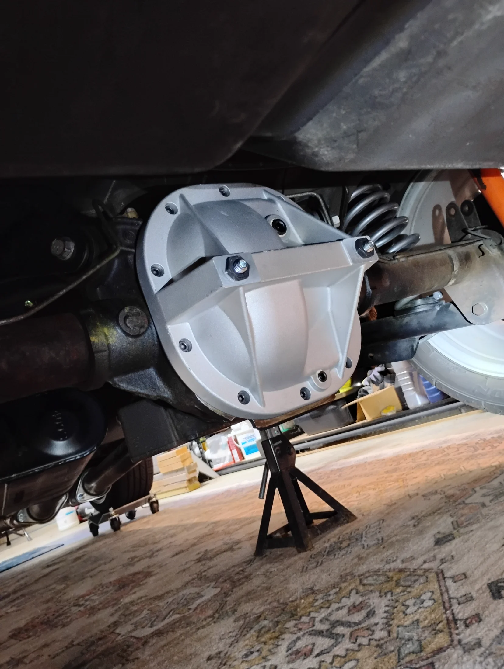

Had a noise on decel,and wanted to step up the gear ratio as well. 3.55 gear set from LMR,and Amazon special diff cover. Got that done,and needed to address my driveshaft. I had almost ZERO play in the yoke. Local trucking company has a driveline department that specializes in driveshafts. Had an inch knocked off for a better fit.

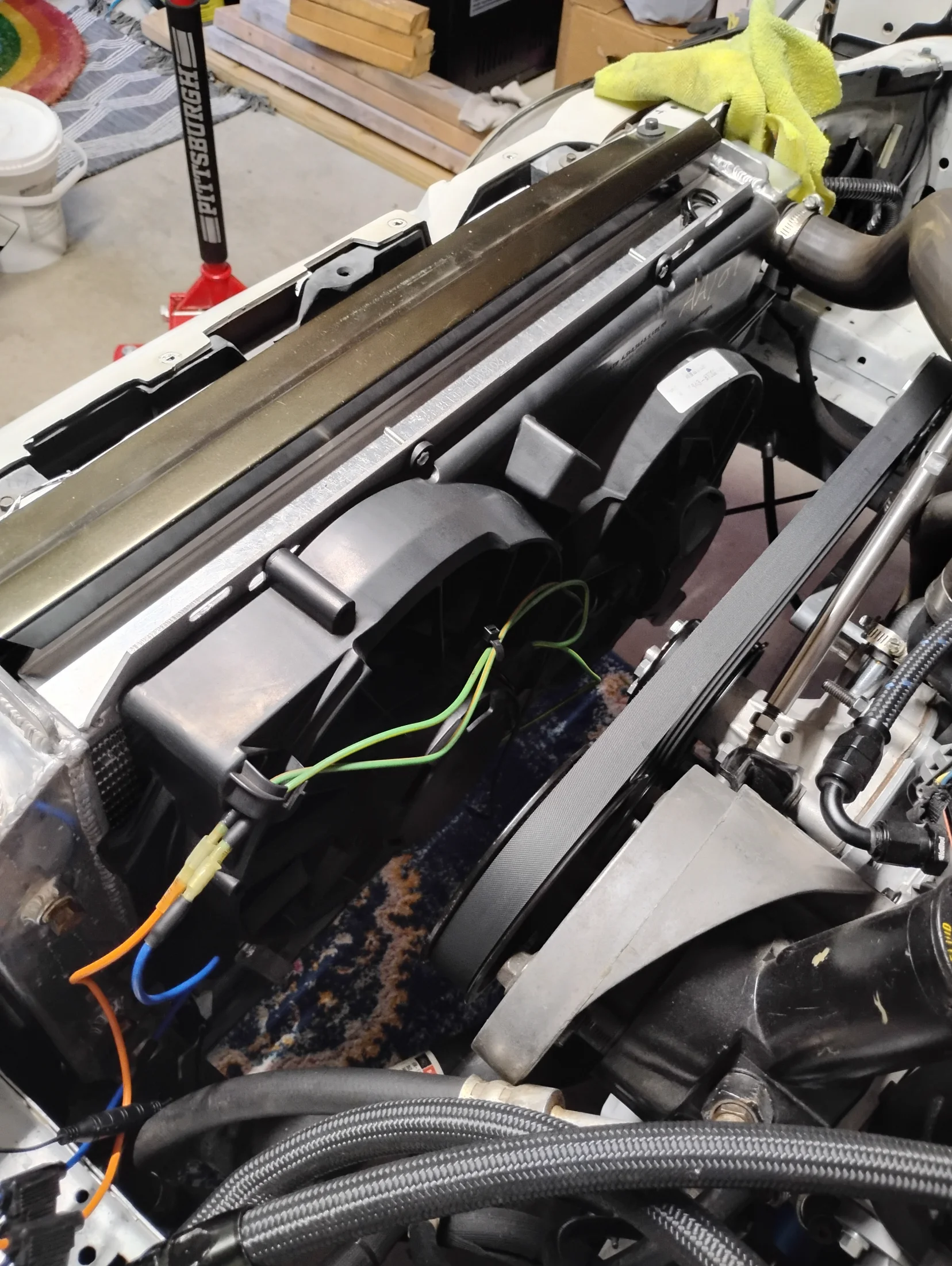

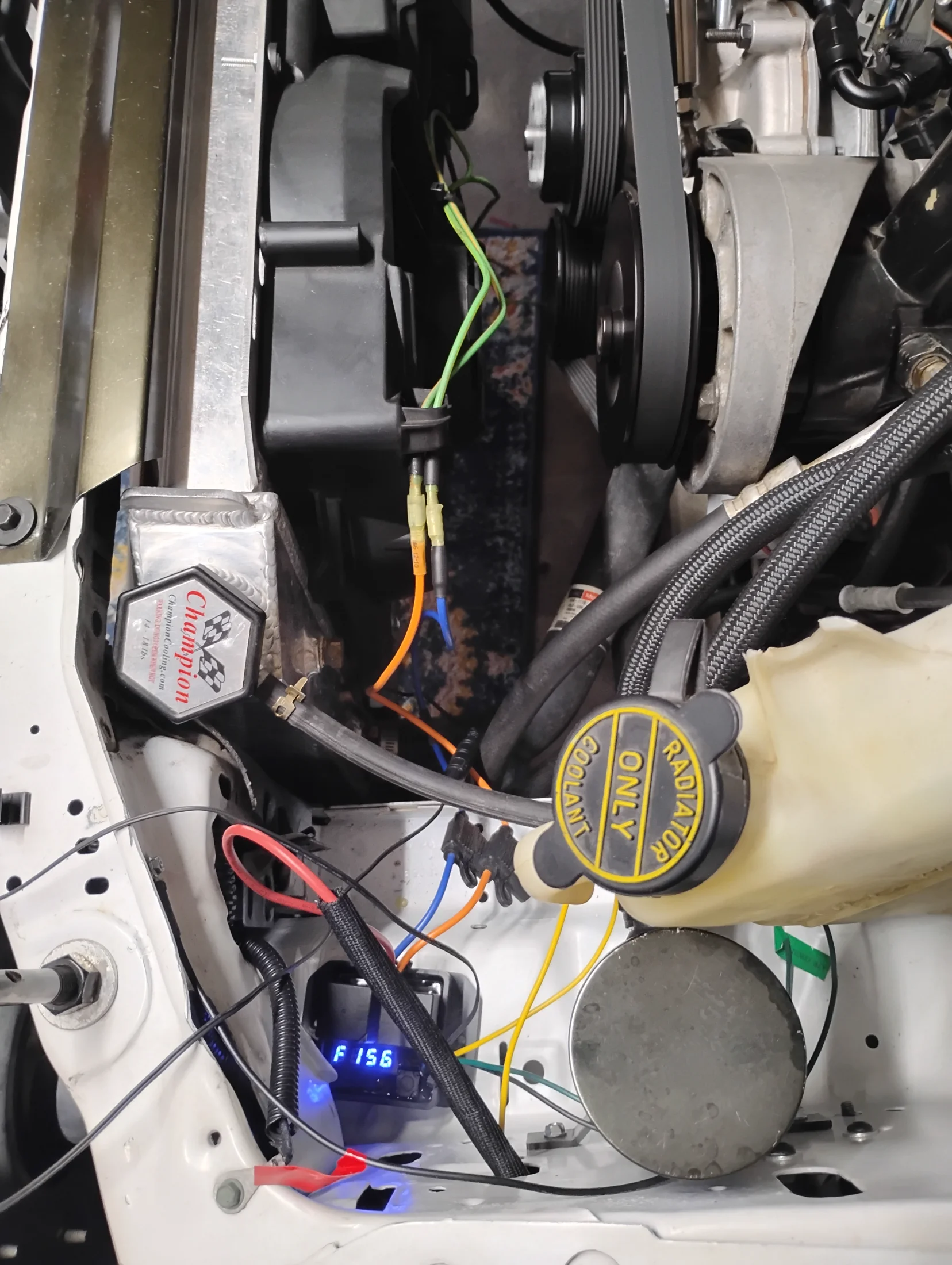

About to wrap cruising season up,and I decided to finally install the Focus fans I've had for over 2yrs. Fan body fit the radiator pretty well,with about a 3'" gap at the bottom. Was able to secure to the top of the radiator with the mounting bosses on the fan through the top channel on the radiator. Made some simple brackets from thin aluminum stock for the bottom mounts. Used the Davies Craig 0444 to control the fans. I tried to use the factory plug,but the yard cut the wiring for the male plug so short it wasnt happening. So I cut the plugs off and made my own wiring. Word of caution,tried those Soldersticks. Absolute garbage,couldn't get the solder to melt on three different tries. Ended up with bullet connectors with the shrink adhesive,worked great. To note,the red wire with yellow stripe on the drivers side is the easiest one for your ignition. I' m wire tucked so took a bit of digging to find it. Got that done and it was time to power it up. Set my turn on for 199* and started the car. I'll say this,car warms up much faster with no clutch fan,and thats a good thing. Watched the readout and once it hit 199* first fan kicked on,and 10secs layer fan two kicks on. Brought temp down 182* very quick. Let it cycle on/off a few times and shut her down. Now get the wiring cleaned up and figure out a new coolant reservoir bottle.

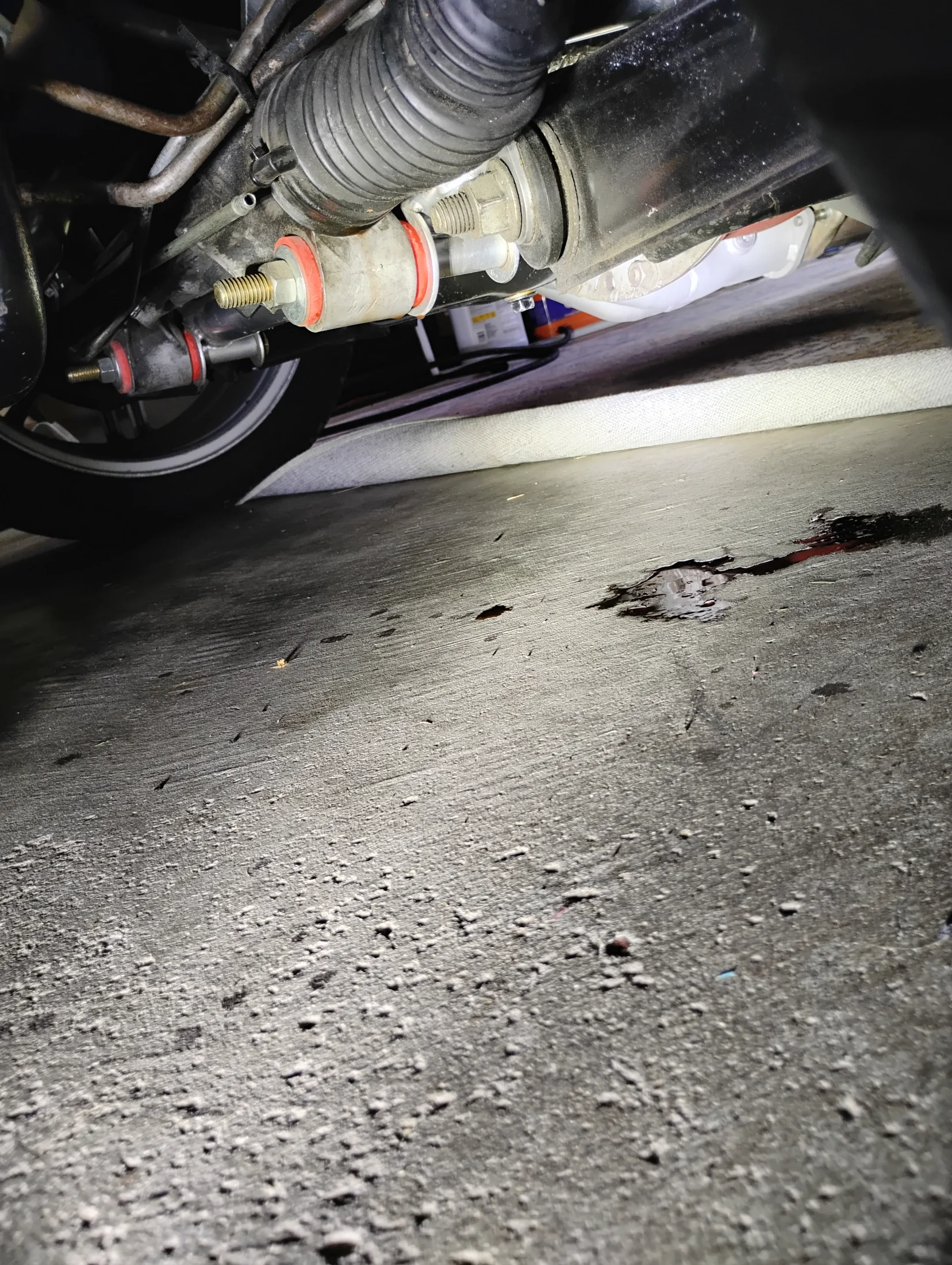

Hands down if it is the rack move on to a SN05 rack. Maximum Motorsports steering shaft:
You will need Fox inner and outer tie rods. Remove the SN95 tie rods off the new rack and install the Fox inner tie rods. This is all due to the inner to outer threads being metric on a SN95 and the overall length is too long for a Fox. Fox inner and outer are SAE threads so that will solve the problem. The threads on the rack itself are the same for SN95 or Fox inner tie rods.
The torsion bar in the SN95 rack is stiffer than the Fox rack so the feed back is way better in that you do not have that over boosted feeling.

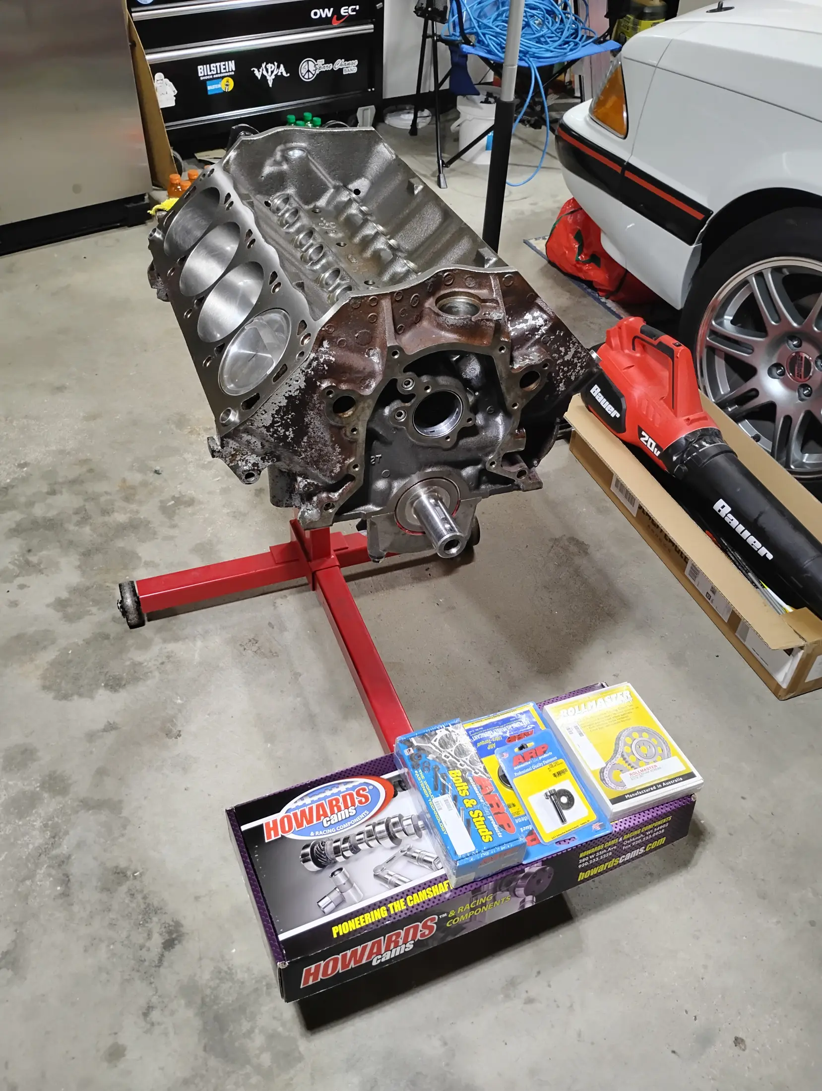

The 408 is back,and I have most of the parts to assemble. Just need rockers,pushrods and the swap oil pan. Now I need to paint this thing. Black,dark grey or maybe a bronze are what I'm thinking,but I'm open to suggestion.
