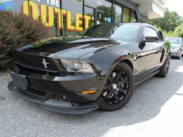

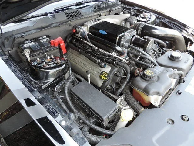

I am seriously considering a 2012 Stang (GT Cali Edition) which has the following. Quote from the ad "Over 600 HP, more HP than the Shelby GT500! Kenne Bell 2.9 LC Supercharger Engine with Granetelli Coil Pack ($13,200). Tokico Struts and Shocks with front control arms, rear upper and lower control arms, panhand bar and 3" lowering springs ($3,000). Brembo front brakes, 4 piston ($1,200). MagnaFlow 3" Competition Exhaust, Kooks long tube headers ($1,800). Rims and Michelin Tires ($2,500). Steeda Short Throw Shifter ($500) and the list goes on!!!"
So as a Fox Body 351W swap owner who has been involved in drag racing since a kid I'm wondering if the stock coyote bottom end can handle this type pf power. I am trying to get info as to whether or not there was work done to the bottom end (forged internals, girdle, etc)
Also, will the transmission be able to handle this power? It's a 6 speed manual.
The stock 5.0 coyote engines will certainly take quite a bit of abuse and with the modifications that you described are more than capable of laying down 600hp. They are built well from the factory and in that 600hp range you shouldn't have much to worry about. Guys like @Sharad are making that kind of power, turning 10 second times at the track and driving them hours and hours each way to get there. As far as the transmissions they have seemed to hold up well too. These cars are leaps and bounds from what anyone could have imagined back in the fox body days.

Ok so the questions I have for the dealer
1) what info do you have on the custom tune? What shop did the work? I've been told that the wife of the former owner works at the dealership so she should have info and paperwork
2) why is there no boost gauge in the cockpit - I can't see any boost gauge in any pics.
