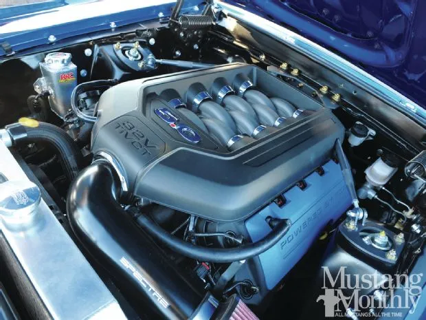

There are other considerations than just width to take into account...namely, Coyotes are rear sump...early Ford engines are all front sump to account for the steering linkage...its no big deal to fabricate/modify an oil pan and pickup to change from front sump to rear sump....but you still have to clear the steering linkage....which means a higher than ideal engine mounting....which in turn means tranmission tunnel modifications....the 3.7L also fits between the shock towers...but I ended up having to cut out the stock transmission tunnel and graft in one from a 2010 Mustang to fit the transmission at the correct angle. You may be able to get away with just some minor tunnel mods with a 71-73, but I am willing to bet you won't get away without modifying it to some degree assuming you are using a MT82, the ATX the Coyote uses, or even a T56
