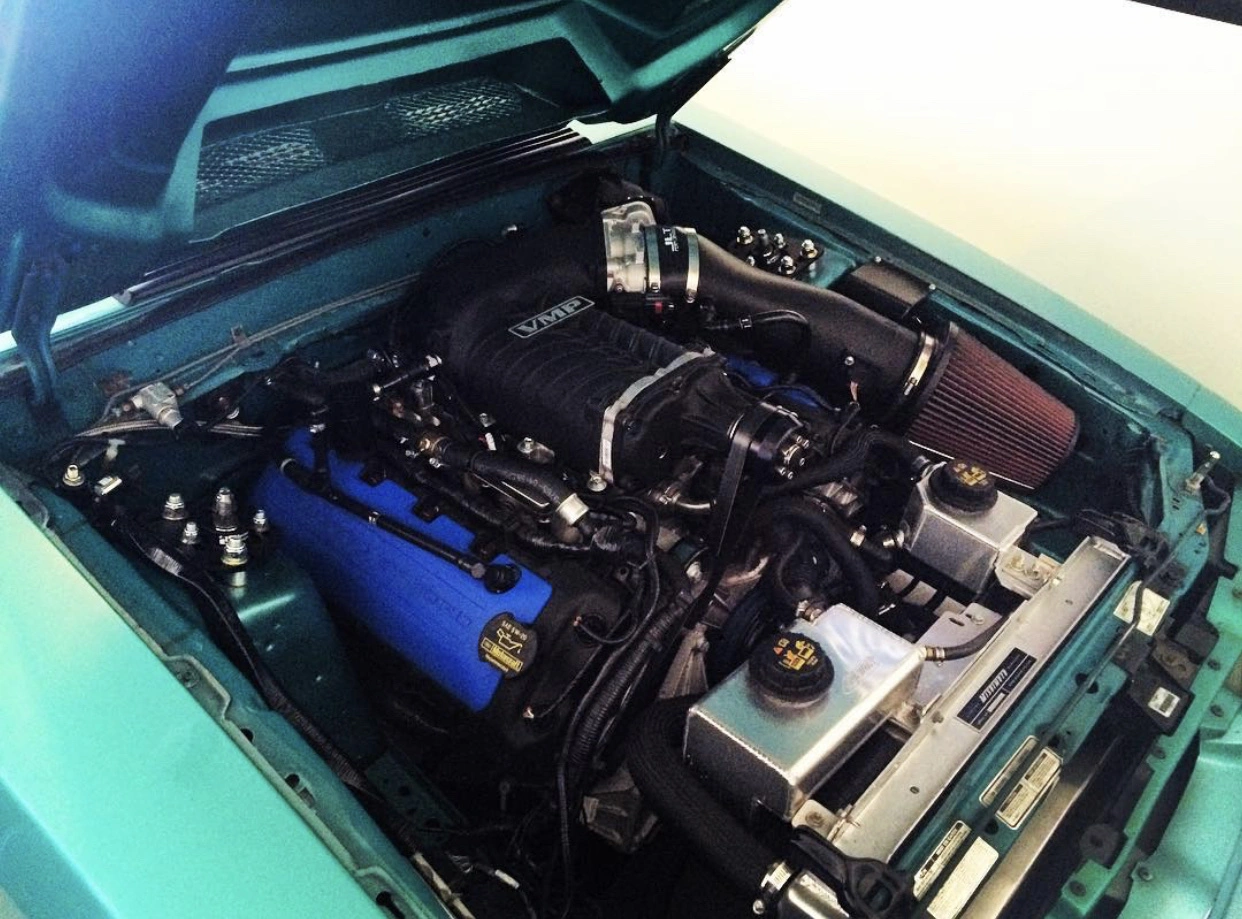

The original car I did we used the aje k member and it was great . We also used a stifflers transmission crossmember . Scram speed gas pedal bracket . Bbk long tubes and X pipe for the swap . This was a gen 1 engine and control pack . Used stock fuel rails and then AN adapters and ran our own fuel lines and fuel System in preparation for a supercharger which it did get .

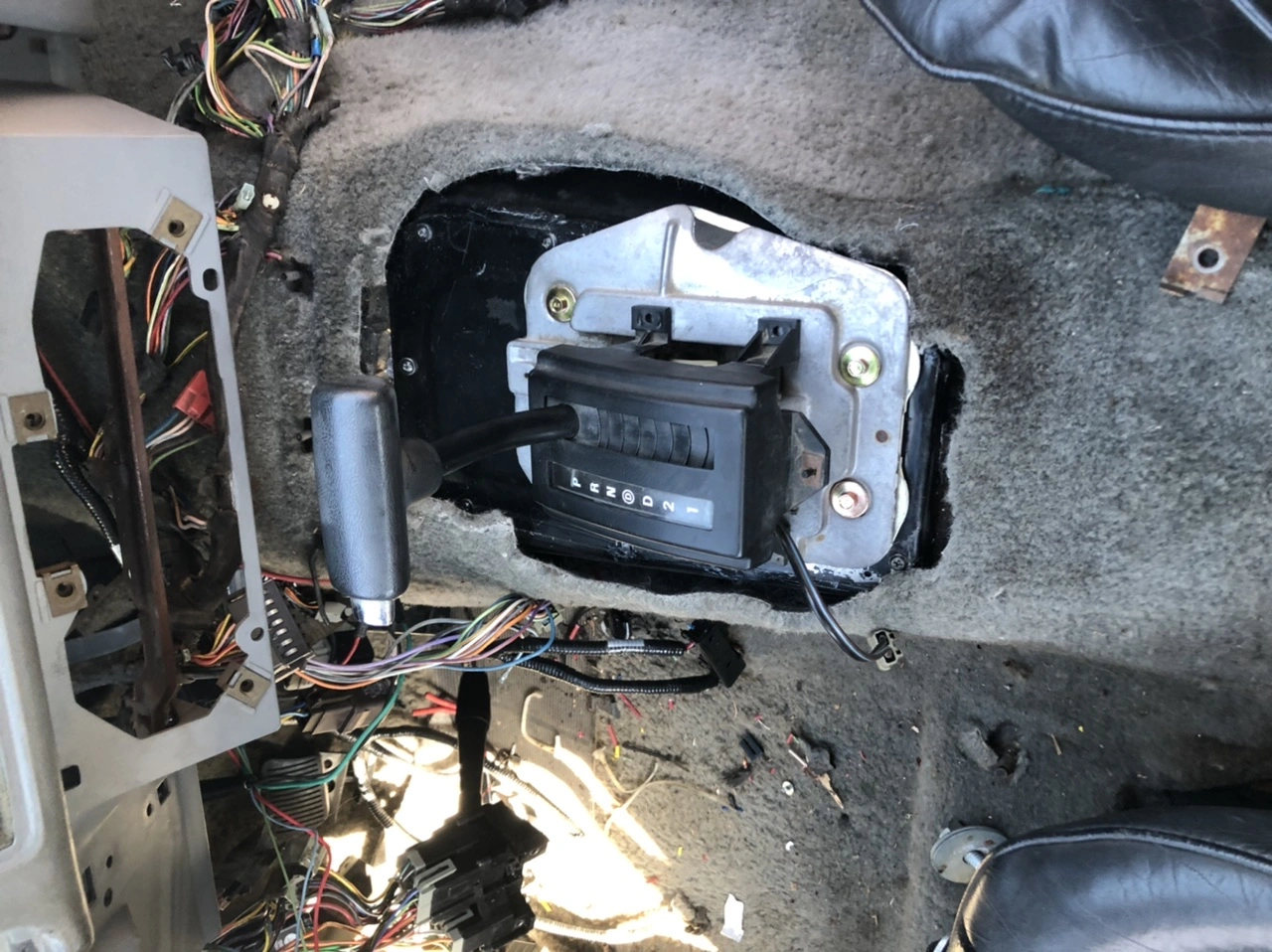

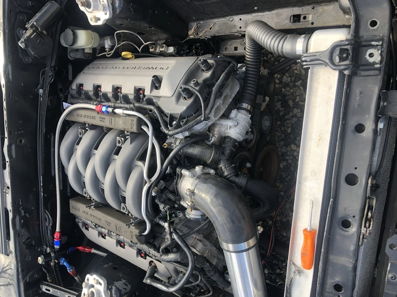

The car I’m doing now has a Team z k member. 6r80 auto with a stifflers crossmember . Hooker stainless long tubes . MM steering shaft . GEN 2 engine and control pack with transmission control . Using a fox shifter , sn95 shifter cable and Power by the hour bracket and shift stop . Same thing for fuel system - adapter fittings and all an lines and a pump with a cell . ( used to be a race car . ) This one came to me motor and trans in already but a mess . So I am getting the wiring re done and fixing all the odds and ends to make it a street car .

Calypso car was the one we did in 2013 . No expense spared .Black is the one I’m currently slowly fixing now .
