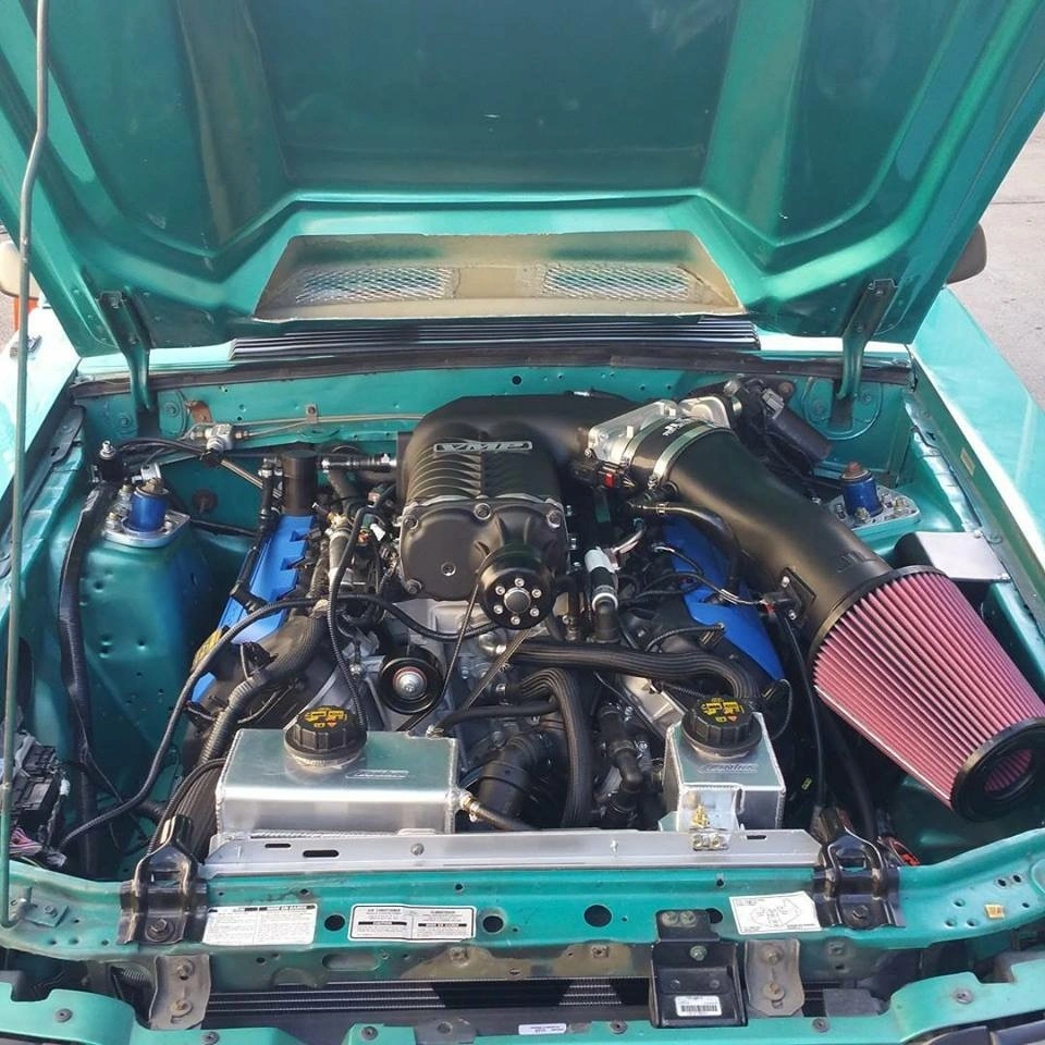

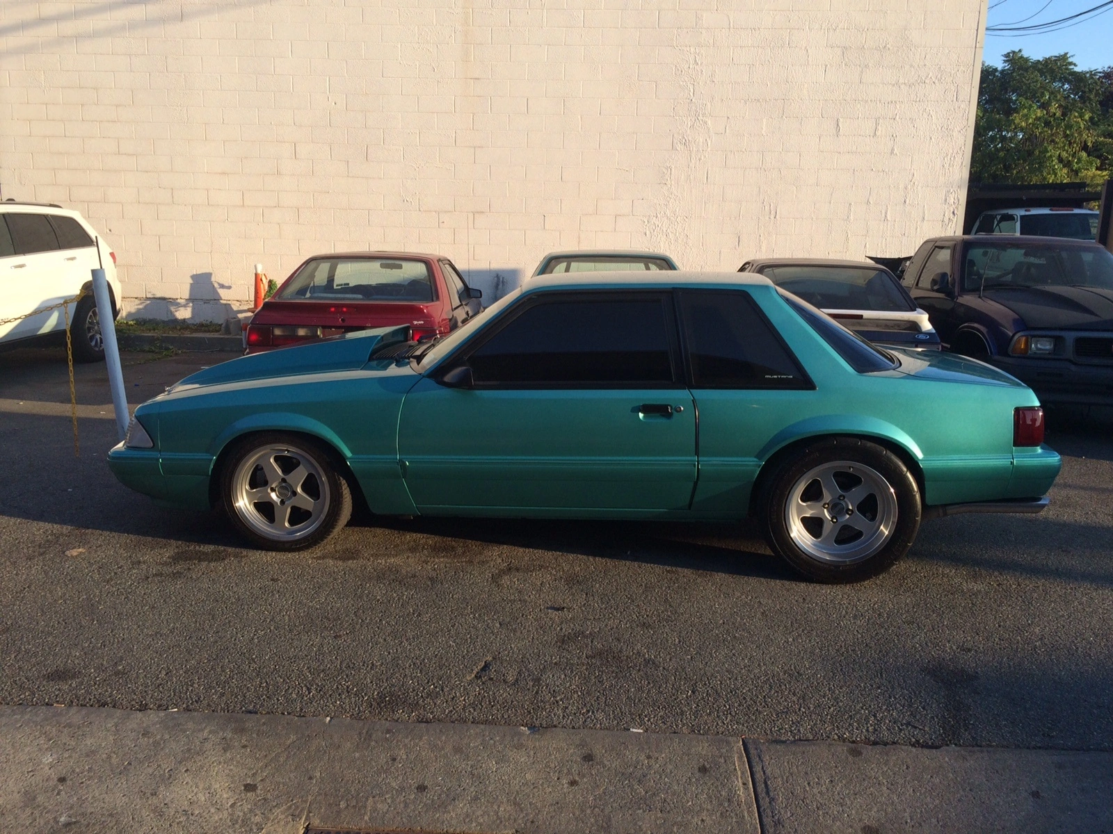

I did one in 13 . Deleted the thread for personal reasons but it was a gen 1 t56 with a vmp calypso coupe that we oringally had a 468 BBC and th400 we put in it . At the time it was like 3rd or 4th car ever on the internet I knew of being done.
I just finished up a gen 2 , 6r80 car that was an ex race car wiring nightmare - came to me swapped and running but you had to hold wires together and nothing worked inside the car . Left with factory gauges working and everything in car working less the speedo because he wouldn’t buy the adapter box , fuel gauge because it has a cell , and Volvo electric pump with hydro boost and PS .

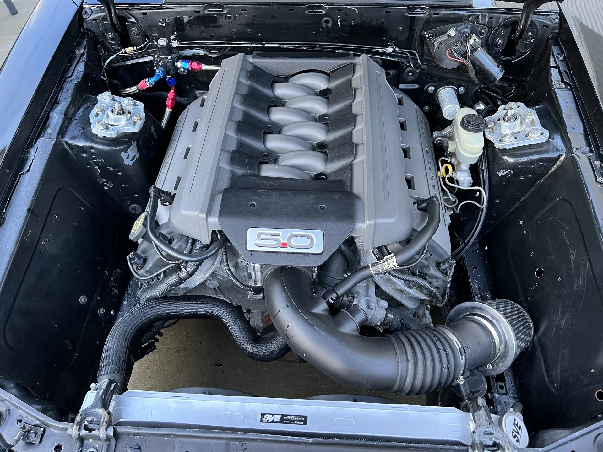

Maybe so, but now there's two posts (including mine) which have done a swap. Just finished mine in my '02 GT with a Gen1 that I took out of a salvage title 2013 GT. Factory tune, my stock gauges and dash, my 3650 and all is good. No issues. Used PBH drive setup and have my factory AC to boot!
