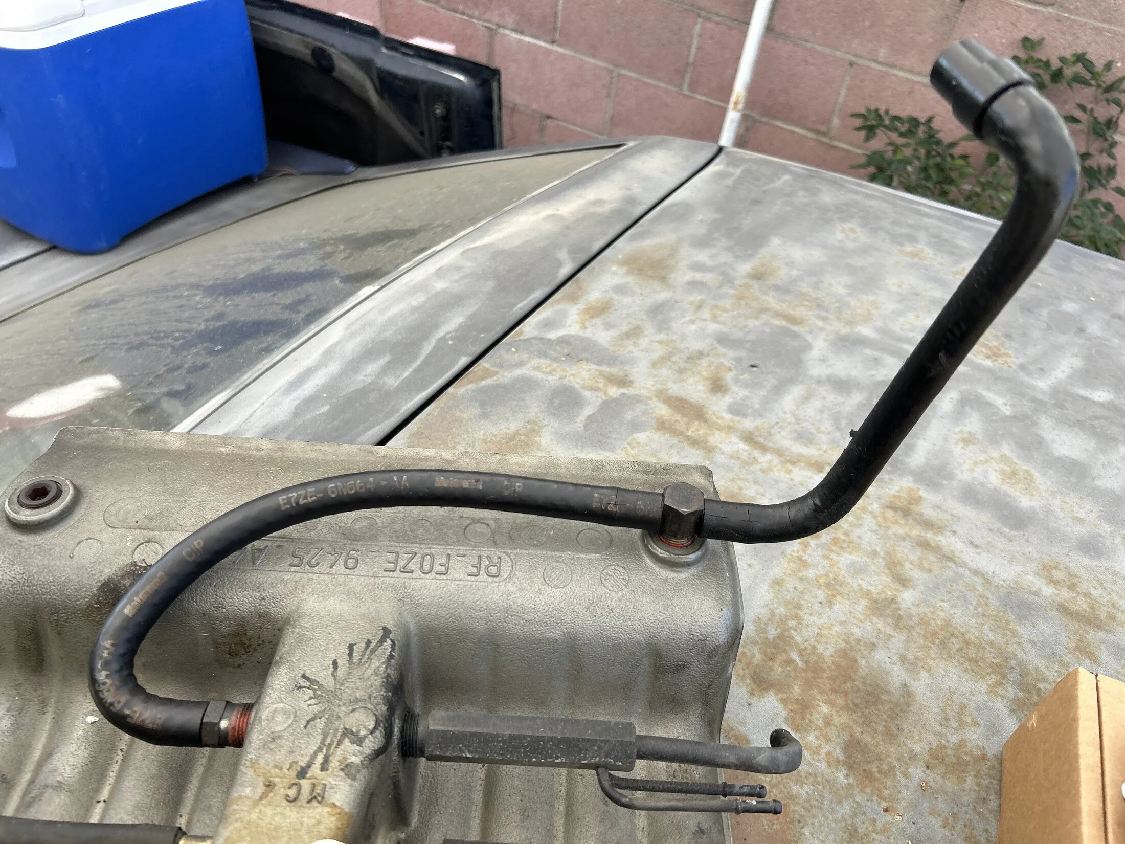

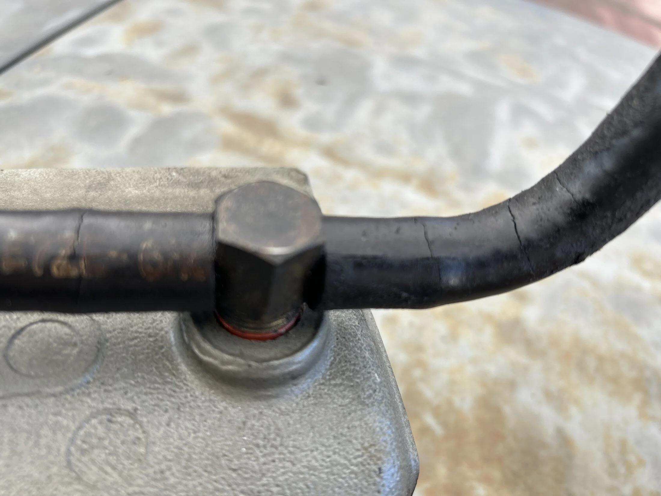

A Artemisia22 Member Jul 6, 2022 22 1 13 Ontario Dec 2, 2023 #1 Dec 2, 2023 #1 anybody know where to find this tubing? Both ends are cracked. Tubes are found underneath the upper intake
evintho 20+ Year Stangneter Nov 12, 2003 683 246 73 Santa Rosa, CA. Dec 2, 2023 #2 Dec 2, 2023 #2 The actual PCV hose from the 'T' to the PCV valve can be found here..... https://lmr.com/item/LRS-6664A/1986-95-Mustang-50L-Pcv-Valve-To-Upper-Intake-Hose The second half of the hose, from the 'T' to the fitting on the bottom of the manifold, may be harder to find. This looks like it may work, though......... https://www.autozone.com/emission-control-and-exhaust/pcv-valve-hose/p/dorman-pcv-valve-hose-46033/319386_0_0?spps.s=3333&cmpid=LIA:US:EN:AD:NL:1000000:HRD:19489353553&&CATARGETID=120054150001290089&CADevice=c&gad_source=1&gclid=EAIaIQobChMI4qT3zsjxggMVnF1_AB2D1gBSEAQYBiABEgLr5PD_BwE&gclsrc=aw.ds Reactions: General karthief
Kid wita 5oh I'm definitely not in the original hole Founding Member Nov 5, 2000 1,415 154 93 Saugus, MA Dec 2, 2023 #3 Dec 2, 2023 #3 Or just go to your local parts store and buy hose for WAY less ...

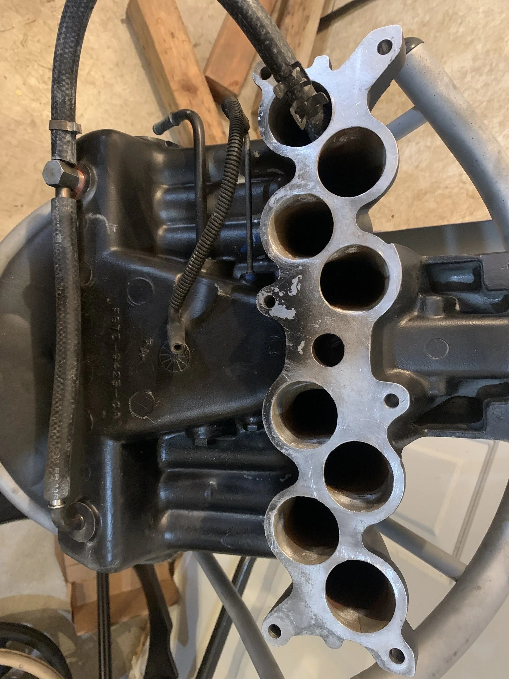

Rdub6 So while I wait to figure out my rear end issues 5 Year Member Dec 29, 2017 3,975 2,956 153 Long Island, NY Dec 2, 2023 #4 Dec 2, 2023 #4 I’d be concerned with the bend going into bottom of the manifold. Just a regular length of hose will definitely kink after a while at that point. Reactions: Artemisia22
nickyb I gotta say i never painted my nuts, Never Ever 15 Year Member Apr 3, 2009 3,060 1,675 163 nevada Dec 2, 2023 #5 Dec 2, 2023 #5 You could put a short hose with a 90 elbow then the straight hose so you won't have Kinks. Reactions: Artemisia22, Rdub6 and General karthief
Kid wita 5oh I'm definitely not in the original hole Founding Member Nov 5, 2000 1,415 154 93 Saugus, MA Dec 3, 2023 #6 Dec 3, 2023 #6 Rdub6 said: I’d be concerned with the bend going into bottom of the manifold. Just a regular length of hose will definitely kink after a while at that point. Click to expand... Just need a longer sweep of the hose(still contained under the plenum.) and it won't kink Reactions: Rdub6
General karthief wonder how much it would cost to ship you a pair Mod Dude Aug 25, 2016 28,134 10,752 213 polk county florida Dec 3, 2023 #7 Dec 3, 2023 #7 Cozy up to a parts counter person at your local auto parts and find a hose with one end at 90* and enough length to reach the nipple at the plenum. Reactions: Artemisia22 and limp

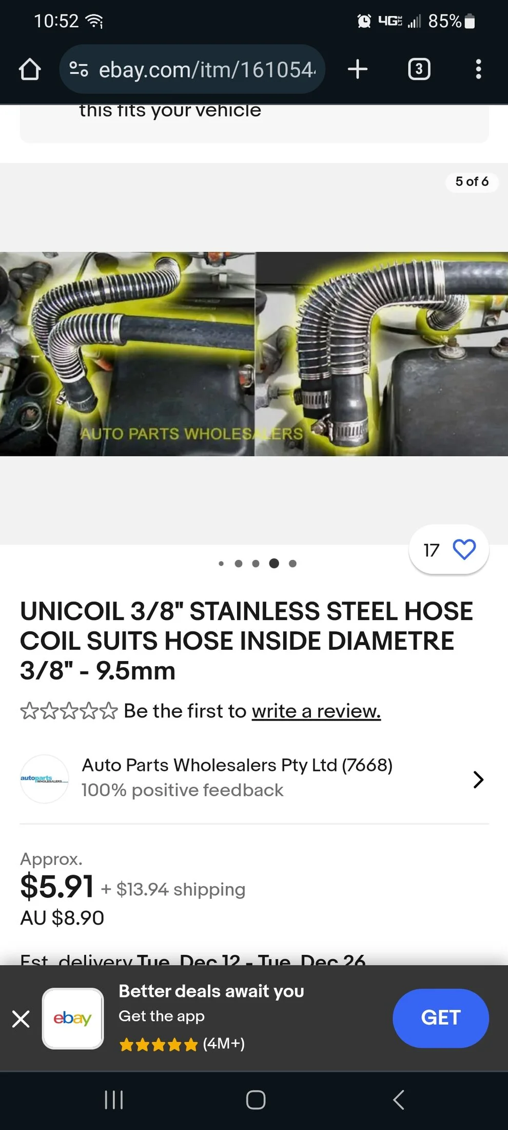

90sickfox Wasn't a pretty sight...and I've got big hands SN Certified Technician Mar 2, 2015 6,953 5,831 213 Dec 5, 2023 #8 Dec 5, 2023 #8 You just need one of these on a new regular hose. Keeps it from kicking. Reactions: Artemisia22, nickyb, Rdub6 and 1 other person

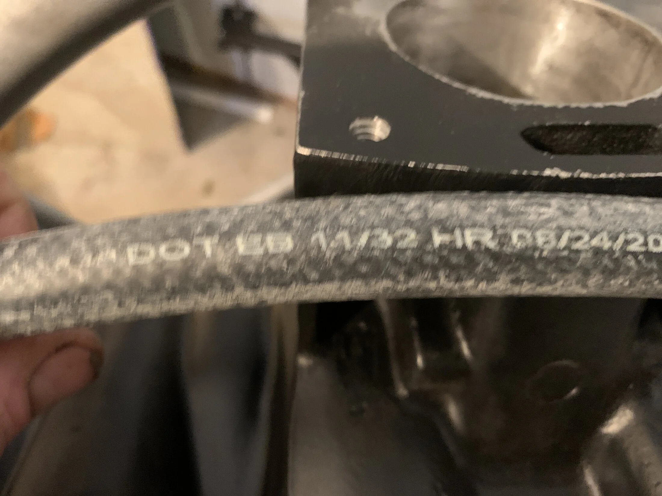

5 5.0Link Member Jul 3, 2021 6 6 13 Canada Dec 9, 2023 #9 Dec 9, 2023 #9 11/32 vacuum line. Parts store had it over night. 5’ did pcv, main tree and all under neath upper intake. Just cut all that hard cracked crap off Last edited: Dec 9, 2023 Reactions: Artemisia22, 90sickfox, General karthief and 1 other person
Mustang5L5 That is…until I whipped out my Bissell Mod Dude Feb 18, 2001 43,376 18,123 224 Massachusetts Dec 11, 2023 #10 Dec 11, 2023 #10 Is that emissions/fuel line, or standard vac hose? The latter won't stand up to the oil that will be drawn through the system. Reactions: Artemisia22
A Artemisia22 Member Jul 6, 2022 22 1 13 Ontario Dec 28, 2023 #11 Dec 28, 2023 #11 Thanks to everyone who replied, I ended up using fuel line for the pcv valve connection and I’m just gonna end up running the other hose I’m swapping the 5.0 over to a 5.8 EFI, just wanted to get this baby to pass smog before doing so Reactions: Rdub6
