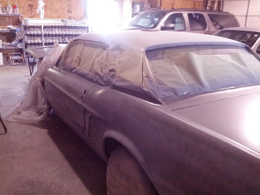

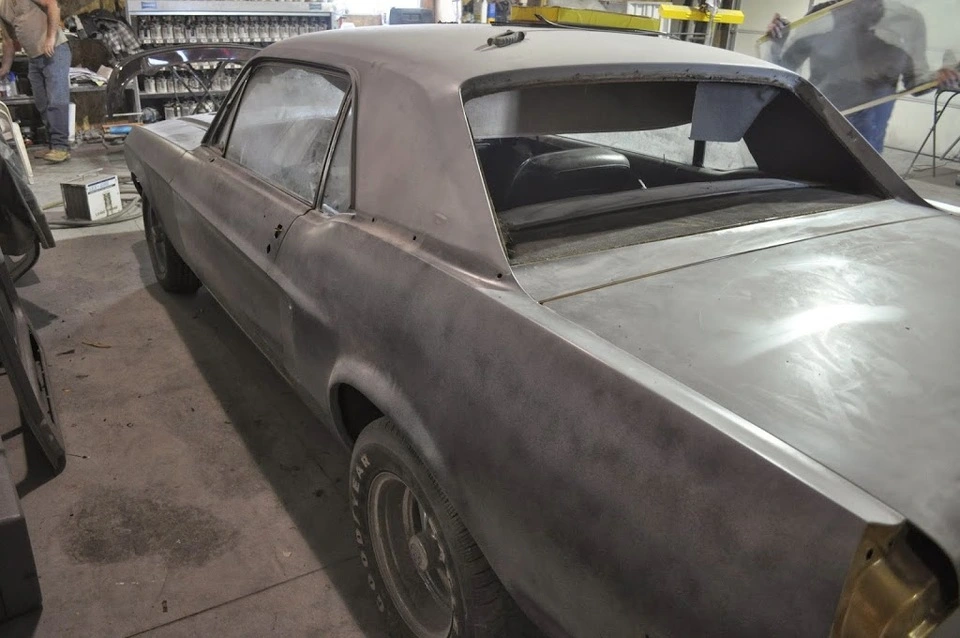

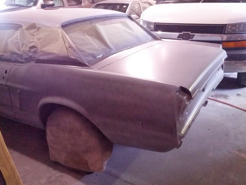

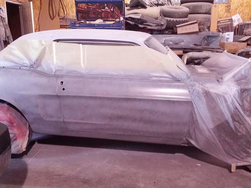

More progress! The paint and body guys spent some more time on it, and for the first time in a very long time, this car is the same color for the whole exterior. (ok, well perhaps not for the roof where the vinyl will go!)
Super excited! We will be pulling the glass soon, and the doors will be removed to paint the car. The jams and such will get painted too. Should be done pretty soon now!

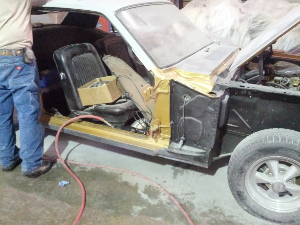

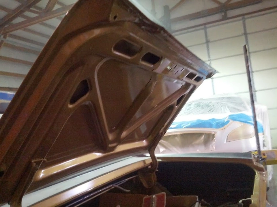

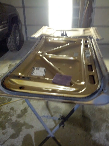

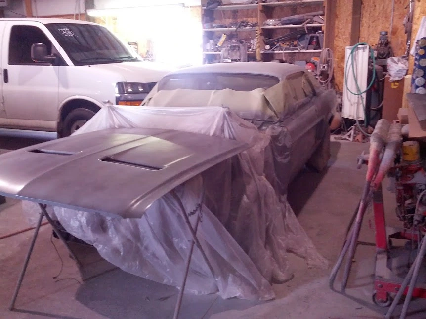

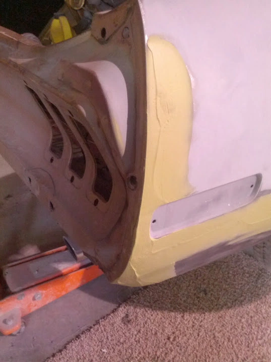

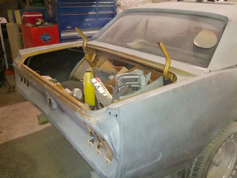

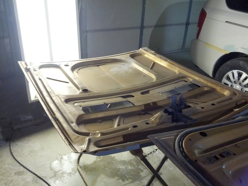

Got the trunk of and an prepping it. (well not ME, the body guys)
Old weather seal is so brittle you can crack it by touching it.

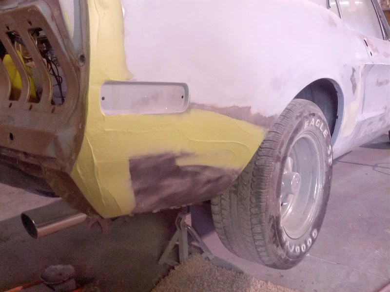

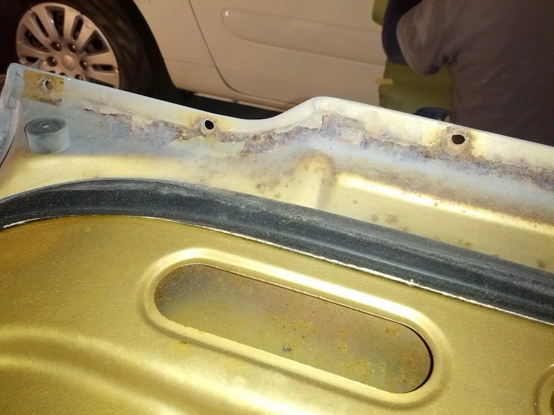

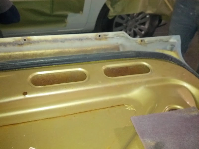

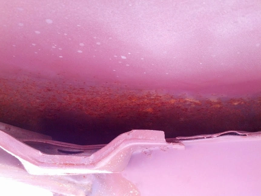

A bit of surfacy rust was found under the trunk lip. We will grind into it and see what we find and decide what to do when we know more.
Also scraping off all the crap underneath the adhesive. Fun fun.

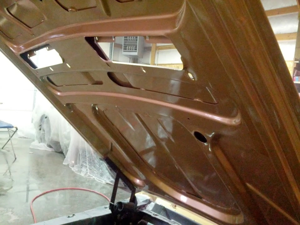

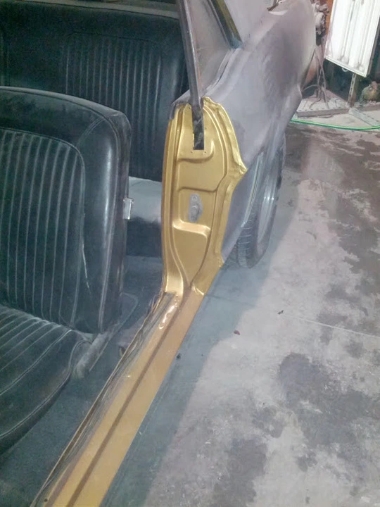

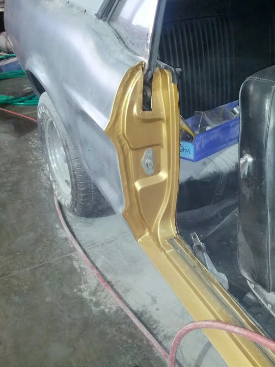

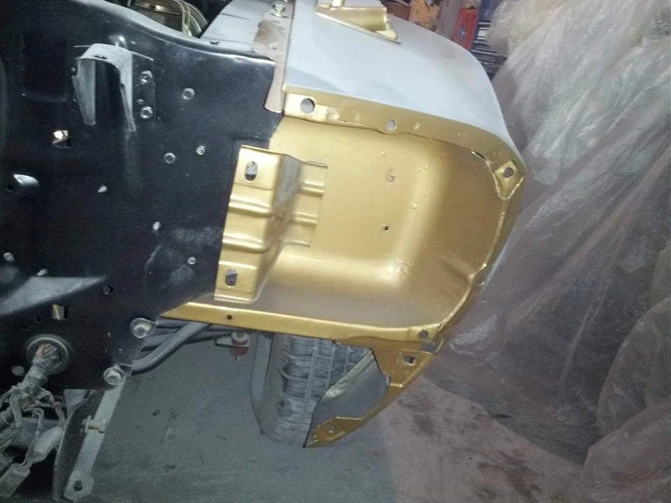

The paint guys have been busy. All the jams have been sprayed and cleared, and now they are back to bolting stuff onto the car. I spent a bit of money at the hardware store investing in new zinc plated hardware to bolt everything back up. Wow it's crazy how much more flange bots cost then hex bolts. Still, they have a really nice look that I like.

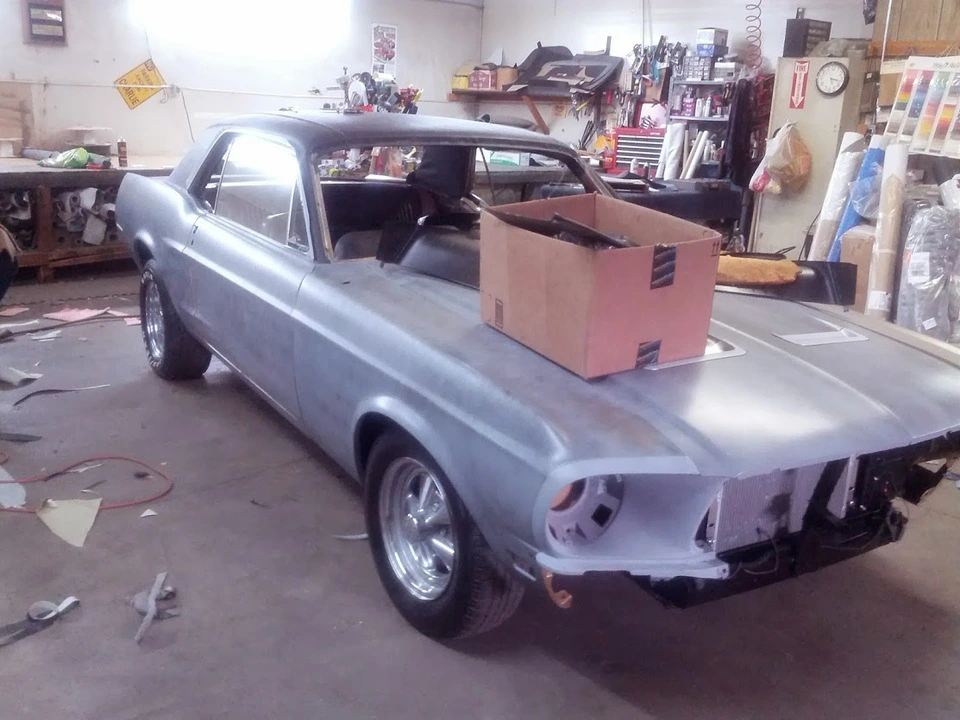

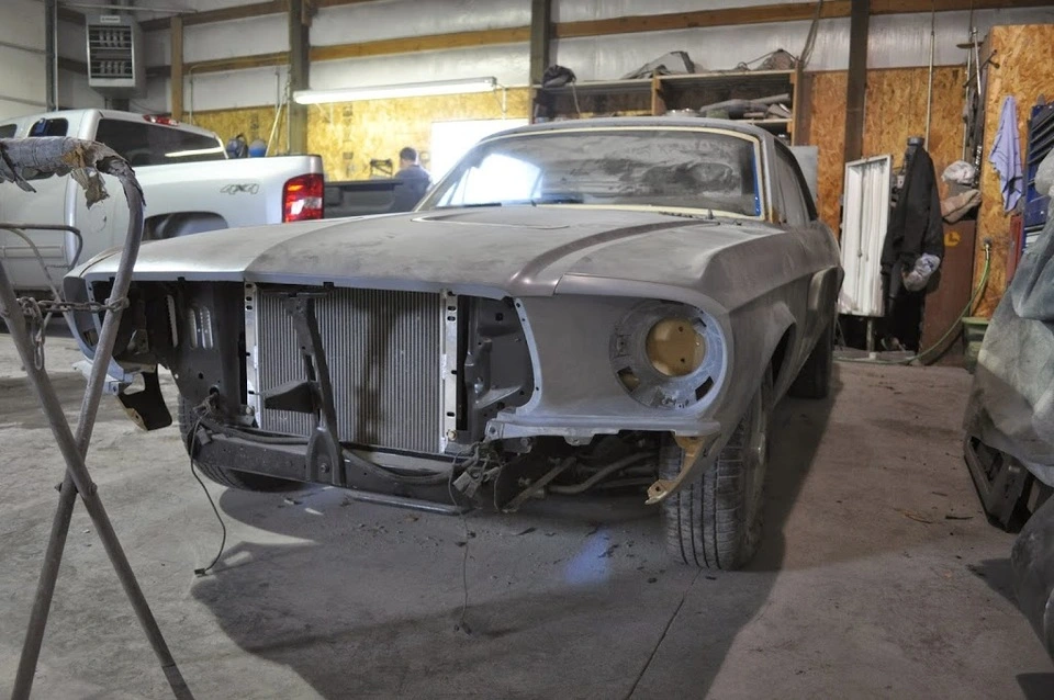

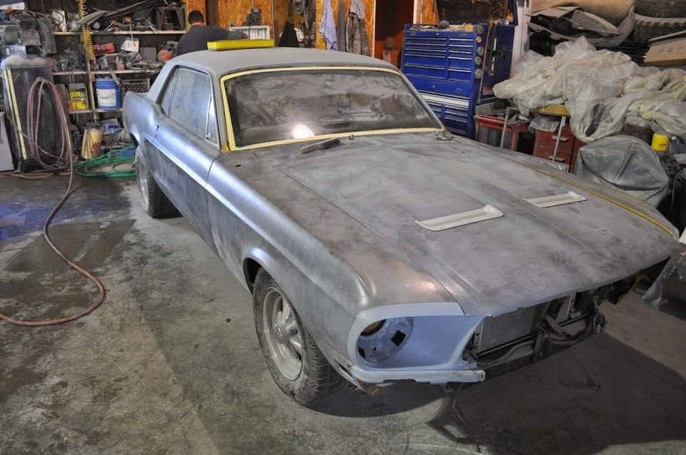

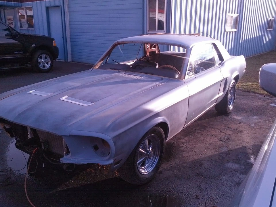

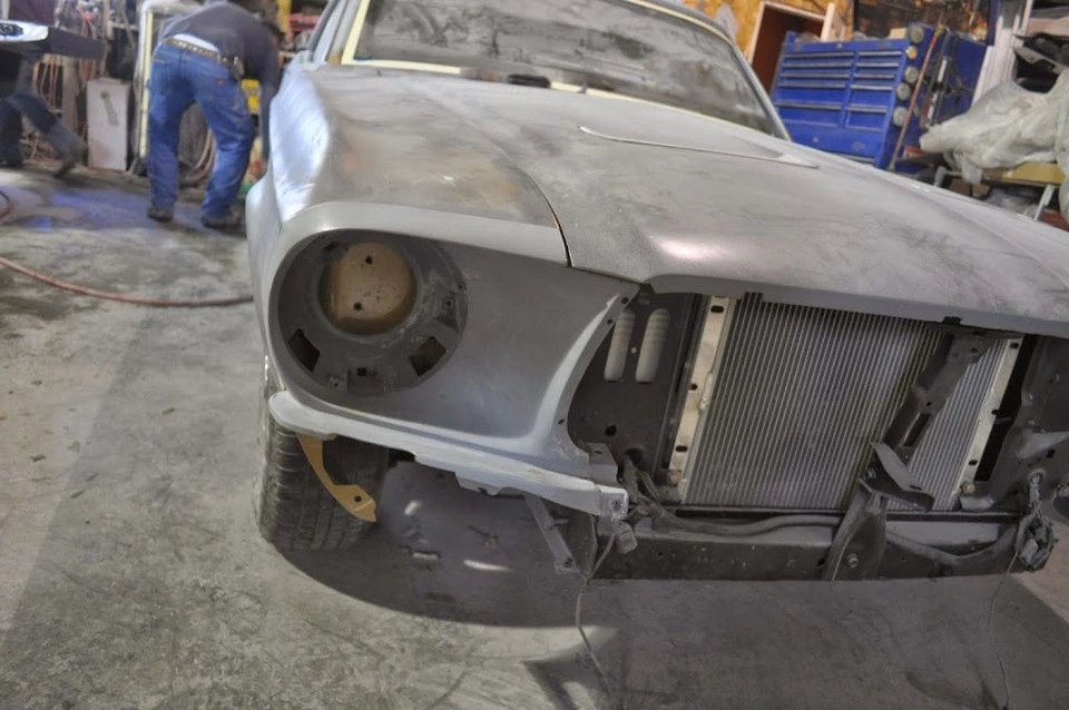

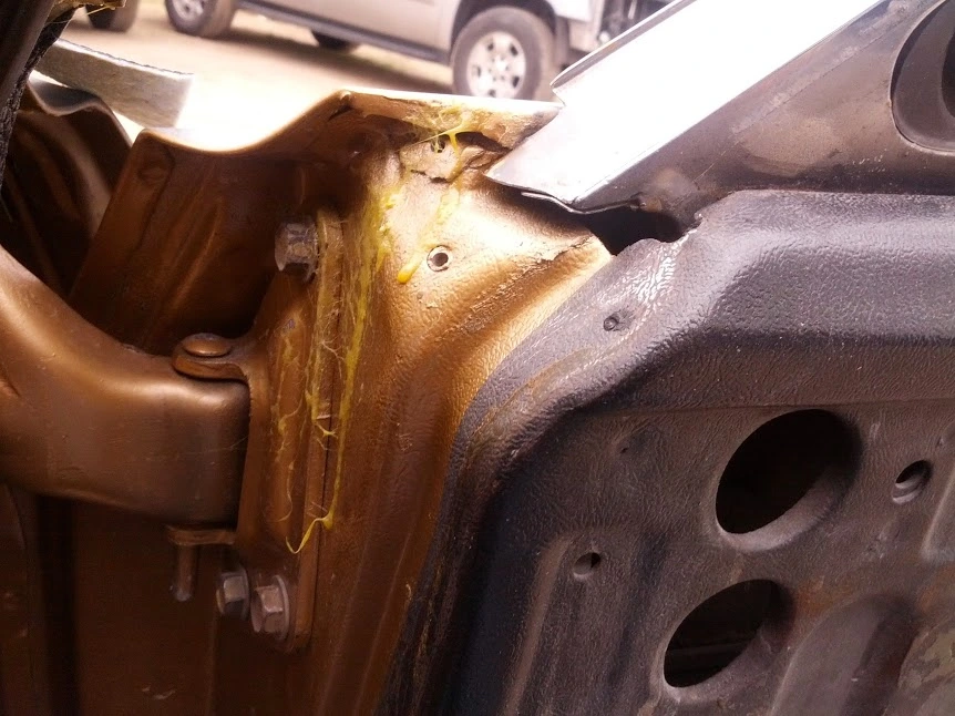

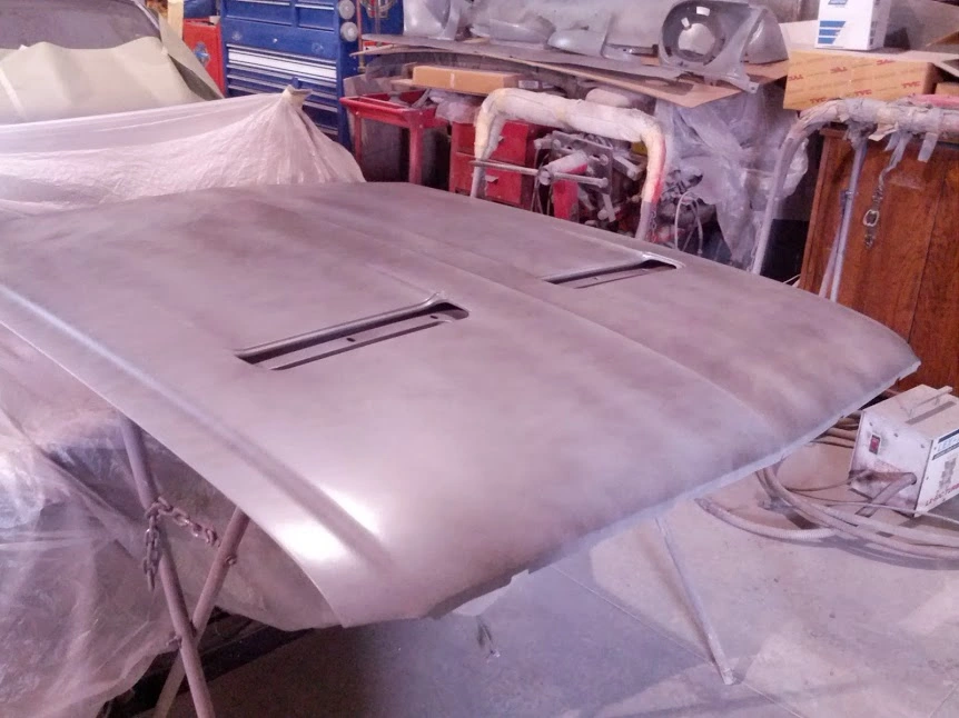

Today we did some more fitting for the fenders and hood. We also got the glass out and started to clean the glass channels. Does anyone know a good way to clean those out really good? I was thinking of getting a wire wheel for it.

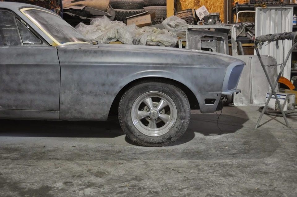

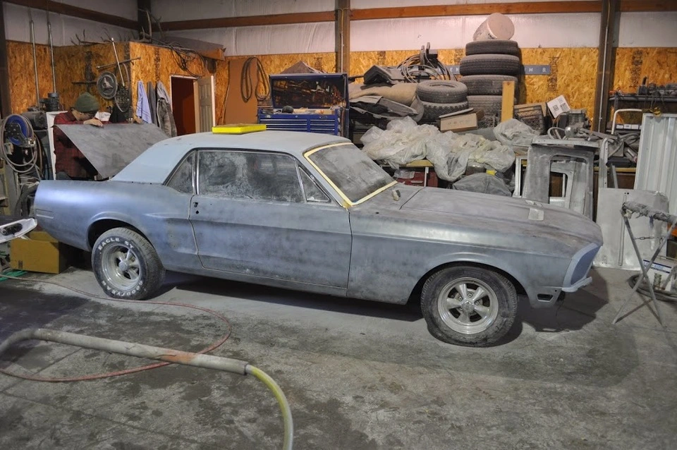

Now that the fenders are on we can start to see the new stance. Keep in mind it is fully adjustable with the Rod & Custom front end, so I can move it where I want. What do you think? Move it up a hair? Lower? Just right? The nice thing about the kit is you can do pretty much whatever you want when it comes to stiffness and ride height. It may take some tweaking to get it perfect.

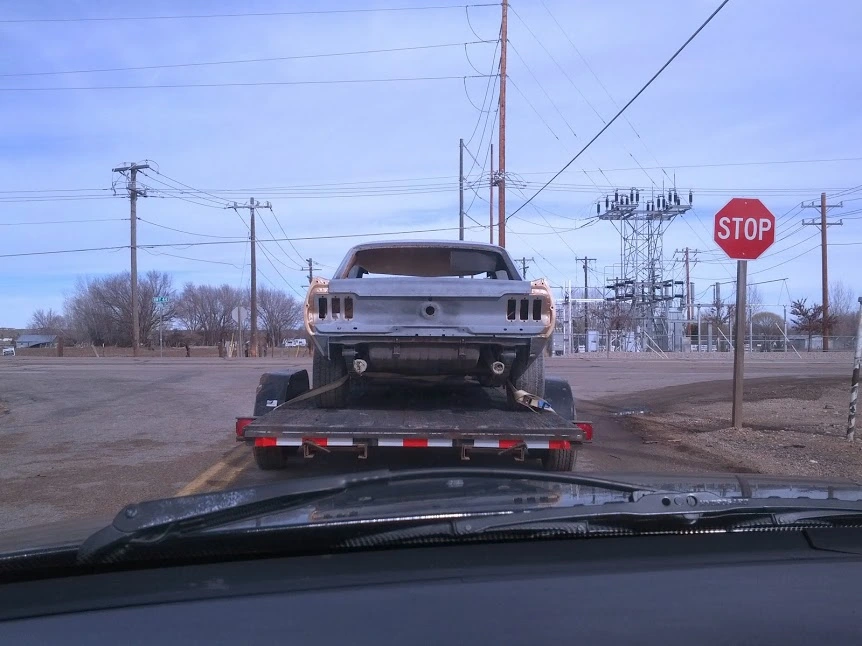

We decided to go ahead and have the vinyl top and headliner installed before final wet sanding and paint. Tomorrow we will put it on the tailer and take it in. The are installing the headliner and vinyl top for $750 which includes all materials. They are also not using a kit to make the top, they will create the seams themselves.

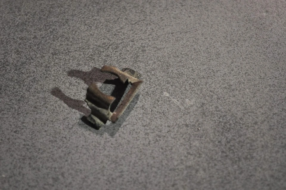

Oh, and these supposedly go underneath the front fender and is some sort of fastener. Trying to find another one. Anyone know the name?
Ford used a couple types of sealer around the windows, one is a black caulking that usually hardend like a rock over the years .The other was a sealer that looked like very thick grease ,uh also very messy. A wire wheel works best to remove the black sealer ,but the sealer like grease will smear all over the place if you don't scrape it away first. A little lac. thinner on a rag will clean it up then a wire wheel will finish it.Watch out for flying wire from the wheel,wear some goggles .
The clip is the one that mounts the fender under the rocker .It slips into a square hole under the rocker .There is supposed to be a square nut swedged in it ,they are usually broke or break after you remove the bolt.

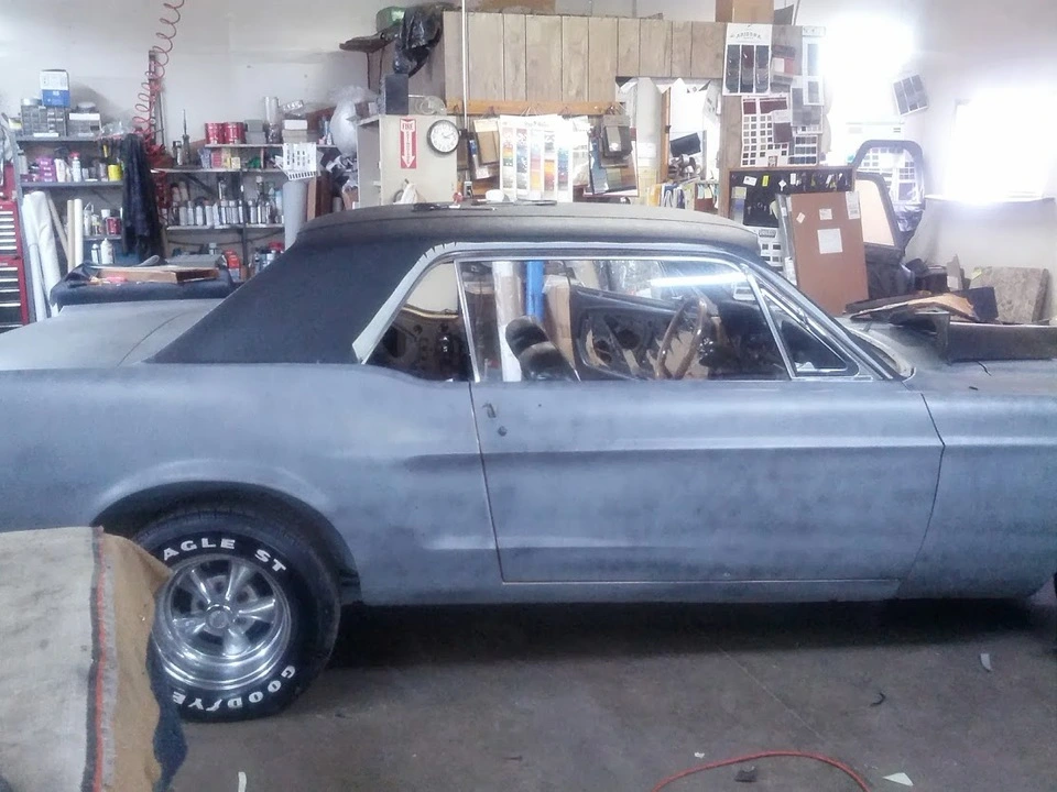

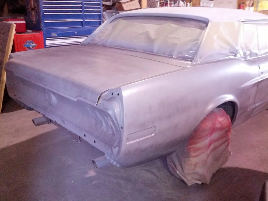

Moving on! We decided that the vinyl top and headliner should go on before final paint, which is probably a good idea. The upholstery guys agreed, and said they could squeeze me in mid next week. We went ahead and loaded it up and hauled it over to their place.

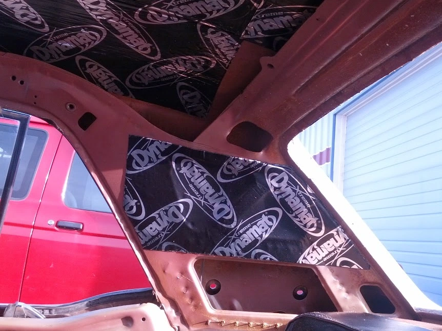

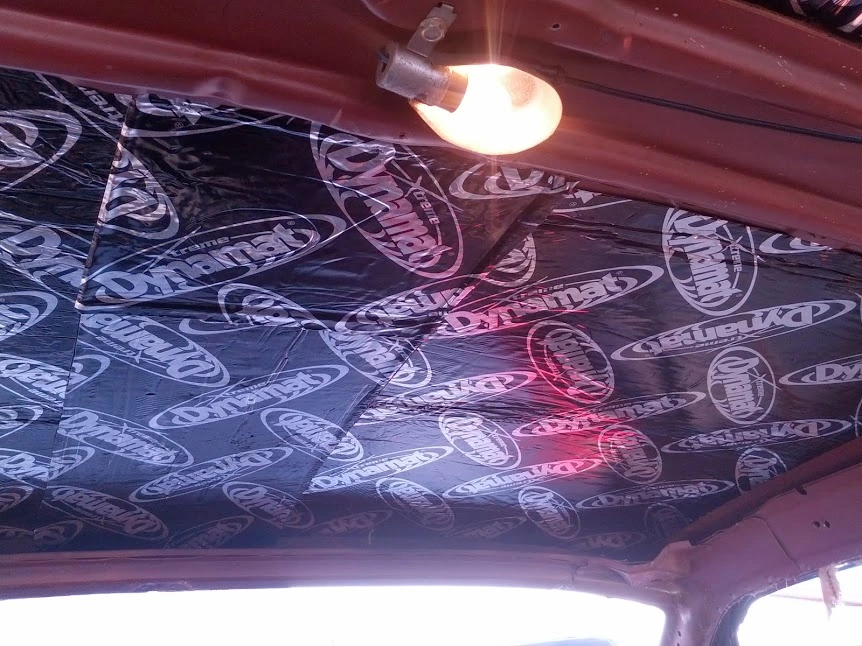

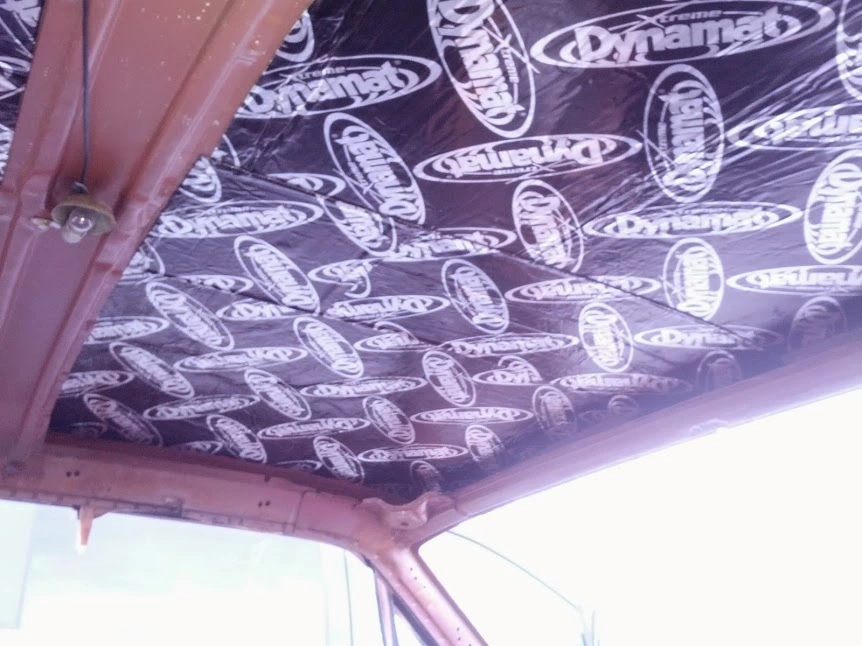

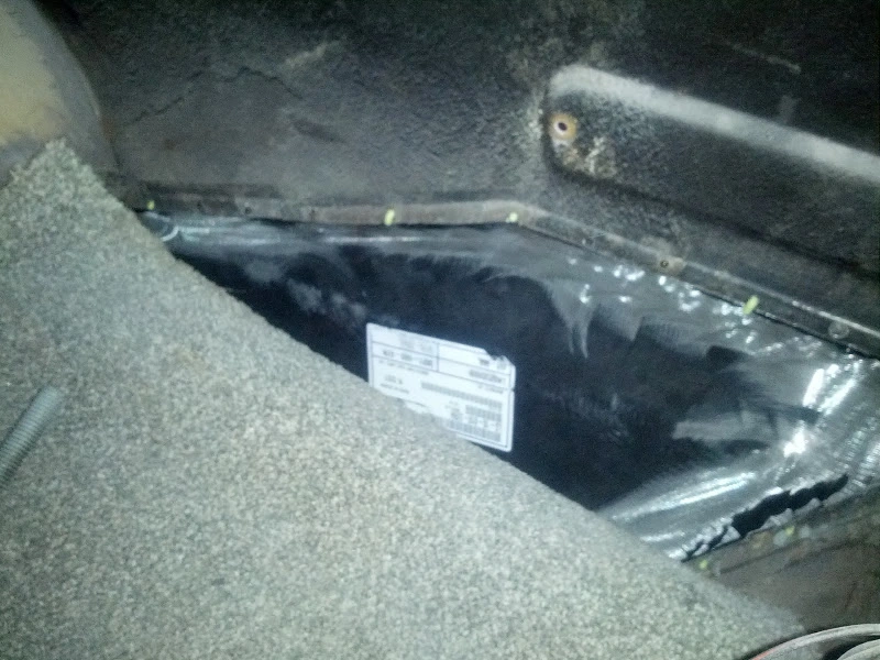

Before the upholstery guys install the vinyl top I wanted to install a sound deadener.
First off I better specify my goals- while I do plan to put a high end modern stereo in it, this isn't so I can have competition sound. I mainly just want a nice quiet ride (taking into account the car IS actually a classic Mustang) and a good "thud" when I shut the door. Sound deadeners seem to improve the feel of a car in weird intangible ways. Thats what I'm going for. I do not require 100% coverage.
I ended up choosing Dynamat for a variety of reasons. First off, I don't really think there is a huge difference between all of them. I'm sure you could get all technical and get in a huge debate over the Dynamat / Fatmat / Peel & Stick debate. I don't really buy into it. I'm sure there are some cool physics behind it, but for the guy like me it probably all is pretty much the same.
I have heard, however, that Dynamat tends to be more sticky then the others, which is why I chose it. Since it is going underneath the headliner, I wanted to make sure it would stay for good. To fix it I would have to pull my headliner, which means also pulling the windows...and I don't want to do that. A few extra bucks is cheap insurance. Also...I can now say that my car has "Dynamat" without lying. It's kinda become a generic term.

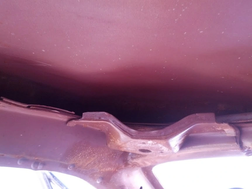

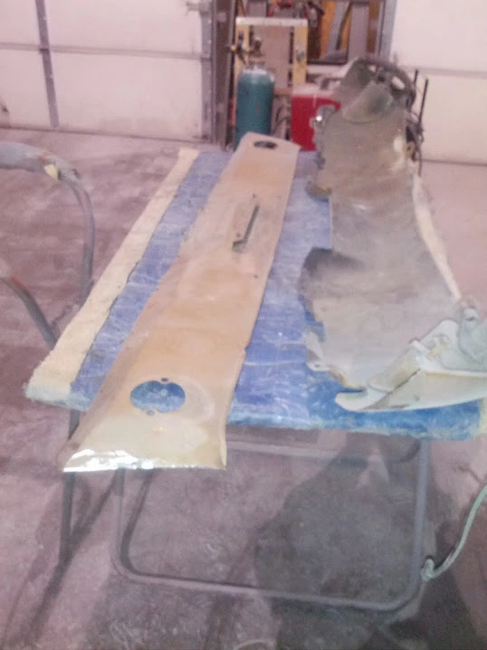

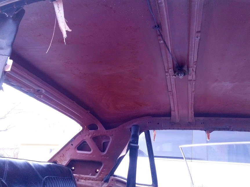

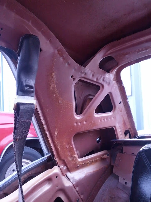

There was an insulation type material under the headliner rods, glued in spots. It came down easy, and practically fell apart when removing it. My upholstery guys said they had new stuff to put up there. I scraped off most of the glue and wiped the whole area with lacquer thinner.
The roof area above looked pretty good. Didn't see anything that caused me any type of alarm. Some surface pitting here and there, but that has had to been brewing for 50 years. Not gunna worry about it.
This was the absolutely worst spot.
The install went fairly easy. One thing about it- it's sticky. Don't let it touch anything unless you want it to stay there. As a result its pretty tough to put in tight places. Still, its not super difficult to install. We used a roller to make sure it had good contact.
In this spot I needed to keep the bottom open for the vinyl guys. You need it to access the outer trim. I'm not going for 100% coverage, just want to get a good portion of it.

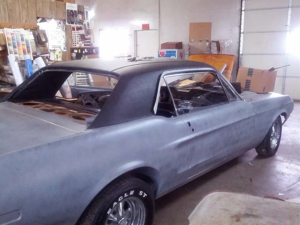

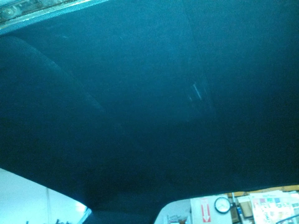

Big week! We got the headliner in (and by we, I mean my upholstery guys) and it looks absolutely great. Well, the picture doesn't look great, but trust me- it looks good.
They also got started on the vinyl top. It looks fantastic so far. He is still finishing it up, and I will pick it up Monday morning. Very pleased. These guys didn't use a kit for it, they created it from scratch and did the seam by hand.

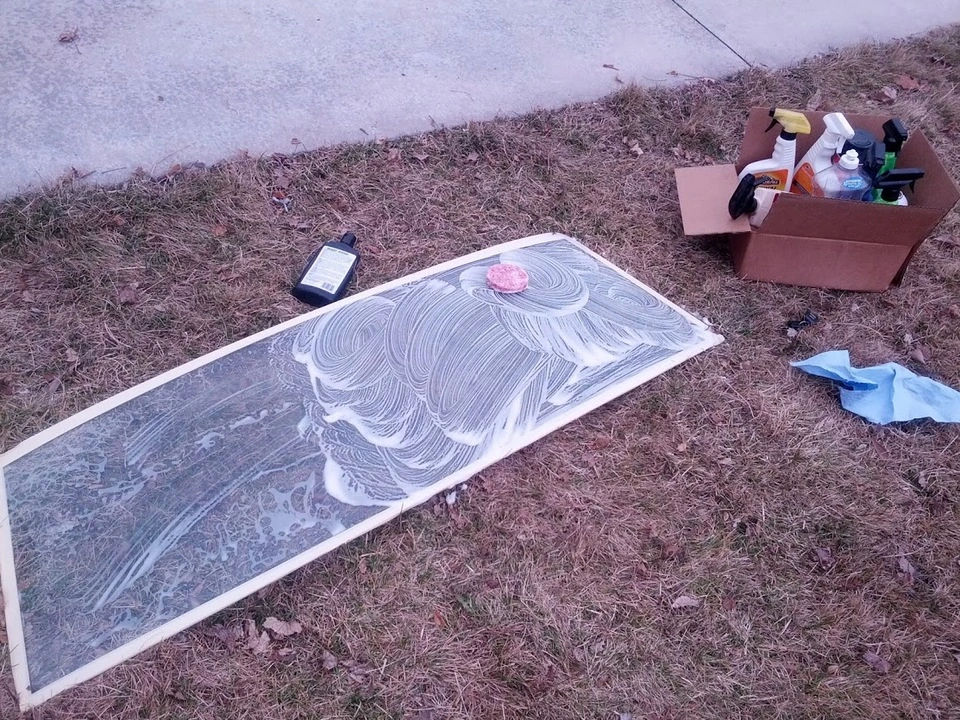

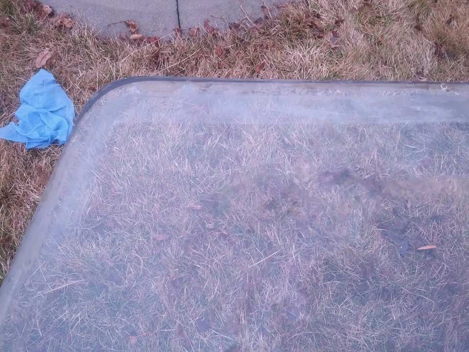

I was trying to decide if I should replace my glass or put it back in. I have had some stuff sitting on the shelf for years that I have never really used, so I thought I might as well give it a try.
Anyways, it worked really well. I am very happy with the results, and don't think I will replace the glass this time around. I used a softer scotch brite pad (red) along with this stuff and normal glass cleaner and just buffed it for a while. It worked great. I had a tape perimeter around it where it didn't get scrubbed on the first round. I did it twice. You can clearly see the line where I did it.

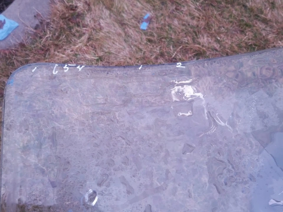

Something that was really interested were the written numbers. Not sure if this is factory glass or not. I know the rear one is.
Here it is, scrubbing the rear window on the ground. I spend 3 or so hours on both of them. Some of the work at this stage is not so glamorous.
Here is a picture of the glass installed back into the window frames. Its so clear you can't even see the glass!

It is looking good .
I have done several vinyl tops and keeping the two seams straight makes the whole top. The last one i did had a felt padding on the back ,my black 66GT.
It was a total nightmare with the felt but it sure looked good when it was done .I just wish i could find a pic .

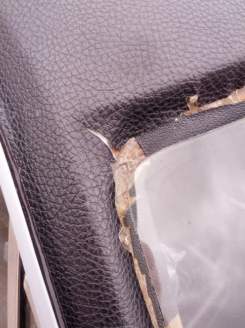

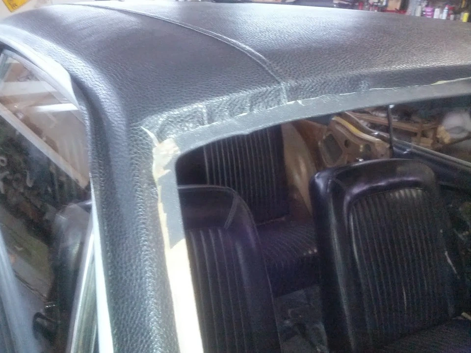

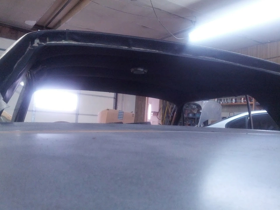

Well, back at it. After hauling it back to the painters a few things involving the vinyl top that need to be addressed.

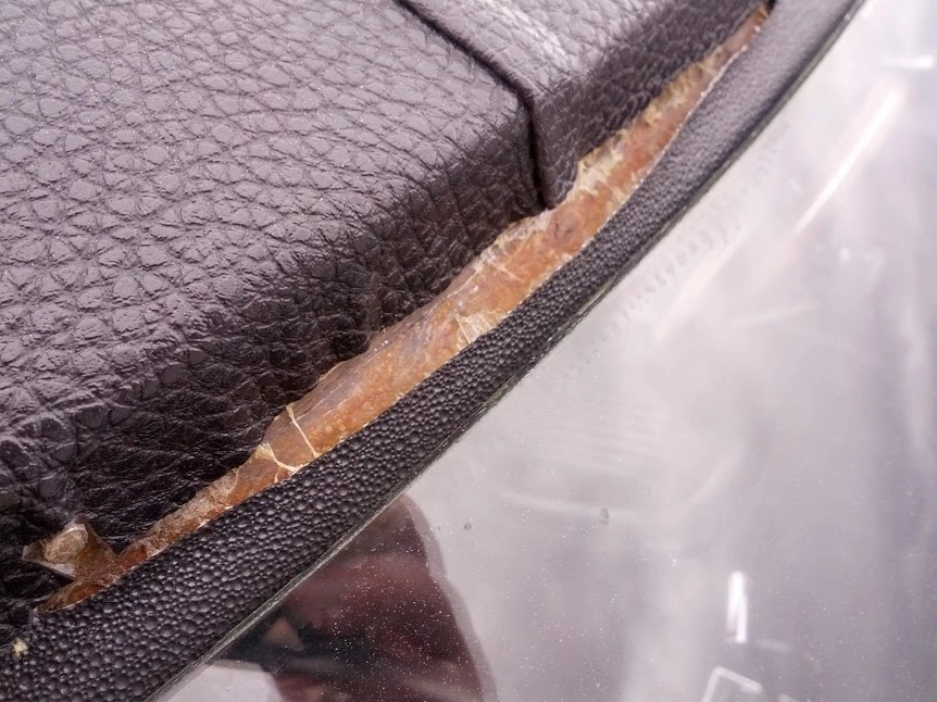

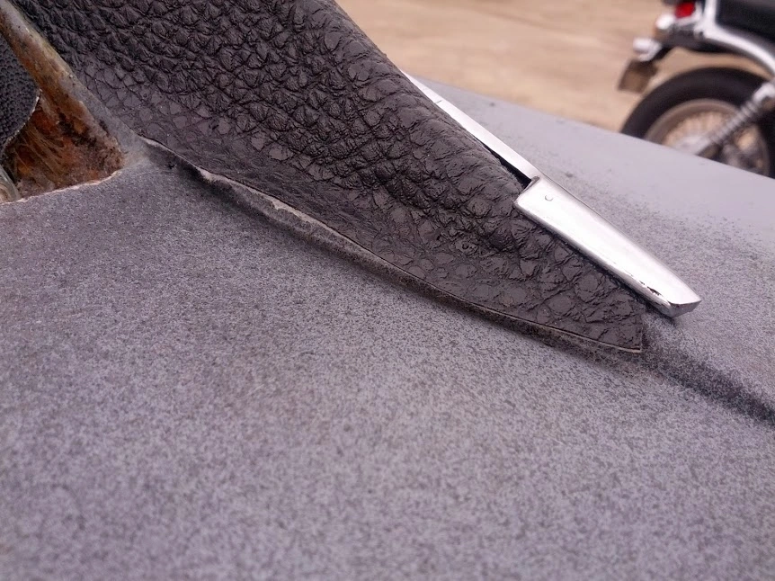

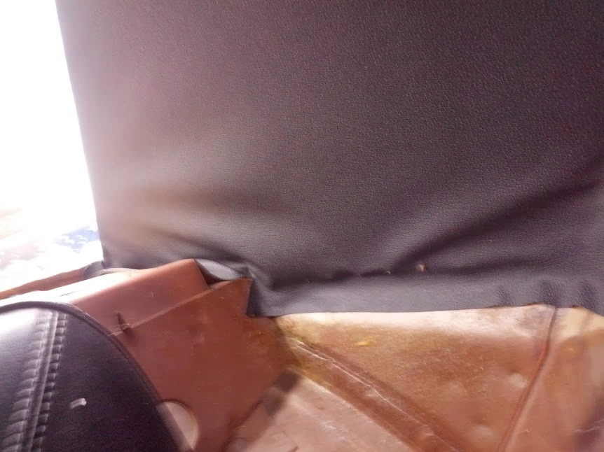

First, I'm concerned about this area. It could tear, it might not. Not sure. He said he will warranty it. I will ask him about it.
I know when the window goes it it will be held in place, but I still it seems like it shouldn't do this.

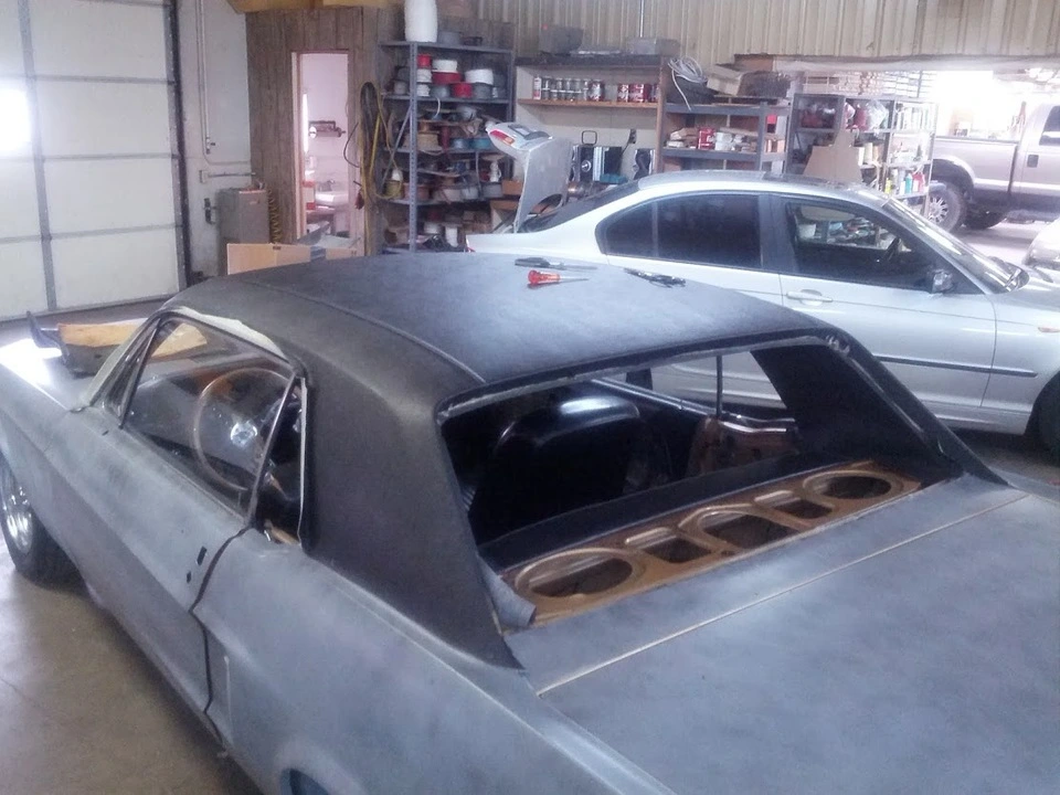

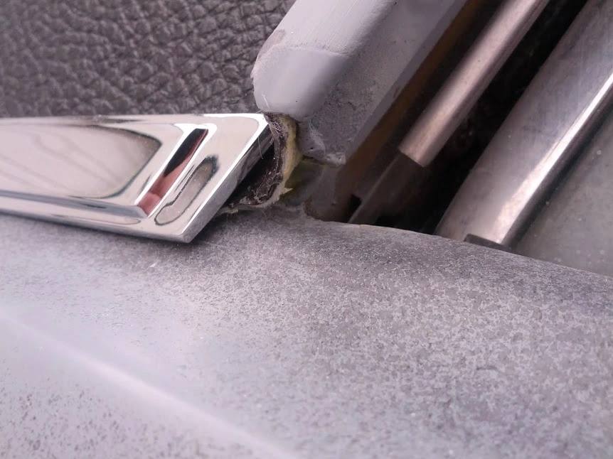

On both sides there is a piece between the rail and the moulding that is loose and flapping in the wind. Not sure exactly what it is supposed to look like (so if someone can post a detail pic that would be great)
Here is the other side. Note vinyl handing below the molding where it was not trimmed high enough.

Here you can see how the end is not completely glued down.
On this side the moulding piece sits too far forward.

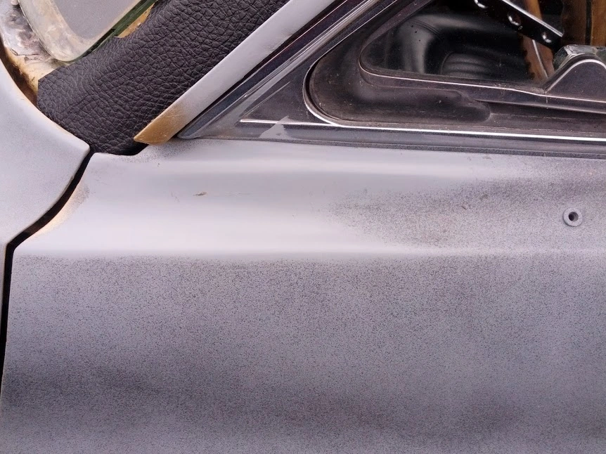

Here the guide coat is worn off. Not a huge deal, but I have to wonder why.
For the most part the headliner looks fine, but there is a wrinkle here.
Also glue on my fresh paint in the jams.
Anyways, after the initial excitement wore off and my body guys pointed this stuff out and I just wish I caught it before I hauled it off. I am going to go talk to them in the next few days and politely ask if they could fix these issues. I think they are all easily correctable.
One thing they did right was the seam lines. They are straight as an arrow, and the sewed it up themselves. It has that going for it. They also were very friendly and accommodating and let me work on stuff in their shop. I think they are good guys, but I did ask them to get me in and out as fast as possible. I imagine these issues are correctable. We will see.
The split in the top pic is a bit high but as long as it is well glued it should be fine .
where it is a little short in the front is also fine as long as it is well glued,the window and trim will keep it . The side molding trim with the small flap needs to be trimmed . The guide coat was probably wiped off with acetone cleaning off glue. the headliner needs to be re stretched at the bottom but no problem. check the back window area with your window molding ,it may need a slight trimming .The glue on the jamb may be a bit tough to clean ,do not wipe it with acetone or any solvent it will remove the paint .Try something like finessit polishing compound and work it in some times that will take off the glue. none of it should be to big a deal. Looks nice .
