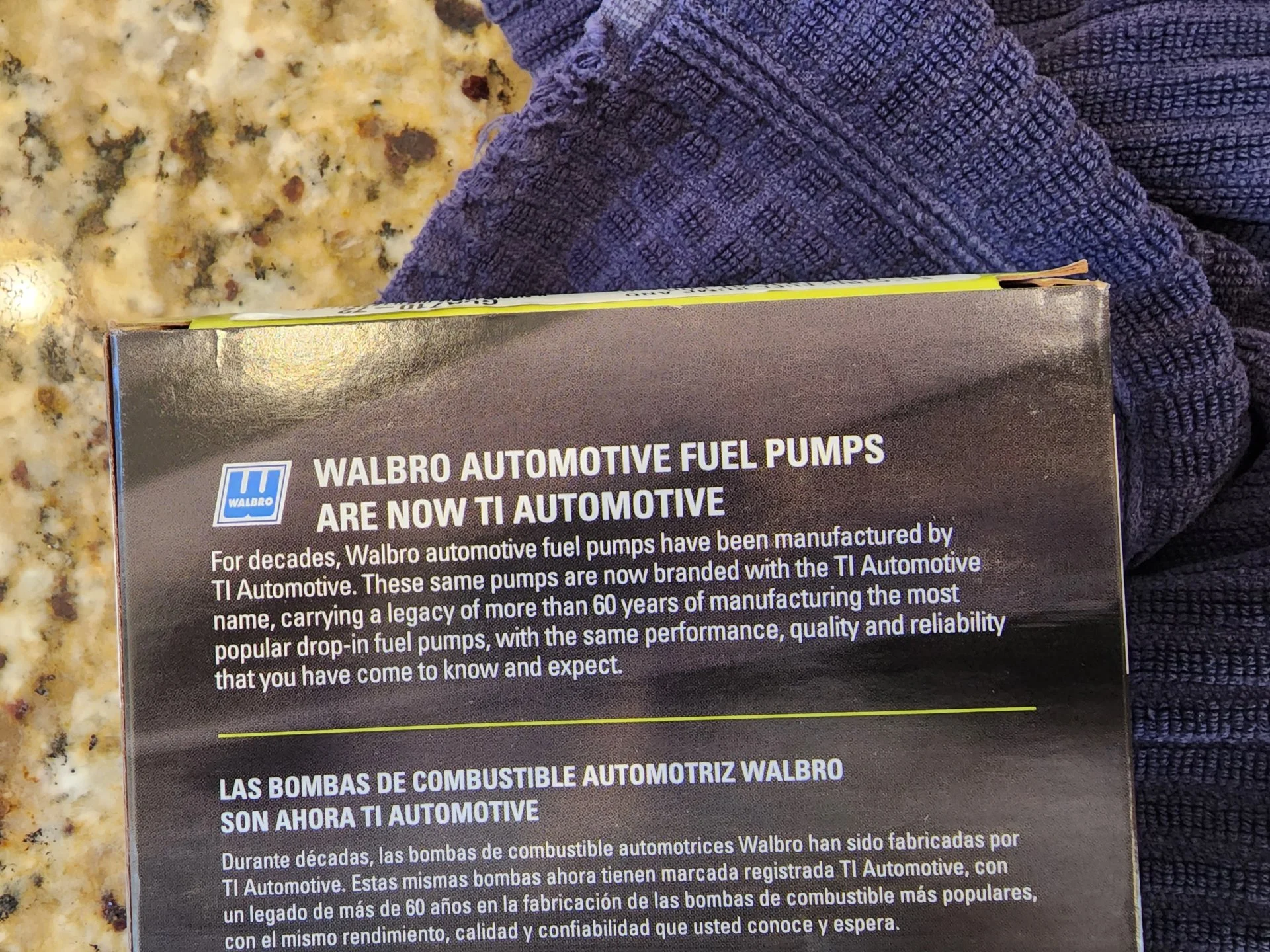

I would throw a new pump in it, there cheap enough, the corning thing to me sounds like a busted fuel baffle in the tank, had many cars do it over the years, mostly ends in a stumble / lean pop when the tank is low.... Maybe slap the tank and see if you can head it move around

Could also be just the rubber line that connects the discharge of the fuel pump to the pump hanger. Have seen these rot and split in the tank and just needed to be replaced. I will say that if you are in there there is no time like the present to swap pumps.
