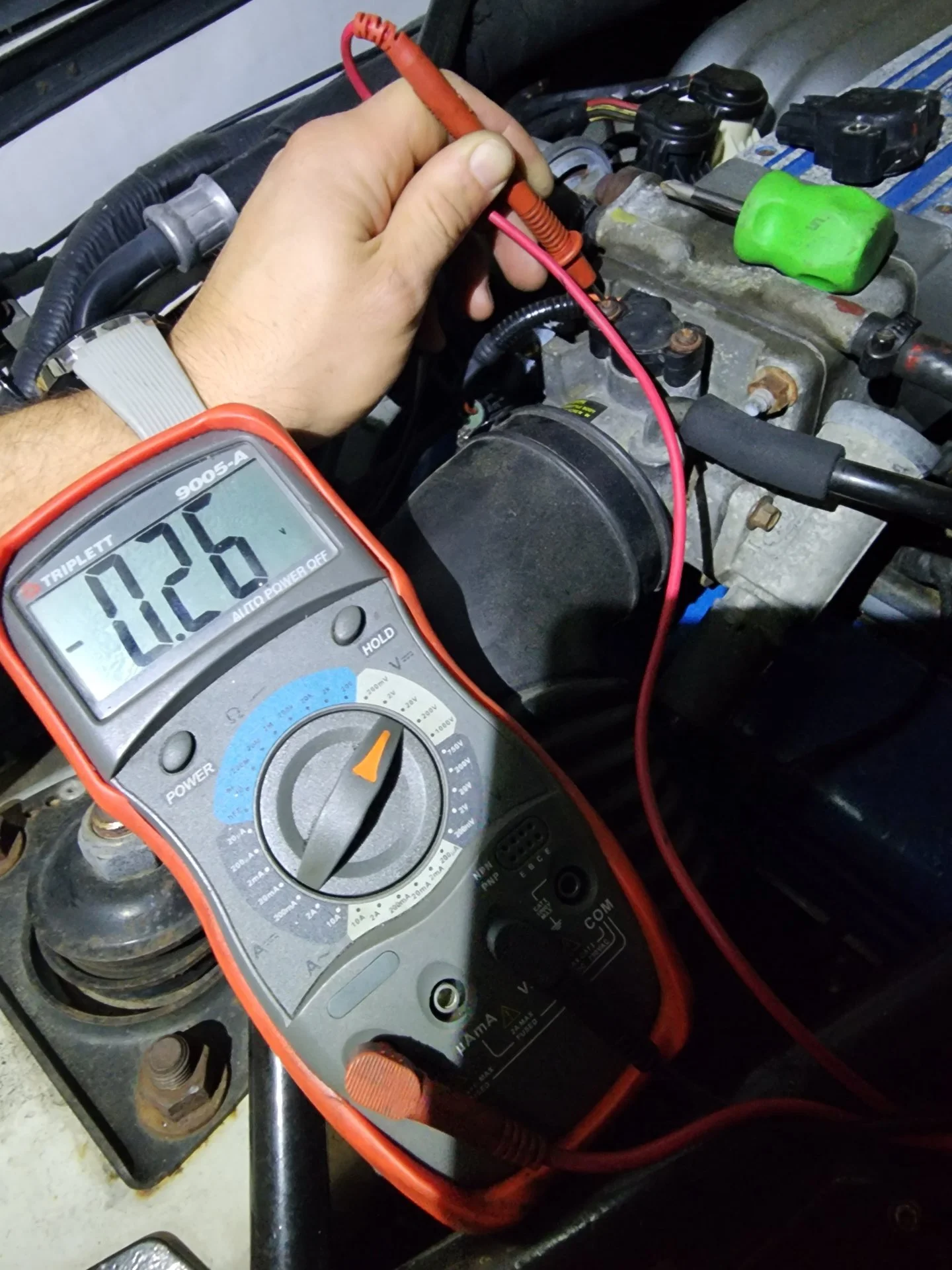

Update: shot of ether does nothing. Throttle blade wide open.
Tps voltage throttle closed: .25/.30 ish (explains the tps voltage low code since spec is around .74 to 1volt closed position. TPS will not adjust to in specifications.
I'll have to order a TPS however to my understanding TPS voltage to low won't cause a no run condition.
TPS voltage wide open was around 3v and change. This tps voltage would explain a rough or non existing Idle. However should still run with throttle pedaling. Additionally a low tps voltage does not kill injector pulse..
