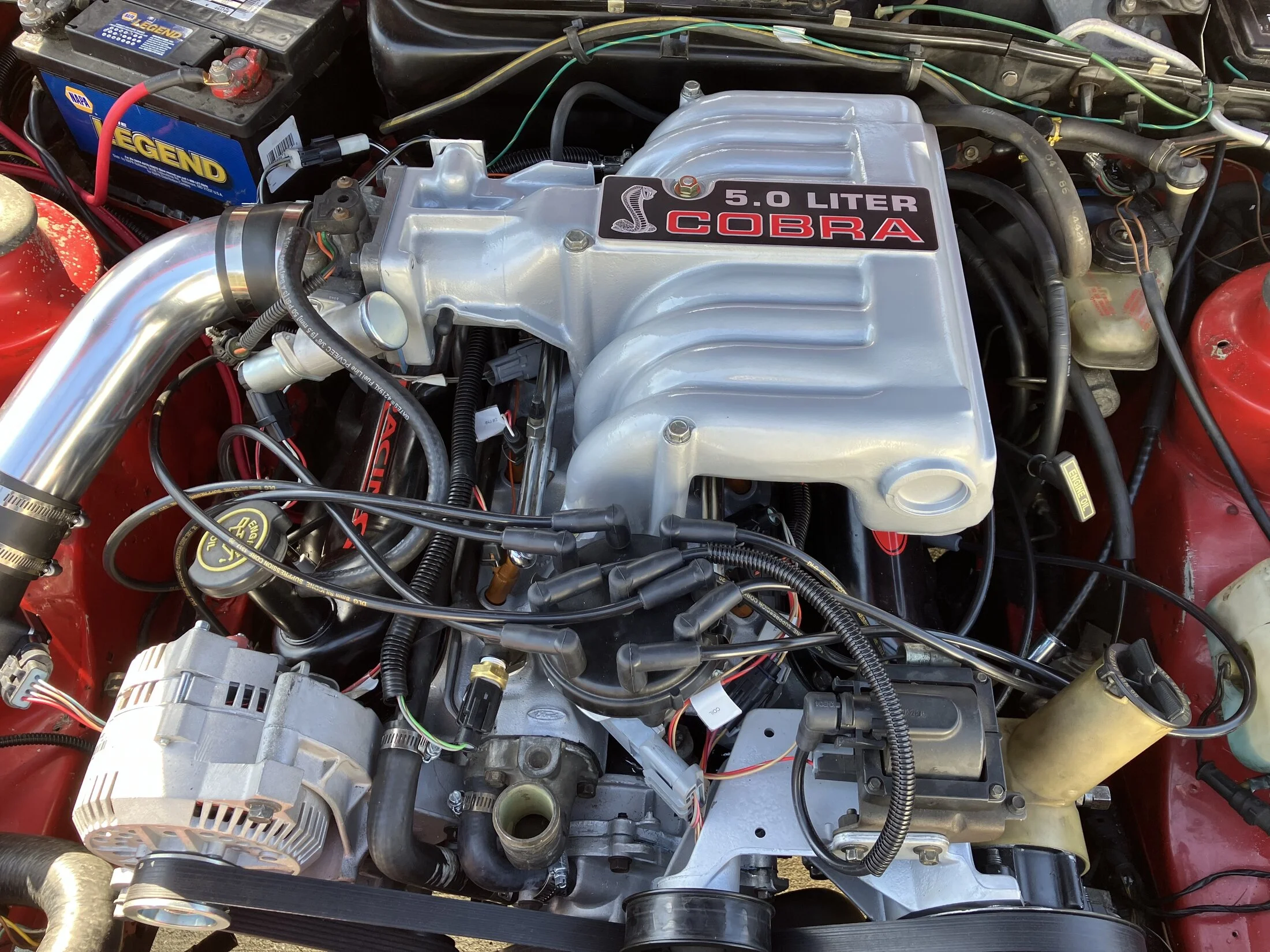

The wiring looks a bit of a mess here but, this is what I’m working on.

Nice shoehorn job
What processor is in the XR4TI
What wiring harness?

Your XR4TI's processor wiring harness is going to be different than the cobra processor harness
You are going to need to re wire the 60 pin connector?

He swapped it in the a Painkess harness.

It’s an A9L from an 89-93 Foxbody. The harness is an aftermarket one from Painless. It looks like it belongs there, doesn’t it?
