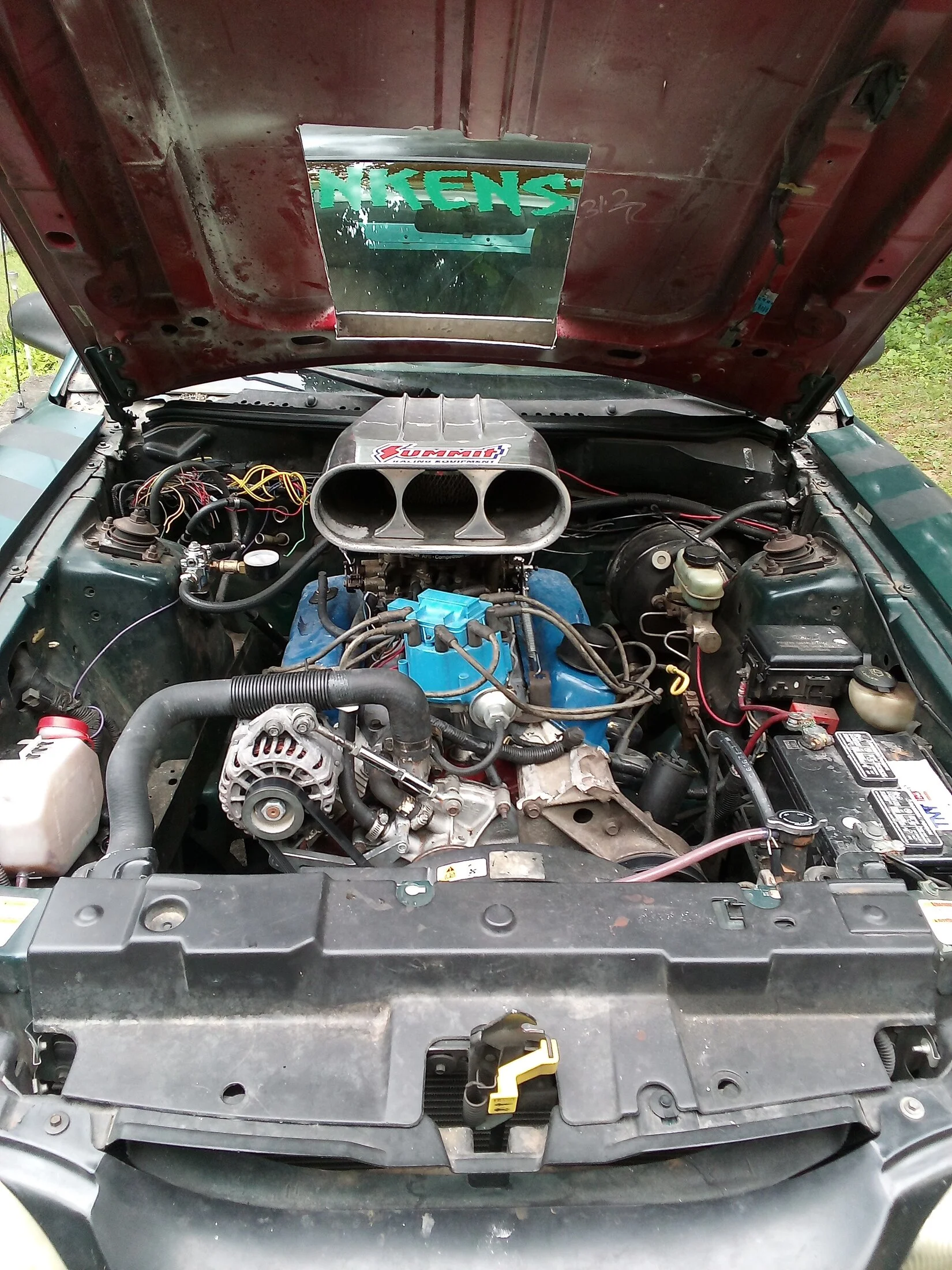

Finally got the 5.0 swap up and running. Sort of. It will start and run but I need to "work" the throttle to get it to stay running. Pulled the codes, first one out of the box is #22. BAP out of range. (The others are clutch switch and some EGR codes.) The BAP that was the one in the car from before. (E6EF-12A644-A1A) I have since purchased a proper E7EF-12A644-A1A sensor and still get the same 22 code. Even after having the battery disconnected for several hours. Do I still not have the correct calibration BAP? (It calls for a E7EF-12A644-A2A sensor. It looks like they do interchange but I'm still getting the code.)

This build took some work including swapping out the subframe. As you know a '97 never came with a 5.0L.
If I was you I would check for power at different places. Does your fuel pump come on? How much fuel pressure do you have? Are you getting power at distributor? You have all your grounds hooked up? Many sensors us a common ground.

The engine has never really run at all. The swap was done in February and I’ve been trying to start it ever since. Back in the first post, I needed to work the gas pedal to keep it running. It has never idled or really even run for more than 5 seconds.
No one is grasping at straws. I have systematically eliminated nearly every issue that could cause it to not run. There are references to several different checklists that I’ve gone though.

This is a transplanted 5.0 in a European version of the Taurus SHO with an aftermarket harness so something is off. This thing should start or at least pop and wheeze.
