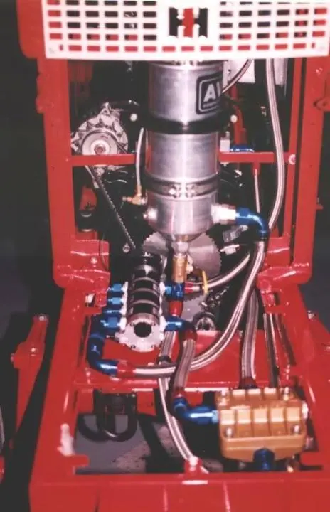

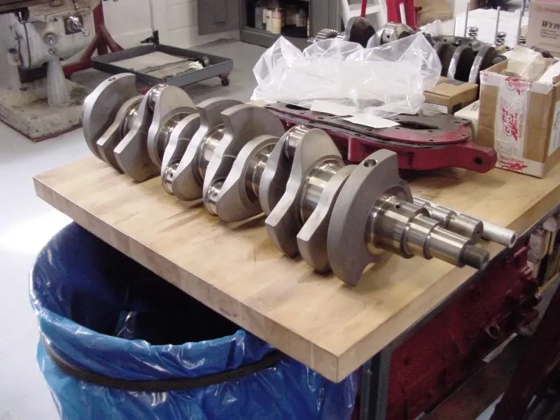

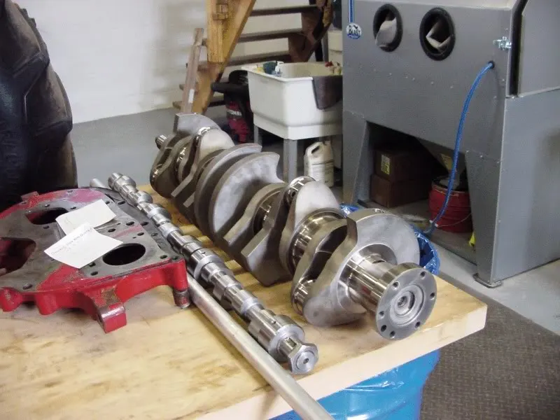

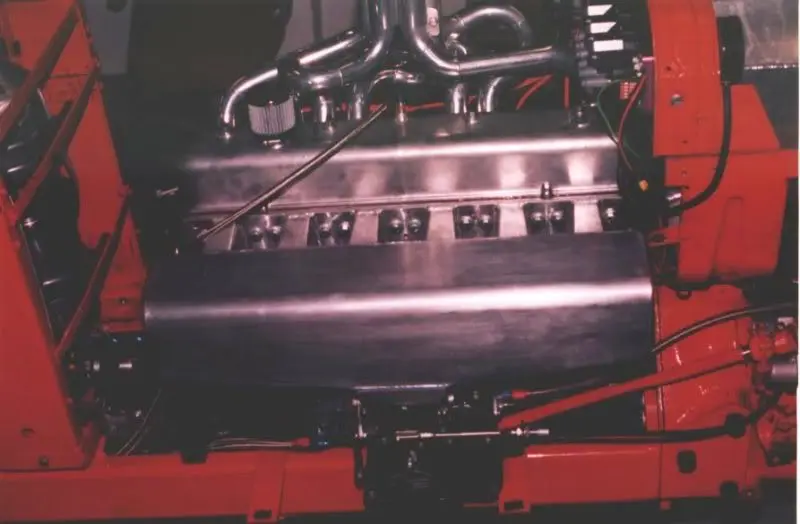

I would question on why the journals are chromed? Were the journals turned to small or ate up and to bring them back they were chromed? I hope who ever did the chrome knew what they were doing, cause if it starts pealing that will spin a rod or main in a hurry. Billet cranks are usually 8620 material and go thru surface heat treat process which I think is called nitrate. There is no real reason that I am aware of why you would need chroming as the journals after heat treat will be plenty strong. My thought would be the crank is under such stress that the flexing would cause the chrome to peal. The forging vs billet has to do with grain structure. In my case I could not afford the forging dyes to do a one off tractor I6 crank (previous hobby, tractor pulling). This is the reason I found a guy around the metro Detroit area to build a 36" long 5.375" with stroke 2.0" dia. billet crank. It is still running today turning 6,800rpms.
Scott

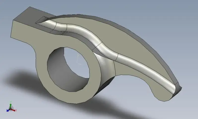

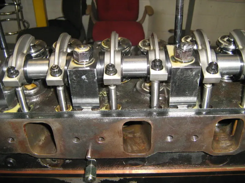

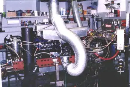

Yes it is different, we run against 2.5" turbo tractors in one association. I designed the connecting rods and rocker arms. When we first built it we ran it in a dyno cell to try and tune it with a leaking head gasket and a poor fuel system the best it did was 505hp and 537ft lbs. We have come a long ways since and estimate over 600hp and 650ft lbs at 430 cid I6 with only a 300cfm cylinder head. We try to pack more in with a .860" + lift cam and lot of duration. The problem is cant drive it on the street:rlaugh: and not a big enough following to sell your hand me down parts and make a name for yourself:(. Let along the non standard rules from association to association:nonono:.
Scott
