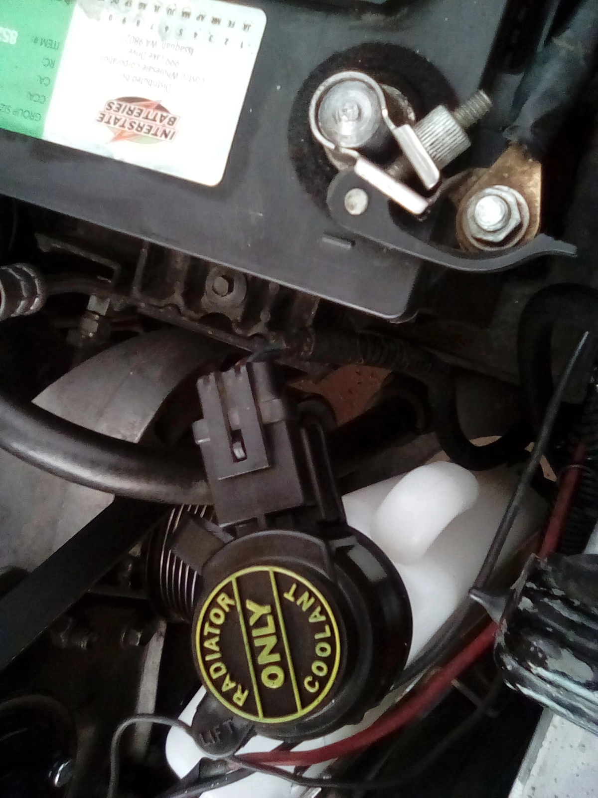

Got a new low coolant sensor/cap and it doesn't work, light on dash stays on.
Yes the two prong end is sitting in coolant.
Is it a scrappy new part or something else?
The part # fozz -10968 is a Daniel carpenter part, for a 90/93.

The 90-93 cars do not use a fluid module.
Light blue wire is output wire to the cluster to trigger the light.
Red/yellow is 12v feed from fuse 18
Black goes to ground.
The two prongs on the end of the sensor relief on the conductivity of the coolant mix to make the connection. If the sensor was dry, no condition was made and the light would trigger on. If you manually touch the two prongs with a metal wire and the light does it go off, it’s a bad sensor

Thanks Mike, I checked red/yellow wire for power, it was good. Checked ground( black wire) ,it was good, so the brand new sensor was crap.
Got new replacement sensor installed today and all is good again.
