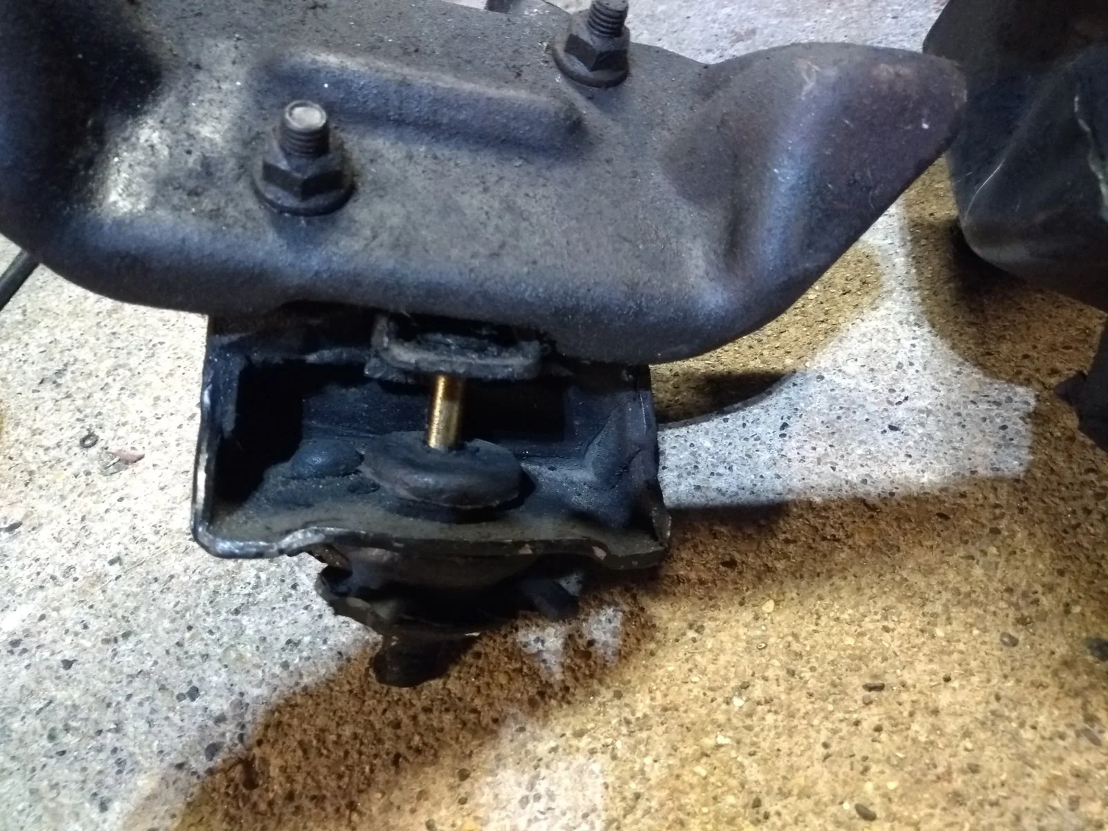

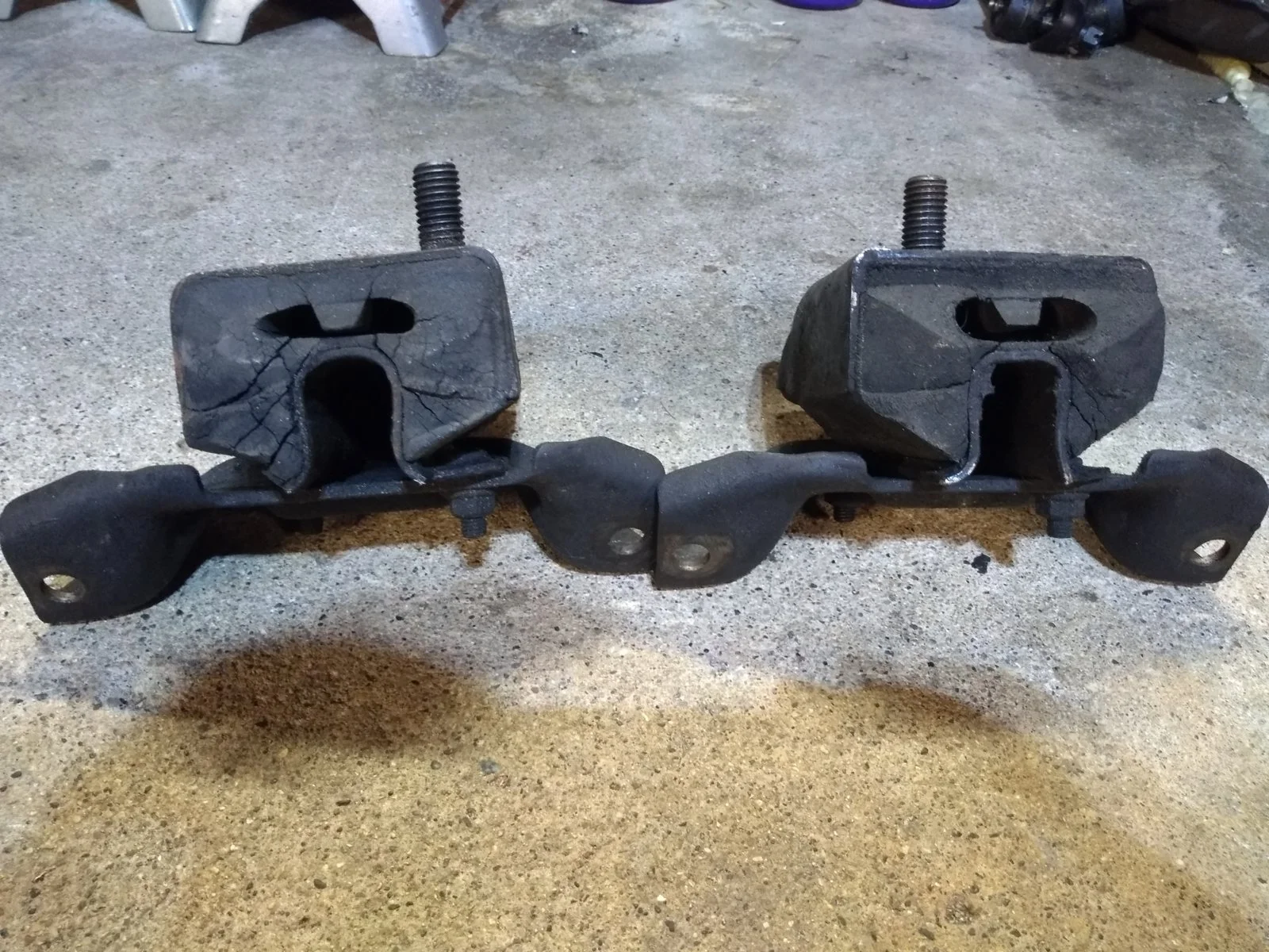

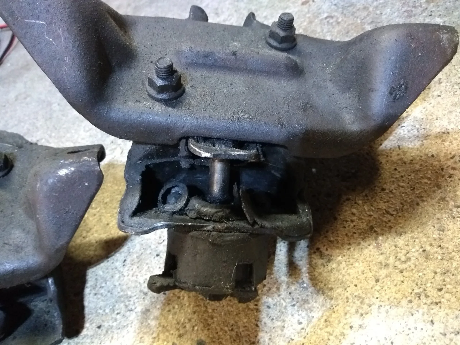

Maybe I really need to get the tune checked out. I also thought the vibration could be something clutch related or maybe the tailshaft bushing. I can move the yoke up and down a little.
Pictures of old ones.
