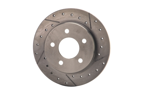

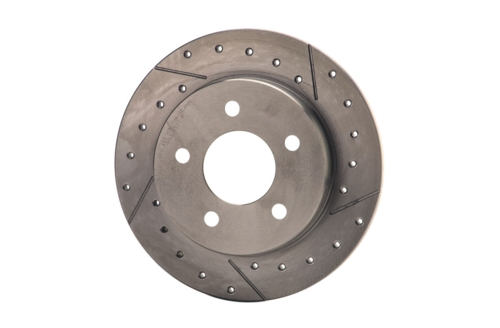

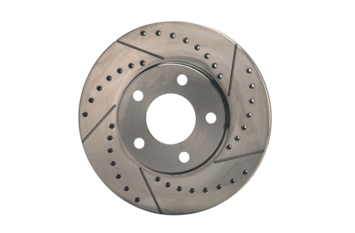

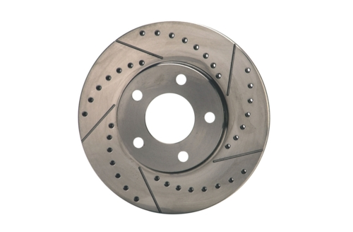

FRPP offers some for 99-04 Mustangs
Front M-1125-A:
Rear M-2026-A:

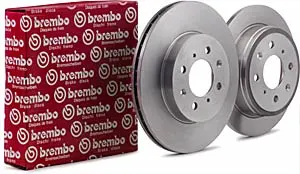

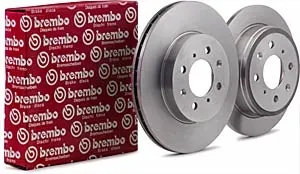

My GT is due for a brake job and I plan on replacing my rotors with plain Brembo rotors and Hawk HPS pads. I may paint the calipers while I am at it and replace the front lines with braided stainless lines. The www.tirerack.com has some pretty good deals on all of it.
http://www.tirerack.com/brakes/brak...e=Hawk&model=HPS+Street+brake+pads&perfCode=S
http://www.tirerack.com/brakes/brak...ake=Brembo&model=Replacement+Rotor&perfCode=P

I think the rotors I posted from FRPP are safe they are probably cast. I would not use eBay drilled rotors myself. Also, as was said, these fancy rotors are for looks only pretty much. If you are looking for max braking and durability then the ones like rjstaff posted are the way to go.
