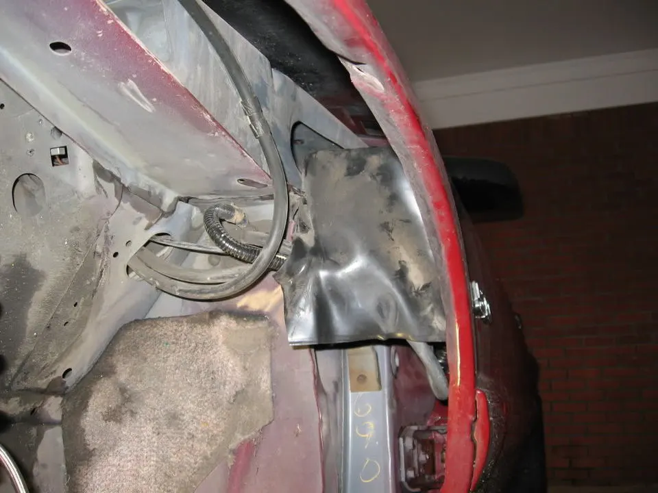

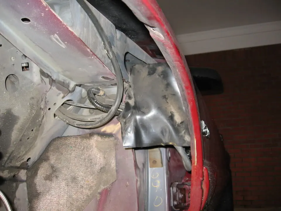

This is where the module is located.

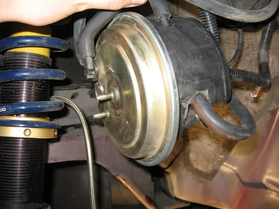

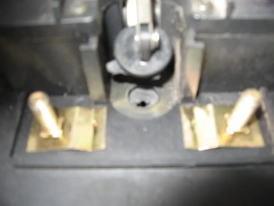

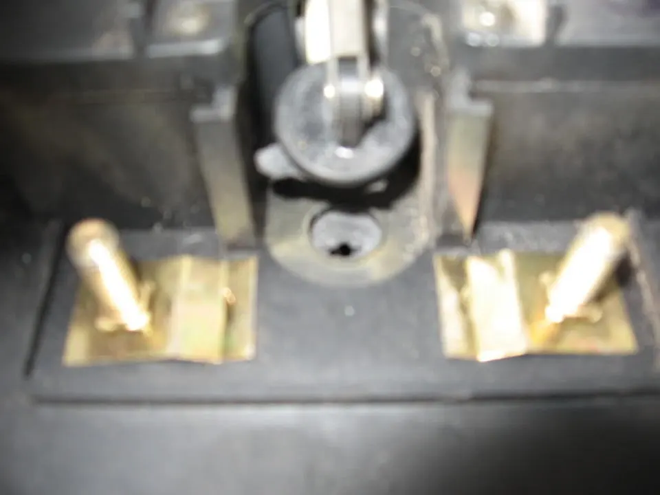

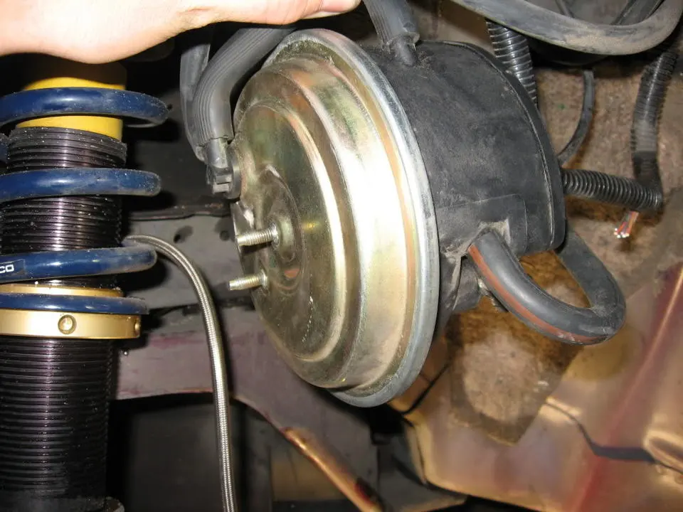

Here's the module. Basically a big vacuum plunger.
This is what broke. The plunger draws in using engine vacuum and pulls the cruise cable with it.
